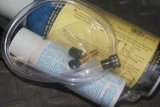

I went to the local Toyota dealer and asked about the BG Frigi-Clean... well the parts representative said that they stopped using BG products... and gave me an AC kit which comes with an Evaporator cleaner and refresher from "PETRO Checmical A/C Power Foam". This is what they use on Toyotas for A/C service according to the parts rep.
Anyways, total cost is $18.95 for the entire kit. Also, there is no hole to drill. Simply snugly fit the wedge adapter at the end of the dispensing apparatus into the evaporator drain tube and dispense it. 10-15 mins later, foam will liquify and drain out. Then follow with "ConditionAire 2005 Refresher" into the fresh air intake with blower on high...
Whole process took me 20-25 mins... and best of all, SMELLS GONE!

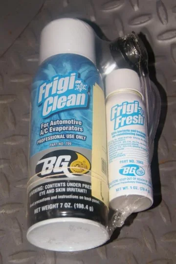

A/C Evaporator is clean! Finally found the BG products A/C kit at Advanced Auto. $36.25 plus tax.
Did mine over the weekend also. HUGE DIFFERENCE !! :clap:
Use to have this crazy dog butt smell..... and thank mud I found this thread.
Doesn't smell at all anymore. And since I had more then half a can of the stuff you spray in the outside vents, I sprayed my babies mamas car w/ it, and a few friends rides also.
Good Stuff and definitely works .... I had a almost like oil fluid coming out ... I'll be doing another right before winter hits.
no more musty smell!
finally found frigi-clean at Buy Frigi-Clean® and Frigi-Fresh® | BG Frigi-Clean® and Frigi-Fresh® AC products | Frigi-Clean® and Frigi-Fresh® . it seems to be the only online place you can get it. Dealership would not sell it to me...they wanted to charge me for the cleaner and service. Whatever...
Ordered mine from this site as well. It took about a week to get it (I'm in MO) Just did the treatment to my a/c and so far so good. Fresh smell and no more musty smell when i turn on the fan. :clap:
