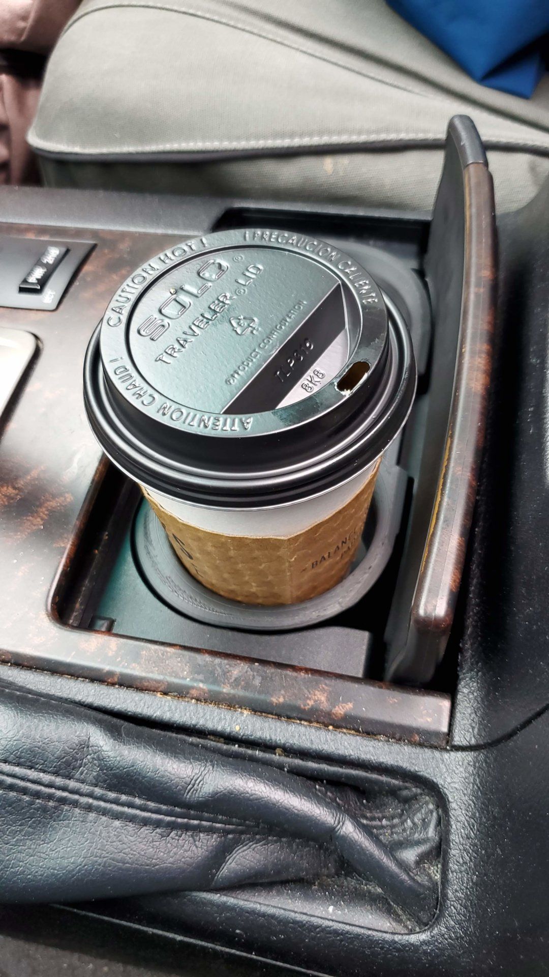

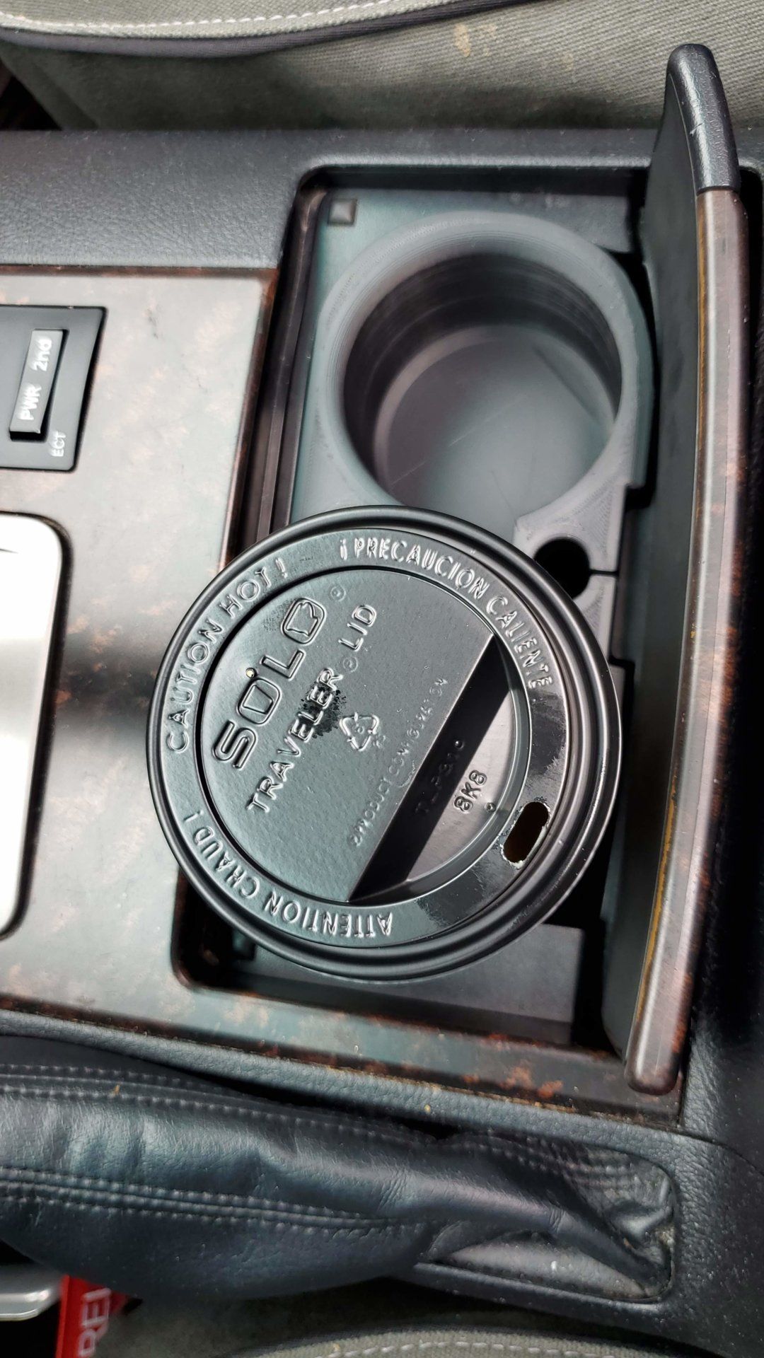

My primary use is for coffee mugs. I noticed that the Yeti Rambler I normally use will no longer fit in the new cupholders. Regular cups from your local coffee shop, however, fit even better - no more wobbles or tippy cups! (posting a couple of picks of the cupholder in action) . So, I'm in the market for a new go-to coffee mug which is a small sacrifice to the over benefits this solution offers.
And, while not wanting to derail the thread entirely, I will ask for others to post up photos (and details about) water bottles, coffee mugs, 7/11 slurpee cups ;) or other - ahem - beverage options that you have found to be enhanced with the new 3d cupholder inserts? Post 'em up!
Another action shot for perspective, fit, and tips for the center hole ;)

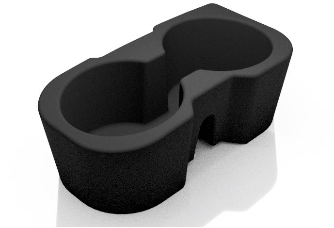

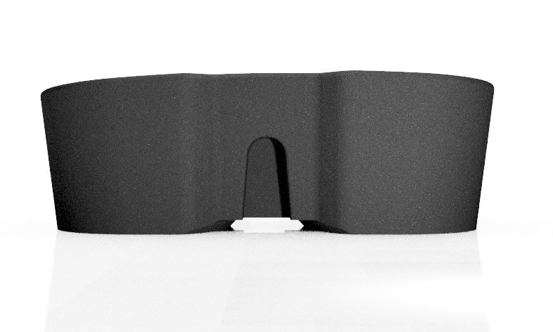

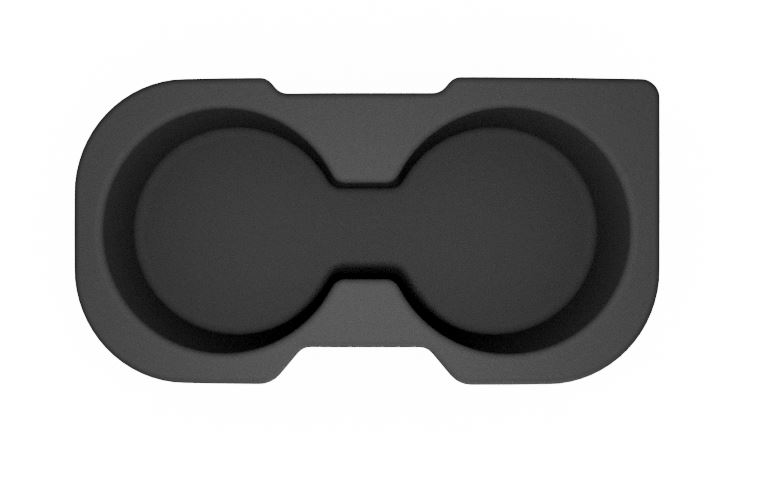

Spent some time yesterday and today on the LX570 insert. Ran into some issues I did not have to deal with on the Landcruiser insert. The LX570 holes are 5% larger in diameter and 20% more shallow. The shallow wide holes of the Cruiser cup holders are even worse on the LX570. I will not be able to have the insert sit flush with the top of the OEM hole. They will be too shallow. I have to run the insert up flush with the bottom of the lid which is about 1/2" above the OEM cup holder top plate. That also means the top will not be flat but will match the slight curvature of the lid. That layout is creating quite a few challenges in fitment. I am also thinking of going with a single piece design on this one to help with stability due to the shallowness I am dealing with. Here is version 1.0 in CAD. It's printing now and will be test fit tomorrow.

those seem like reasonable assumptions and mirror my experience with this cup holder. It is particularly bad.

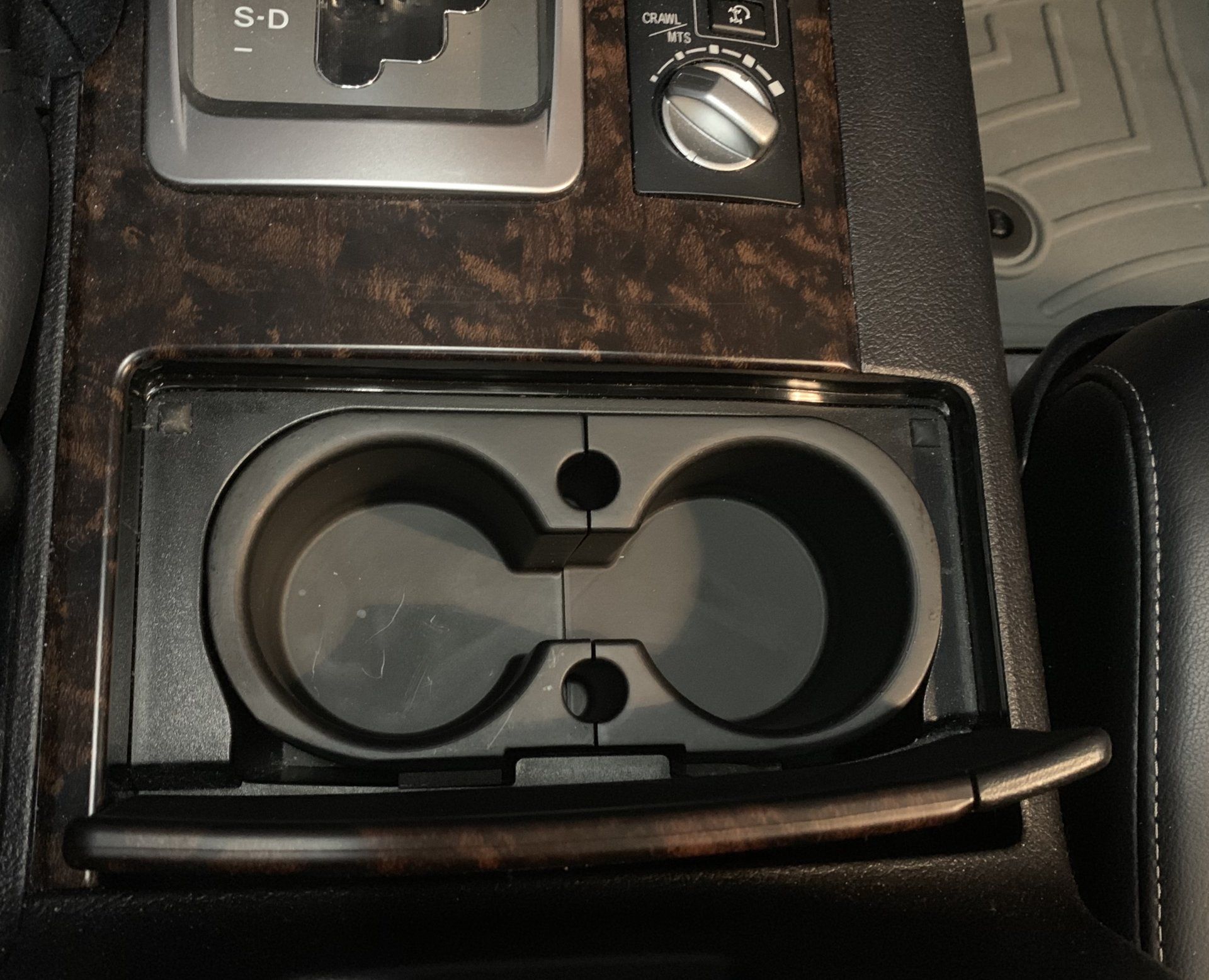

Version 1.0 for the LX570 just came off the printer. Overall fitment is really good BUT one of the angles I cut into the design had a taper to it and I didn't catch it so the cup holder gets wedged into place about 1/4" before it hits bottom. I just made the taper change in CAD and version 2.0 is starting up right now. Once I get it fitted correctly, I will post some pics.

Version 2.0 seats all the way down into the bottom and is nice and snug. Fitment is perfect but I now have a new issue. I can close the lid but it doesn't latch. In order for the lid to actually latch when you close it you have to go about 1/4" beyond the closed position so that it gets caught as it tries to go back up. My cup holder right now makes contact right as the lid is at the closed position BUT the lid can't go beyond that point to latch. I need to get another 1/4" of depth out of this. It's getting super complicated to make this work with the space I have and keep the cup holders fully functional. I will keep you guys updated. Version 3.0 is printing now. Hopefully this one will allow for the lid to latch AND keep cups nice and stable.
