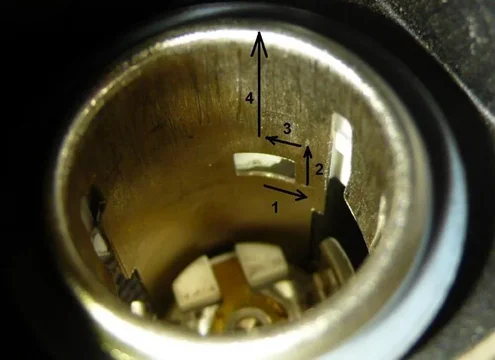

Here's what keeps the metal socket in place.
See how the plastic tab is engaged in the socket:
You release the tab by rotating the socket a few degrees either way:
And this is the sequence for fully removing the socket:
1) Turn it a few degrees. 2) Pull it out a little. 3) Turn it back. 4) Pull it all the way out.
It's that easy!
Those lighter sockets are a real pain! Thanks for sharing some knowledge on the correct way to assemble/disassemble them. All Toyotas are the same as far as the cig lighter Assy. Well the ones I have seen.
1) Turn it a few degrees. 2) Pull it out a little. 3) Turn it back. 4) Pull it out.
It's that easy!
Great pics, especially the one that shows how to twist and pull to remove!
It's that easy!
I know I would have broken this, if you hadn't taken the time and done such an excellent job. Thanks!
It's that easy!
IN-EFFFING-CREDIBLE.....Been looking for a non-destructive solution for months.....THANKS...
It's that easy!
Thanks for your post - very much appreciated.
I did NOT find it easy to get out at all! lol Maybe I was missing something.
I tried a few different methods including pushing the white tab up with a screwdriver but in the end used some long nose pliers to grip the edge of the metal rim of the lighter socket (being careful to avoid damaging the plastic light transmitter around it) and tried to twist it in the recommended direction while pushing at the white plastic tab with a screwdriver but eventually, out of exasperation and determination, I just pulled and wriggled it vigorously with the long nose pliers until it came out suddenly (fortunately I had disconnected the light bulb fitting and main lead beforehand otherwise it might have ripped out and damaged the light bulb wiring).
