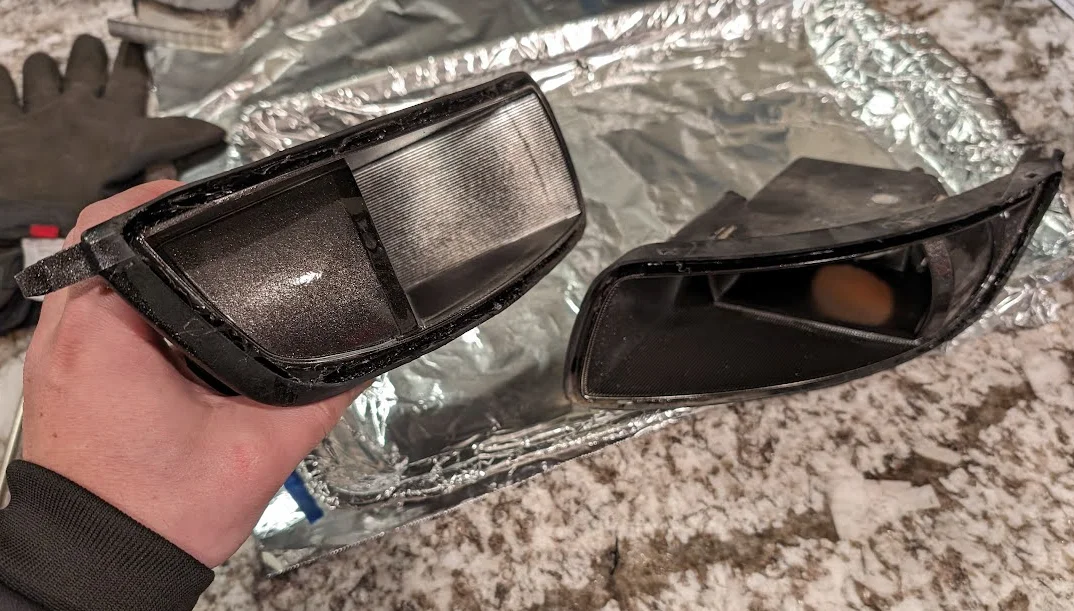

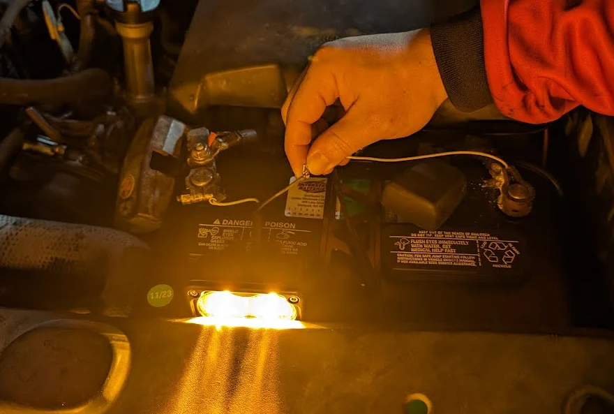

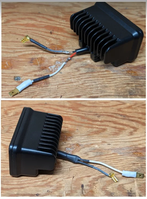

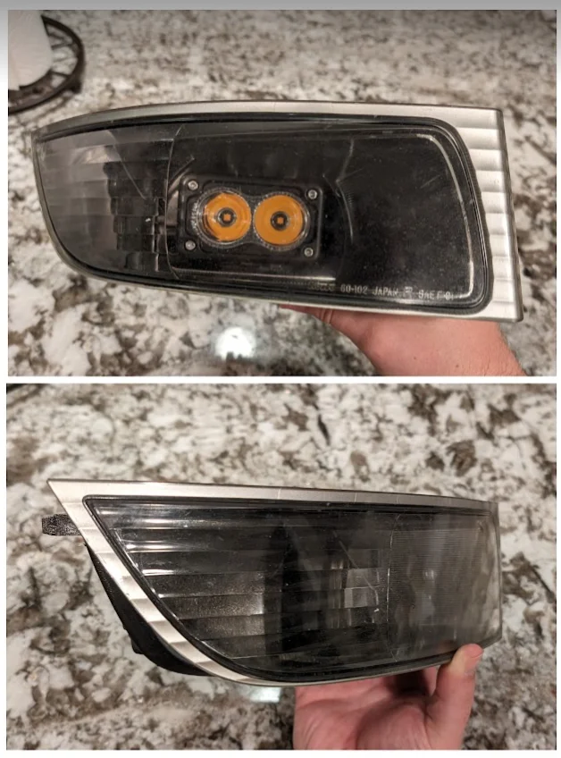

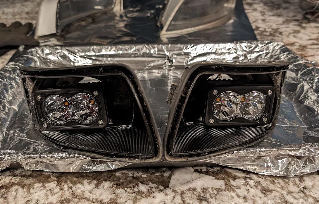

painted the internal housings a metallic dark grey/black, then threw some UV clear coat over it.
Canabalized the OEM bulbs that came with these housings and soldered the ends to the LED pod wires.
Always test before putting everything back forever!
Pods in the housings. I angled them out away from the car slightly, and slightly down towards the ground.
Now just waiting for the final nugget nap of the day to heat the oven and throw em back in to close them up!

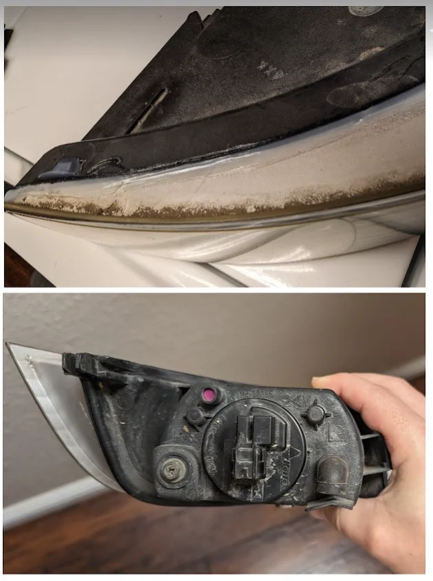

Damn that sucks! I got USR ones 2 months ago.. we'll see how they go..
Damn that sucks! I got USR ones 2 months ago.. we'll see how they go...
The first set started cracking and foggy inside within a couple weeks. After fighting with them and having to pay a deposit I got them to send me another set. That set got cloudy and started peeling on the outside within 3 months. Ignore there website reviews and take a look at the google reviews. I jumped the gun because I thought they looked awesome. Live and learn!
Everything buttoned up last night
Put a seam of clear silicone around the perimeter as a just in case. Rear cap on and ready for OEM plug in :)
I could throw them in now, but I kinda want to go out tonight and do a stock vs modded pic to really see the difference... might try to be patient for that.

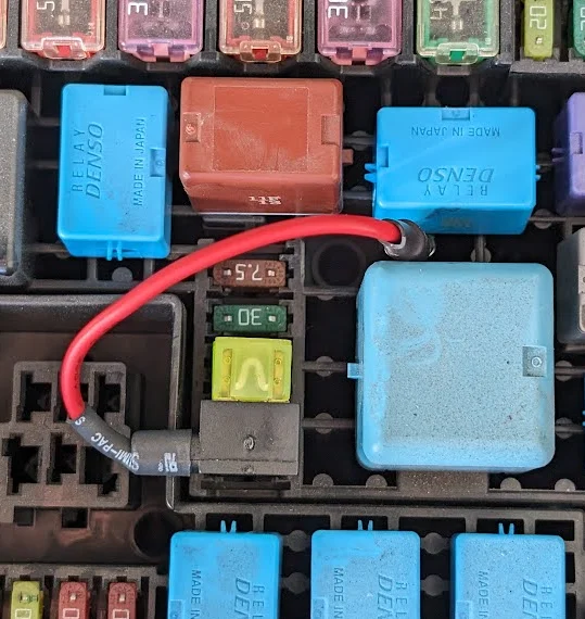

Also might do the "always on" fog light mod, where you can bypass the relay and are able to turn the fogs on without the headlights being on.
I’ve had mine for about a year, and no issues. They’re absolutely not oem quality. I don’t expect 100K miles from them.

Fog light mod to allow fogs on with headlights off

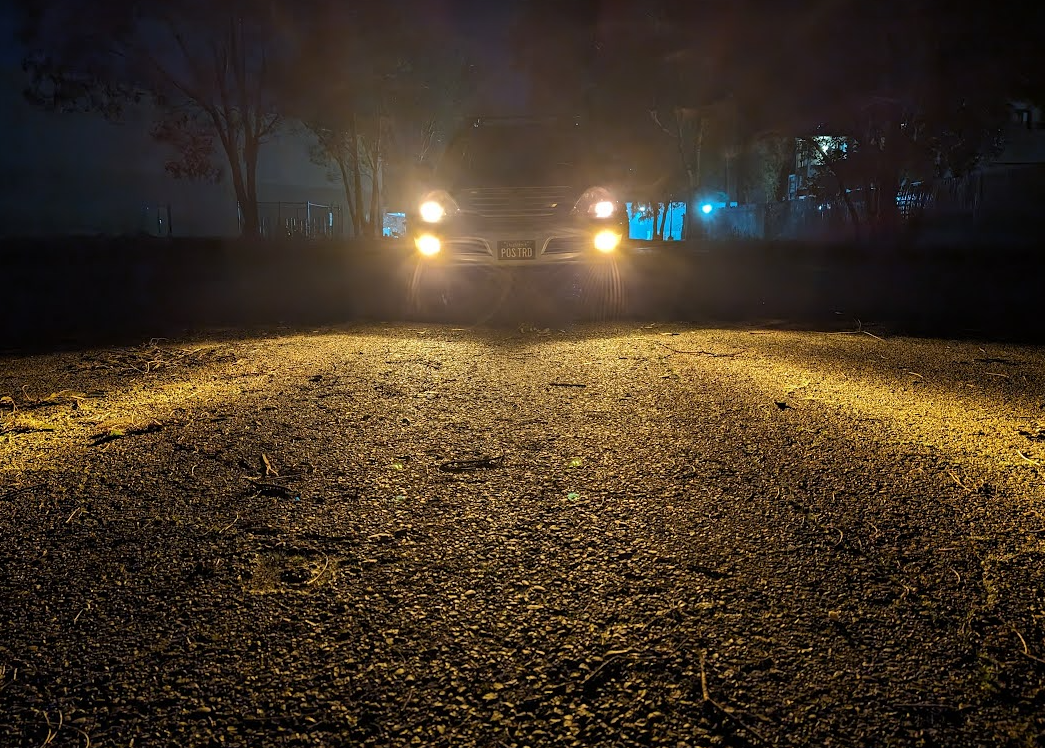

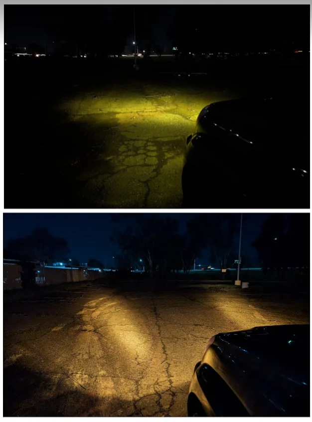

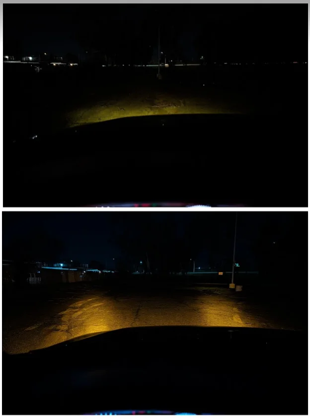

Went out to a dark empty lot last night and did a before/after.
Top pics are stock fogs with yellow LEDs vs bottom are modded housings - both sets of pics are only DLRs and fogs
DRLs and fogs
Think it all came out pretty decent. For sure a lot more light. I might change the angle of them more towards the center vs shooting outwards.
For $~36 LED pods and $40 using fog housings.. worth it IMO.

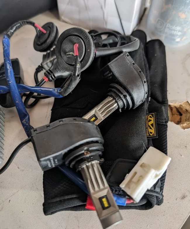

Neighbor down a few houses from me has a modded 4rnr and Tundra. Just swapped aftermarket headlights into the 4rnr and asked if the bulbs fit the GX. They do. He had a pair of Diode Dynamics SL1s in the OEM headlights, and gave them to me for free since he no longer needed them :)
Think ill wait to install them.. I would like the get a set of OEM Sport headlights when they go on a good sale next time. My OEM originals are looking tired and have some cracks in them.
Let me know how well these work - I'm running cheap Auxito or Auxbeam LEDs (don't even remember which). They are better than the halogens, but I've had one crap out and the beam pattern is so-so at best. Diode Dynamics is local to me and of course USA-made. I may replace the cheapo bulbs with those if they are wroth the $100 a pop.
Yeah they are pricey.. They have gone up in price since he bought them too. He loved them in the 4rnr and I believe he has them in the Tundra too.
Will post an update when I get around installing them (be it in the current headlights or new ones).

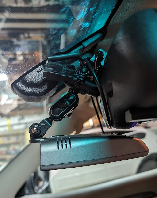

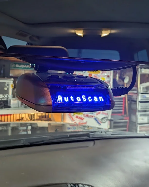

Always finding some interesting things on the GXOR FB group. Ordered one of these, and it arrived last night.
basically unplug OEM wiring to the rearview mirror, plug this into the mirror, OEM wiring into this, then it adds USB power. Meant for dash cams, but I ordered another cable: https://www.amazon.com/dp/B0C9TKJ846?tag=ihco-20 (RJ11 to USB) to see if I can use it to power the radar detector. If I end up putting a dash cam in the GX, I might try a USB splitter and try running both off it.

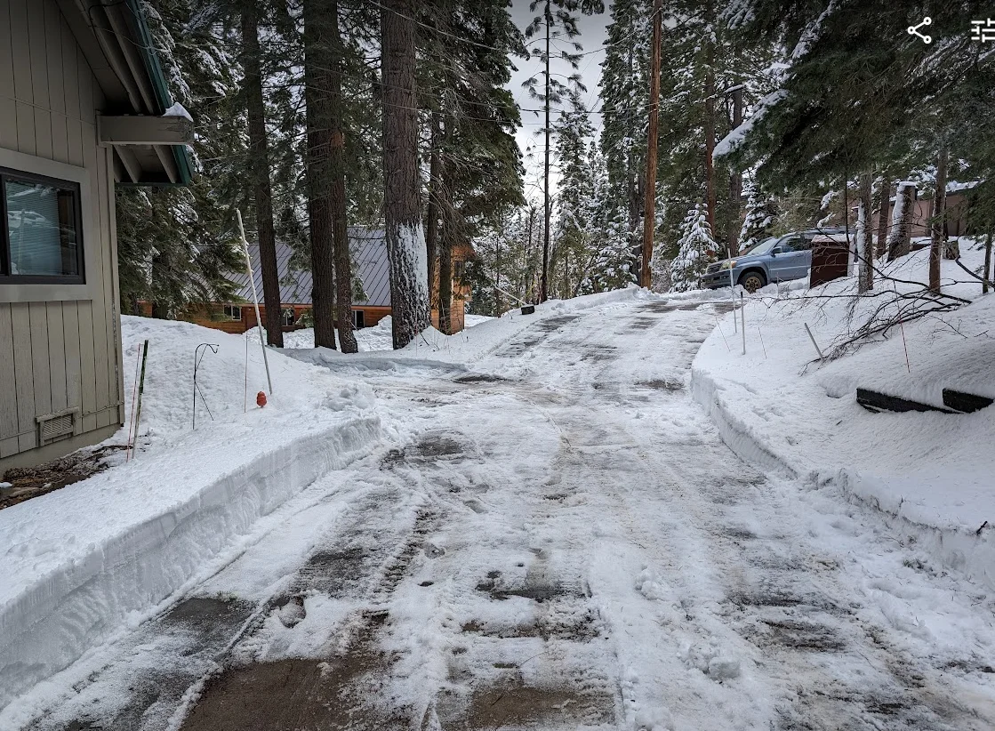

It was also the longest drive ive taken in the GX since I bought it in Dec last year. Previously going into my office a few weeks ago was the longest drive (33 miles lol) at a singe time. The cabin is roughly 80ish miles from home, up elevation. Drove up like a champ. Driveway was much deeper than anticipated and I high centered the GX lol.

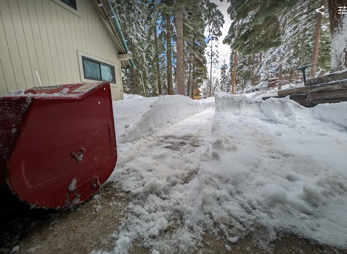

Walked down to the garage and fired up the snow blower, then dug out around the GX with a shovel, down to the garage no problem after that lol.

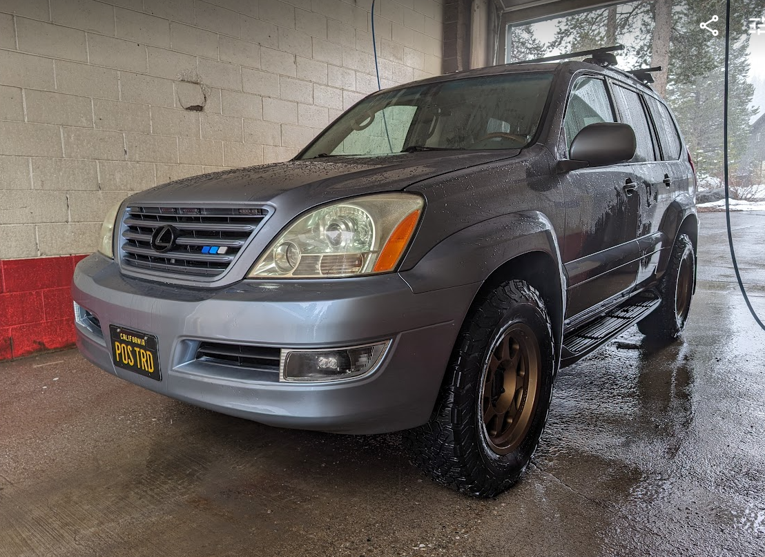

Took the GX out to a small lake just across a DAM. Started to get real soupy and the ruts were starting to rub the belly..so decided at the next flat area, turn back around before getting stuck hahaha.
Figured I dint want to leave this mud all over the car and having it freeze overnight. But I also didnt want to hook a hose up and spray it off at the cabin.. water would ice the entire driveway and might not be able to leave after lol. So found a local DIY car wash, and i was really happy to have a pressure washer to use!
