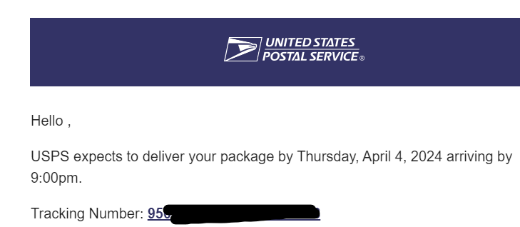

Very curious.. my pin/sping fix-it kit from the land down under, which I placed just about 5pm PST yesterday... is slated to arrive by this Thursday via USPS.
Wondering if the maker/owner has friends/family in the states and keeps a large stockpile of parts "locally" for quick delivery.
If that is the case... that $20 shipping charge is extremely excessive lol.. I know a large padded flat rate envelope is less than $8
Kit arrived... and it mailed out from Milpitas CA, which is roughly 2hrs southwest from here... not Australia and it only cost $5.10 for shipping not the $20.50 I was charged.. not happy about that. Going to shoot an email to them about that.

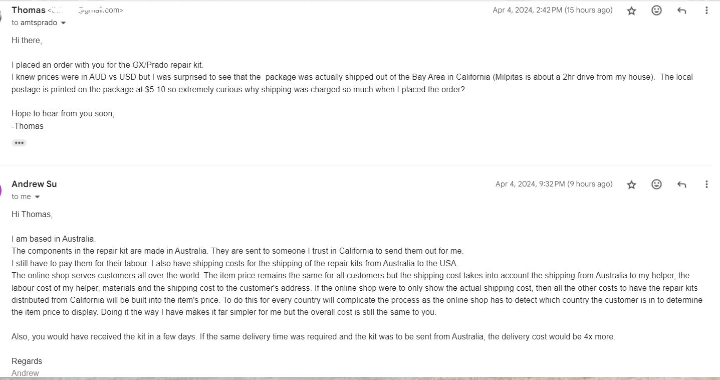

Got a response
I mean, I get it... but still kinda wonky.

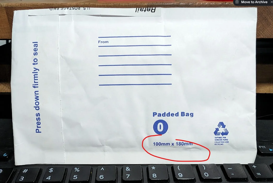

Im sure he's shipping dozens of these kits to "someone he trusts in CA" (aka a family member with the same last name lol) to save bulk shipping and im fairly certain the he's prepackaged all of them - so his family member in CA just has to write the recipients address on the envelope and take to the post office for postage (based off the sent address in the Bay Area, the post office is only 2.3 miles from their house too). Generally, the cost of the part has everything he listed built into the selling price (material cost, labor cost, etc). So sounds like he slimmed the selling price down and upped the shipping cost.
Whatever really. Just a bit misleading and he's making more than the listed part price but oh well.
The reason I believe he's shipping them to CA pre-packaged is due to the fact that the small padded envelope has metric printed dimensions lol
I agree it's kind of weird....but makes sense there is a second shipping charge that we aren't seeing (getting a big box of parts from AU to CA).

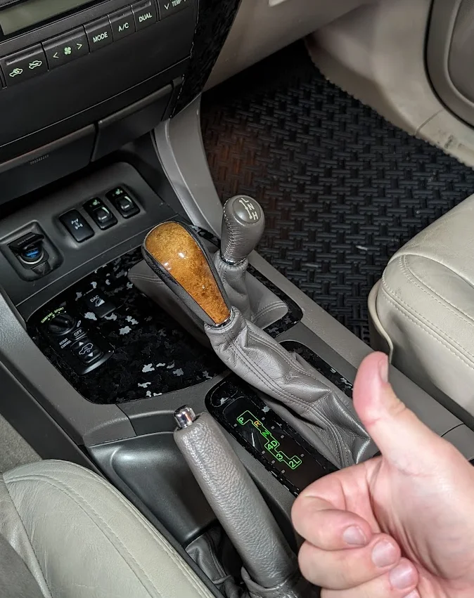

Dug in this morning.
First time removing the cup holder in the center console.. man the folks who owned this prior to me were... ehhh. So much crud down there, including a USPS receipt from July 2005!

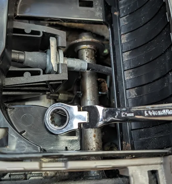

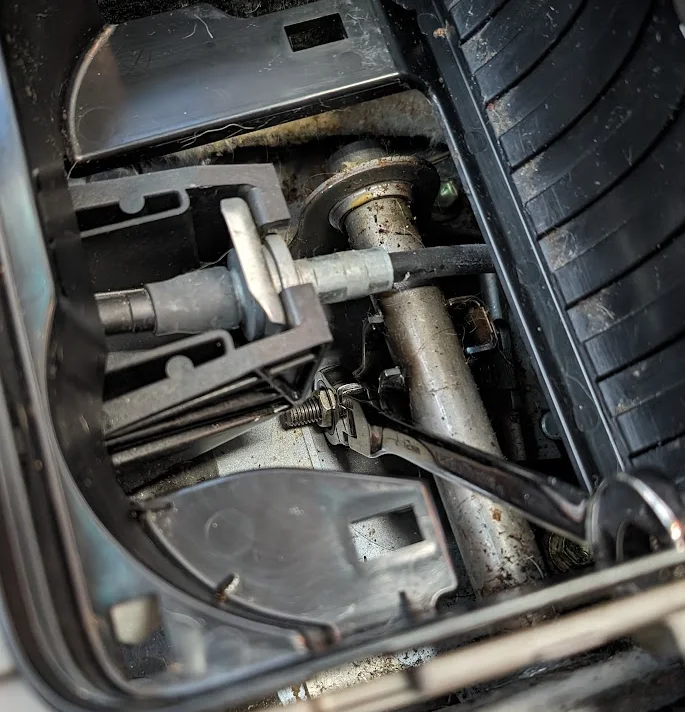

I first did the e-brake adjustment. Feels much more snug now, but I havnt driven/parked on an incline yet to see how it does.
Just used a ratcheting 12mm wrench to tighten the nut.

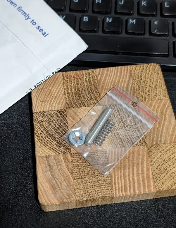

OEM on the left vs replacement parts
Installed the replacement ones, and put the top of the shift mech back together so i could test the shifter. Feels back to normal!

Put the top plate of the shift mech back together and gave it a test shift: Shifting mech fixed
This is how the shifter felt/acted when the pin went ejecto seato from the housing: shift mech pin failure (easy enough to shift with 1 finger, and did not stay in gear)
