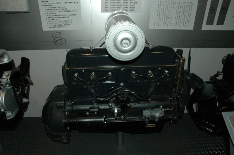

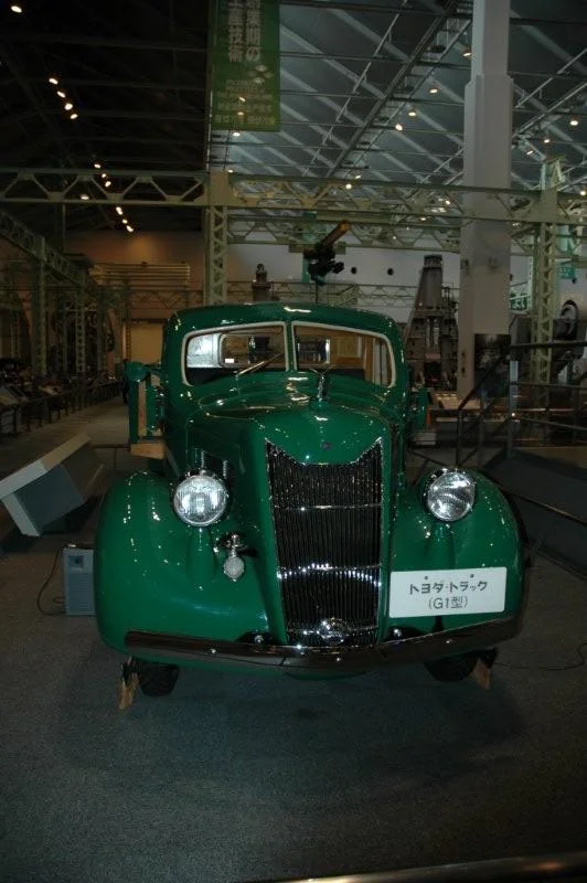

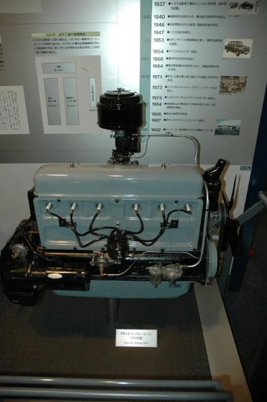

Light green engine is the 1933 Chevy I6, black one is a 1935 Toyta (might still have been Toyoda?).

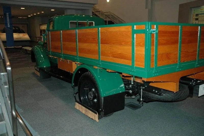

Truck is a replica of a G1 which used the engine, also used in the AA sedan.

Hmmm? Nice pictures. Thanks. Do you think they might have copied? Toyoda (with a "D") got a license to build the Chevy 6, and it became the 1F and 2F, and 3FE,......etc. The Japanese also built Pratt and Whitney aircraft engines and Hamilton Standard propellers under license. I recall an uncle telling me that when his plane was damaged during WW2, they went over to a wrecked Jap plane and took a part off of it to fix his. Not certain if that's true or not, but the Japanese developed the art of copying to a high standard, as did the Russkies with the TU4. And, as have we. :beer:Ned
The early toyota I-6 is a metrified copy of the Chevy OHV I-6 of the 1930's.
After the war, Toyota copied the 228-248-270-302CID GMC OHV I-6. It is a rare engine, one of only two engine families specifically designed & manufactured by/for GMC trucks. The 305CID V-6 being the other family. The GM truck (and 1F replica) differs from the earlier passenger car engine by being a few inches larger in height and length. They will interchange dissy & fuel pump w/ other chevy & GM products of the time, but they are easily distinguished by their WP mounting, which is 4 bolts in a semicircle. Other engine families used 4 bolts in a diamond or a square pattern.

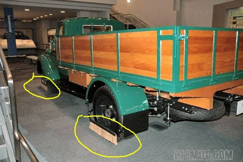

G1 truck was very nice, the only thing that let it down was the tray, the wood was too polished!

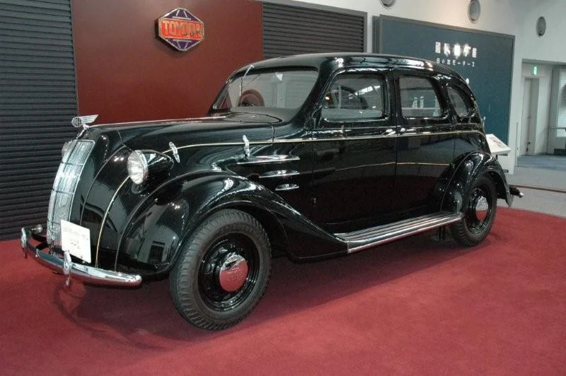

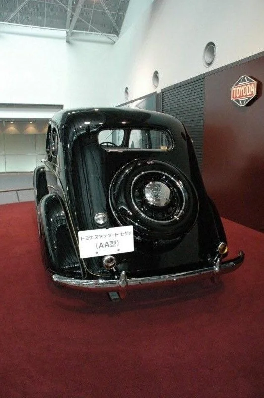

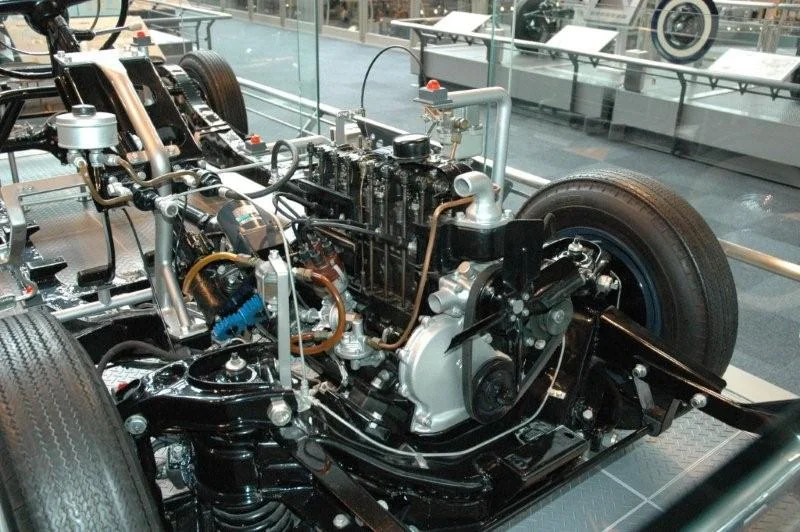

AA car was intesting - given it was like the second model the factory made it was quite ambitious, amazing hand finshed panels.
EDIT: The frame cutaway was automated to show the engine turning over so ignore the blue gear wheels and the electric motor!

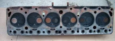

The F head appears to favor the Chevy 235 in 1 feature at least: the valve stems are parallel to each other in the crank axis (front to rear), but slightly diverge in the cross-axis (left to right), as shown.
What I can't determine is if either valve is vertical (and the other inclined by the difference), or are both inclined?
Does anyone know what the actual angles are?
This also means that, like the Chevy, the intake and exhaust rockers are different both for length between the shaft center and the contact pad (since the stem tips are different distance from the shaft) but also for angle.
Do a little more research.
That is the same (awful) valve layout used on all F engine prior to 1968. both the stovebolt passenger engine and the big GMC inline engine used the staggered valve layout through the end of their production. When Chevy introduced the modern inline-6 230/250CID engines, they had a proper cylinder head with discrete ports and inline valves. Toyota followed suit a few years later with the improved F of 1968.
Sorry, not following you. I can't find a picture of an F chamber much different from this.
The valve angles, the recessed exhaust valve, the exhaust pocket over the block, which?
Yes on the Chevy, but that odd chamber was never used on any GMC L6.
The chamber shape varied (2 different), valve sizes, port sizes, but with valves parallel in both planes 1939-63, very similar to the Buick L8 (and others in that time period).
Discrete ports?
Except for the siamese intake (all cylinders) and exhaust (2-3 & 4-5 cylinders) ports used throughout the entire U.S. built series.
