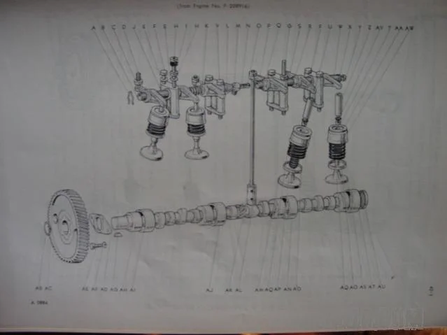

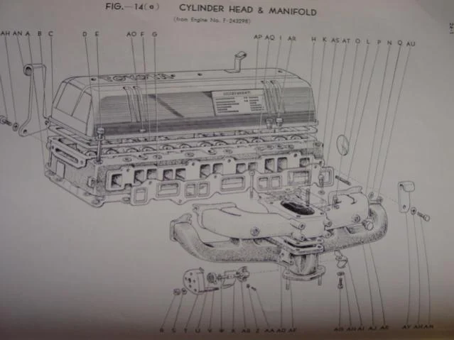

No time to drag the manual in the house and scan, so here are some bad pics:
1st is the early staggered valve configuration
2nd, the improved inline valves

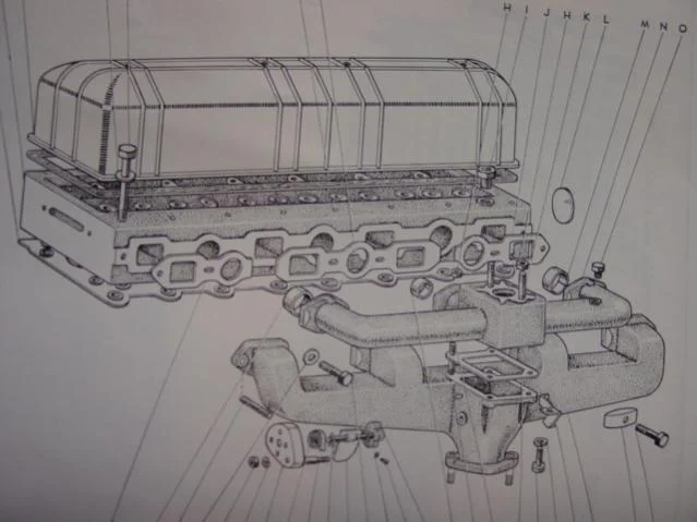

3rd, the siamese port & manifold
And the improved 12 port head & manifold

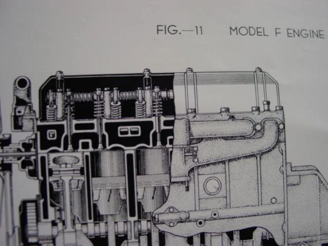

staggered valve crossection

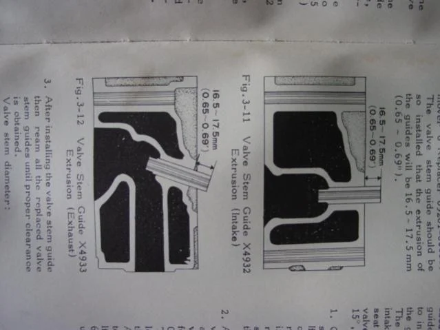

and staggered valve guide install details.
Sorry, no pic handy of the chamber, but it looks like the old chevy pictured above.

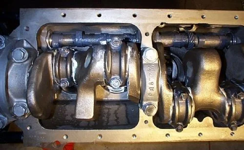

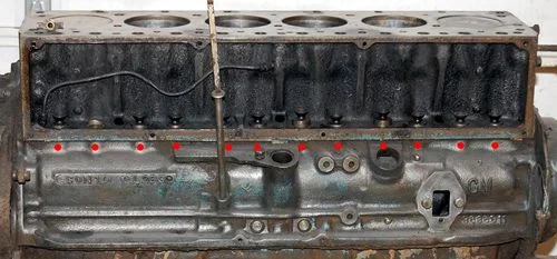

Based on this picture, there's not enough metal right above the cam.
Jim, if I might ask, what year parts manual is that illustration from? That's the first time I've seen a picture of the cup-shaped valve retainers, which are what came with my F135 head. I had wondered if they were even toyota.
Parts book is 1968, illustration is for the later siamese head, appx 1964-later.
There is also an illustration of the earliest (58-64?) valvetrain that does not have the umbrella retainers.

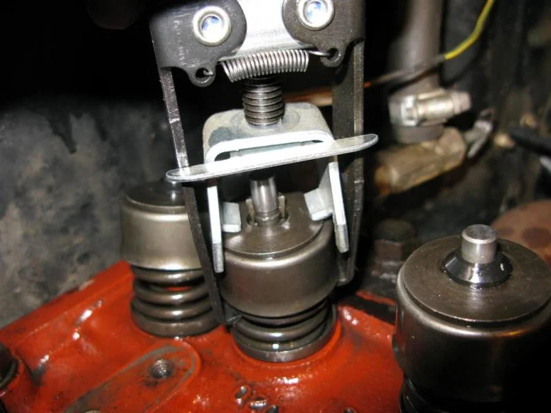

attachment.php
Cool! Thanks! And do the stem seals go above as I have them in the picture, or below the umbrella retainers as they do in other years?
(Don't mean to hijack, but I hope these details are tangentially on topic.)
