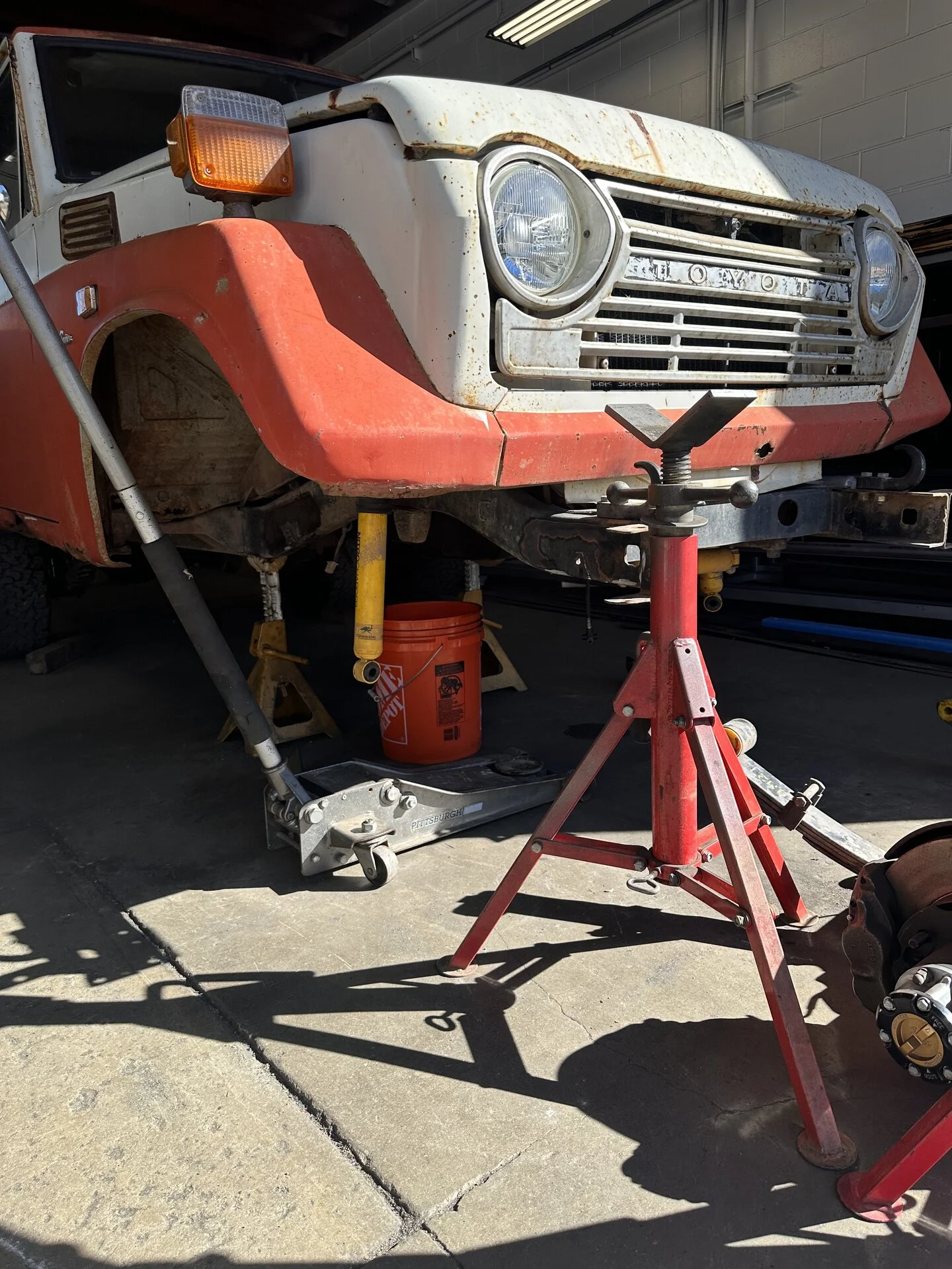

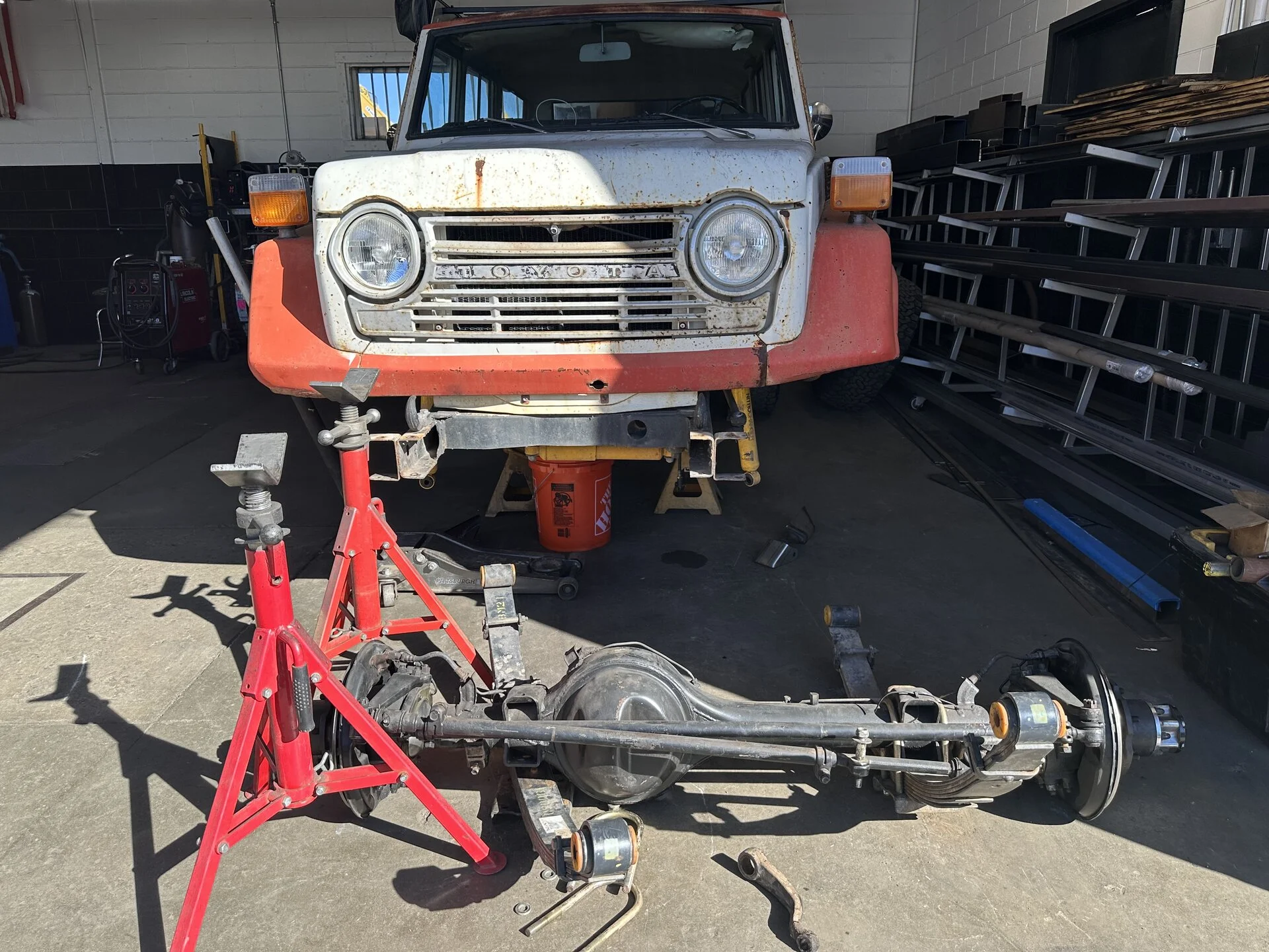

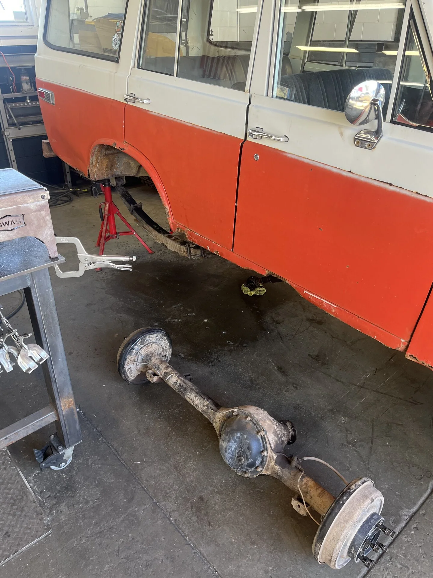

Front diff broke at the pig party and I’d planned on doing 60 axles already. Just such a solid upgrade.

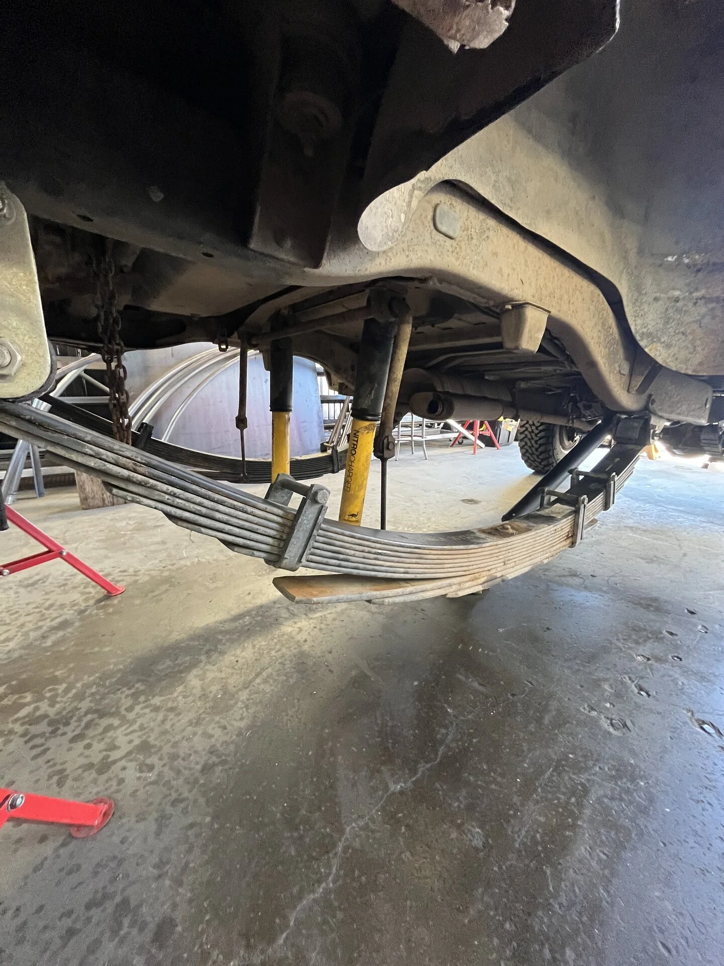

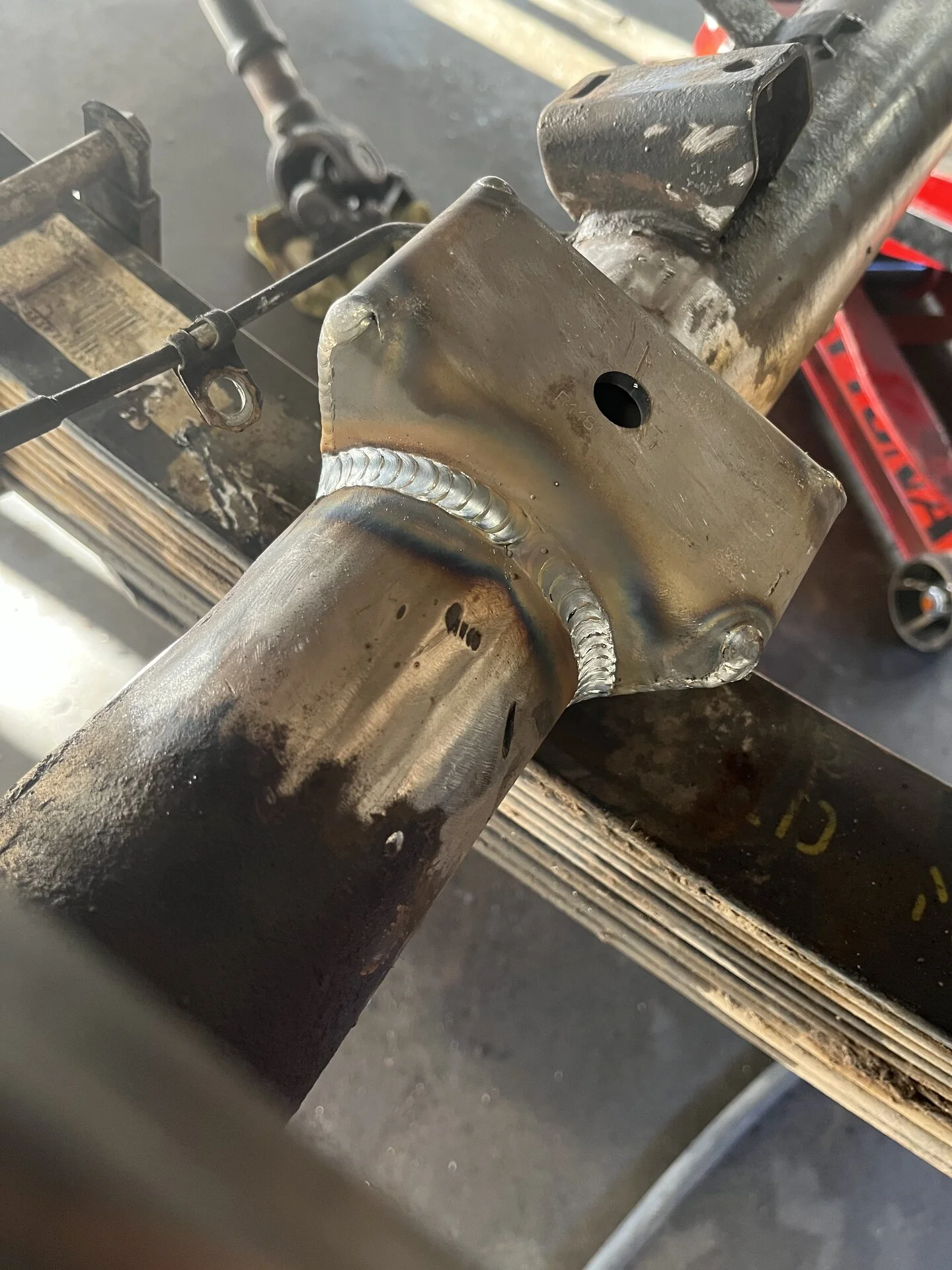

Mine is a mix match of stuff. New lines and homemade tabs for the lines. Shock mounts are modified F250 towers and I have the bottom shock mount on my bottom u bolt plate. I went back and forth with the u bolt mounting, flipped then back again, so I just made my own with 5/8th u bolts as per J Mack suggested curing my stretchy nuts. :)
