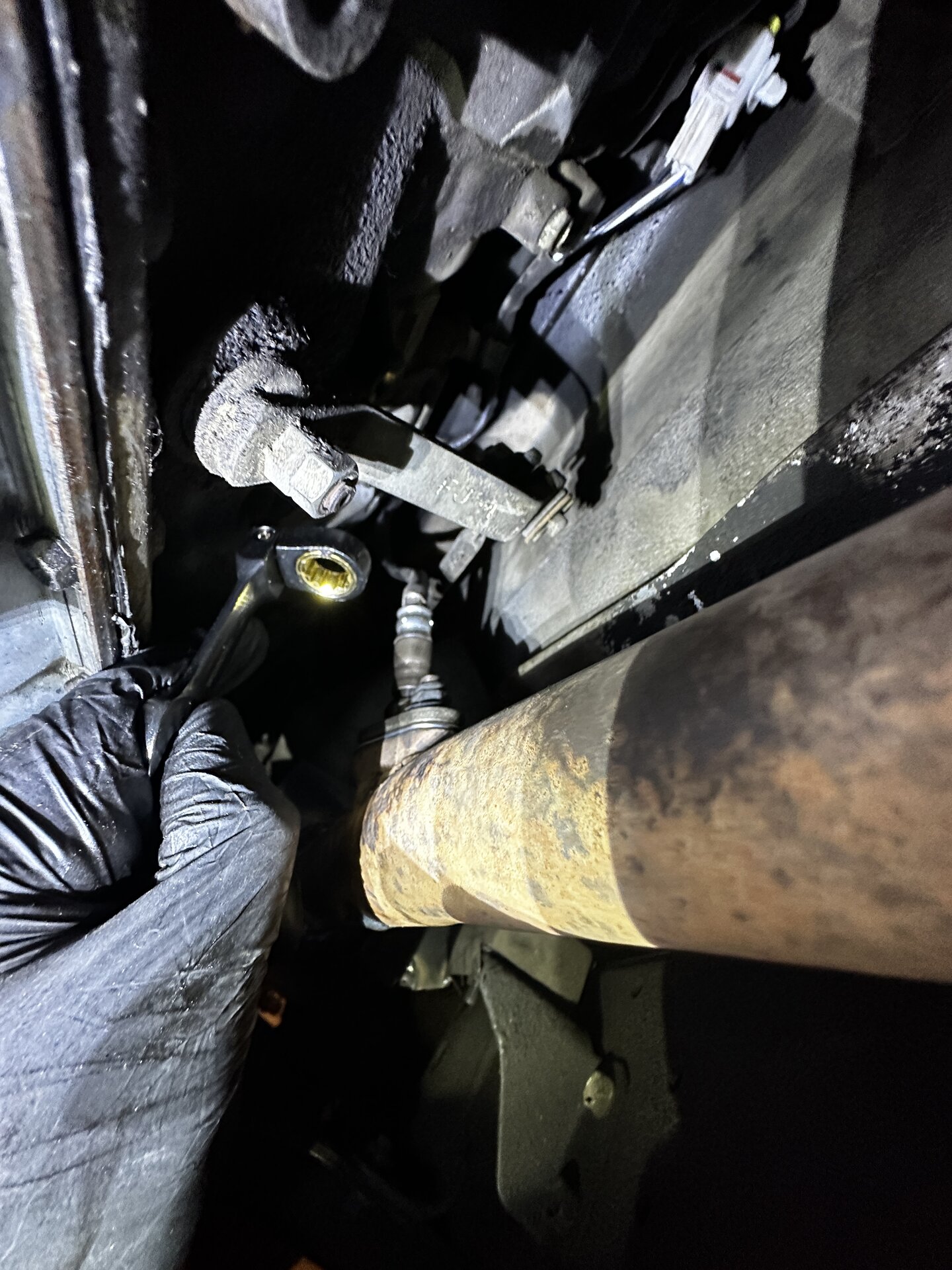

Update: still throwing codes 25,26…when I tested from Ox1 and Ox2 at diagnostic port after a 2 minute warmup @ 2500 rpm, the oxygen sensor voltages swing low-high-low-high as expected. I’m checking with a digital multimeter, which it’s a little sketchy, but it feels correct. I decided to test again after a 20 minute drive…sure enough one of my oxygen sensors was malfunctioning - stuck on the low voltage. Unfortunately, the broken the sensor is for cylinders 4,5,6…the bugger that is mounted upside down near the transmission, where my ogre hands do not fit! I struggled for too long to free the crusty old sensor!

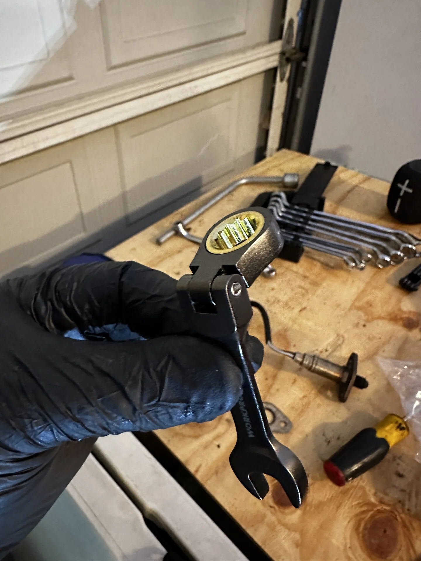

While purchasing the new sensor, I also grabbed a stubby, flex-head ratchet wrench set from Amazon. This made reinstalling the awkward O2 sensor SO much easier! https://www.amazon.com/dp/B0B6Z9N6Z6?tag=ihco-20
It might seen expensive for a random speciality tool (54mm socket also comes to mind!), BUT my least favorite part of working on cars is trying to get my gorilla hands into impossible to reach places, for impossible to access bolts…maybe I’ll find other uses!

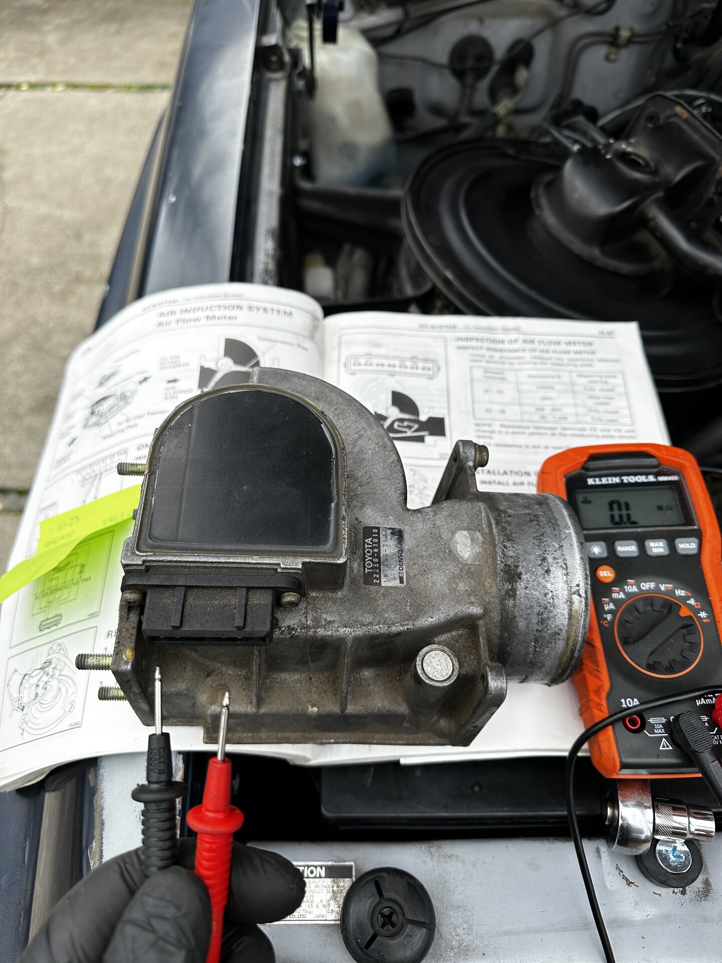

Thanks for the ideas! I checked the MAF per the service manual - all of the ohm reading were within expected ranges…so I’m thinking the MAF is okay.
