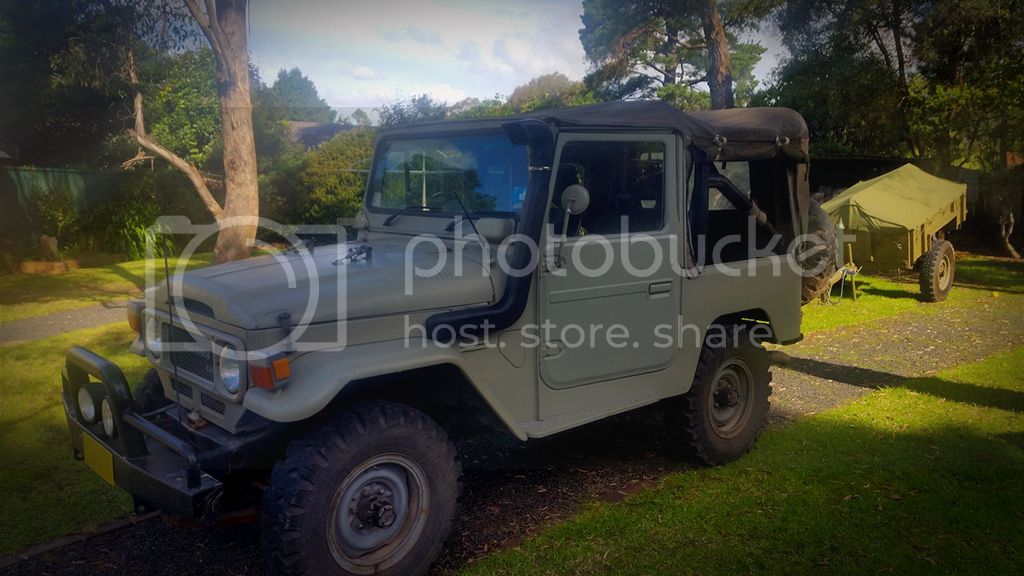

Here's mine
I had one for a hj60 shipped for about 130 dollar and the bolts rust instantly so replace them, also the paper with the holes was missing one important hole and drilling in the fender is a bit confusing at first :poop:
But the quality is good enough, separates water in huge rain showers and it drives very well, a bit more cool and in winter I need the radiator curtain to get the engine hotter.
