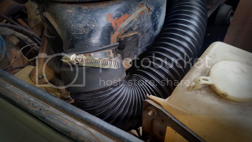

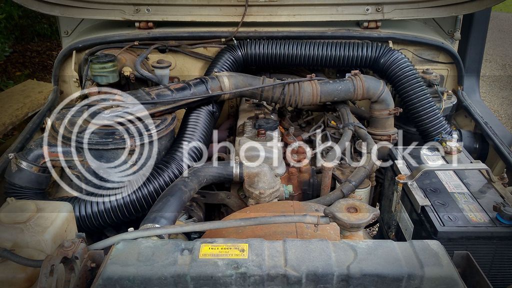

As discussed. Here's the snorkel plumbing in my engine bay
There may be better ways, but this one works for me and the peculiarities of the 13b engine.
I'm using the same unit as @pngunme It came with stainless hardware and reasonably accurate template for installation. It does stain easily so a coat of paint made for plastic is in order. I also discarded the flex hose in lieu of stainless tubing and rubber connectors. I was running a Donaldson air box. But with the addition of a factory AC compressor on my 12HT I no longer have space for it. I'm currently searching for a suitable replacement. I also replaced the factory plastic inlet grill with a nice stainless unit from a mud member.
