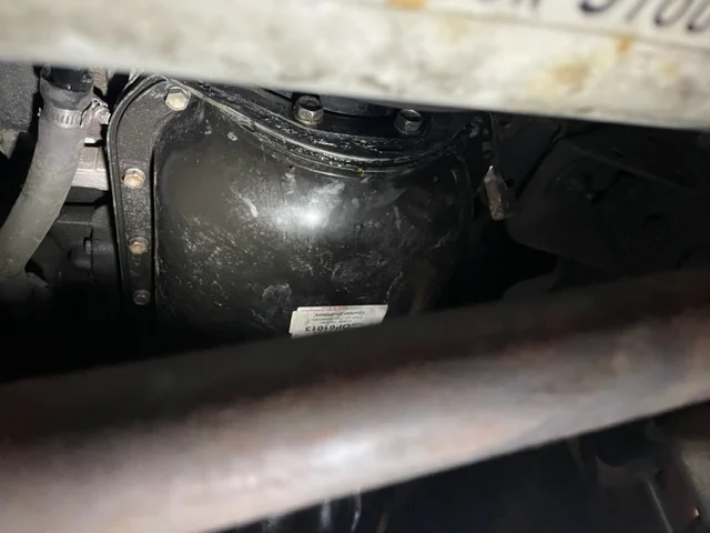

yes - right behind timing cover. Attaching media for reference. Would it perhaps compound to the additional problems mentioned above?
The timing cover bolts are different sizes and must be put back correctly. There is a plate behind the cover and that may need to be removed and new gasket there as well to stop an oil leak. Most oil leaks around the oil pan are from the rear main seal leaking down the backside. This can only be corrected by pulling the transmission/transfer case and replacing the rear seal on the engine.
nothing but the fuel gauge looks right in that image. The oil pressure is low, the engine is hot, and the voltage is LOW. You have some work to do. But your first most immediate need is to resolve the overheating. Then the voltage and then the oil pressure. One thing I did to help my oil pressure was to clean the oil pick-up screen in the oil pan. Mine was covered with sludge. The low voltage could be bad or cruddy terminals at the battery or the battery ground points or possibly just a bad battery. It could also be a bad alternator but you'd be having issues charging and keeping batteries charged if that were the case. I doubt the overheating is caused by the oil....More likely low coolant, sticking thermostat or faulty gauge.
Also be aware that to get to the gasket on the plate behind the timing cover that @g-man is speaking of, you will need to pull the camshaft. It's a big job. My suggestion (and what many folks do) is to re-seal the timing cover itself, cross your fingers and hope that takes care of the front side leak...and if it doesn't, live with it.
