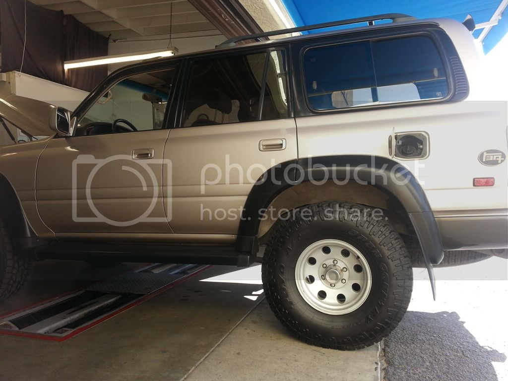

I passed California smog with the VC120. There was no mention of anything out of the ordinary from the tester.
