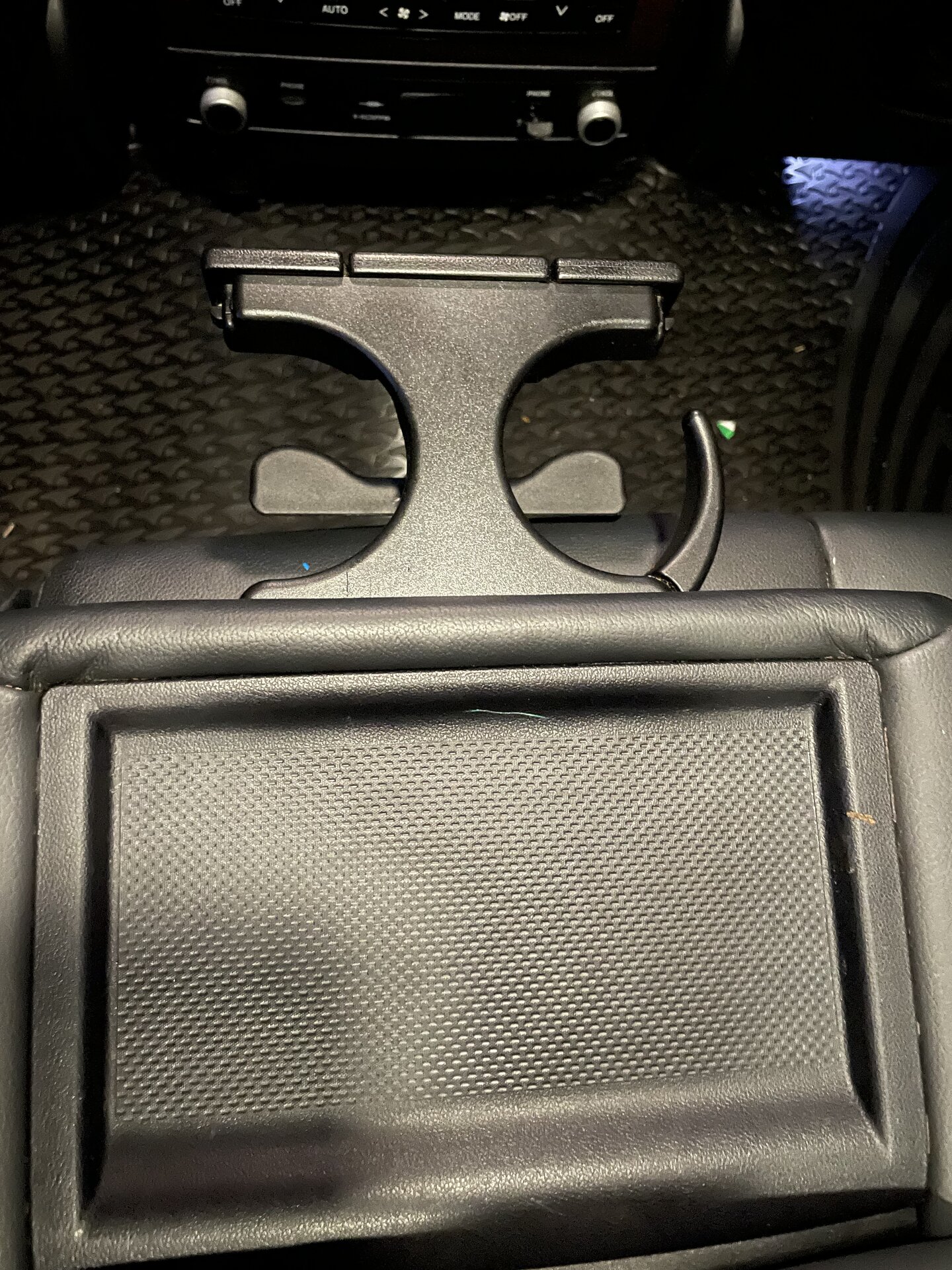

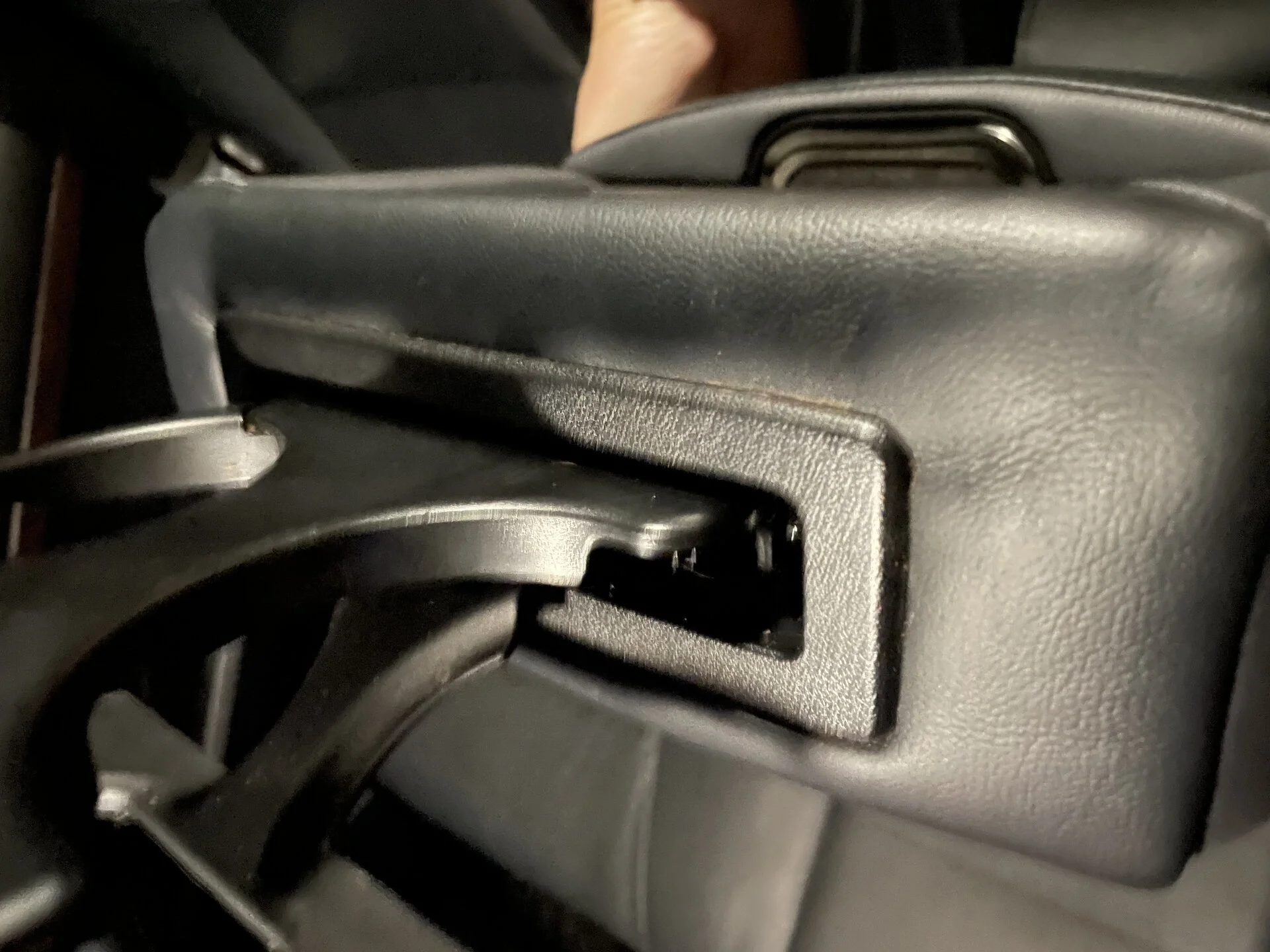

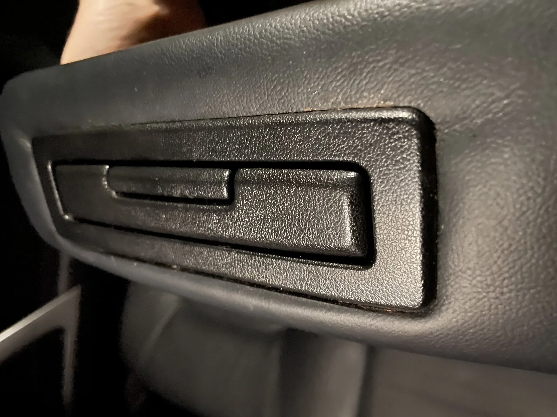

Hi All,
I have a 2019 Landcruiser 200 series and the retractable cup holders in the second row, center console are broken. I have the spare part to change it, it have no idea how to remove the broken part. A google search has come up with nothing.
I was hoping someone here may know or have changed this part in the past.
Any help would be much appreciated.
I have some photos of the part.

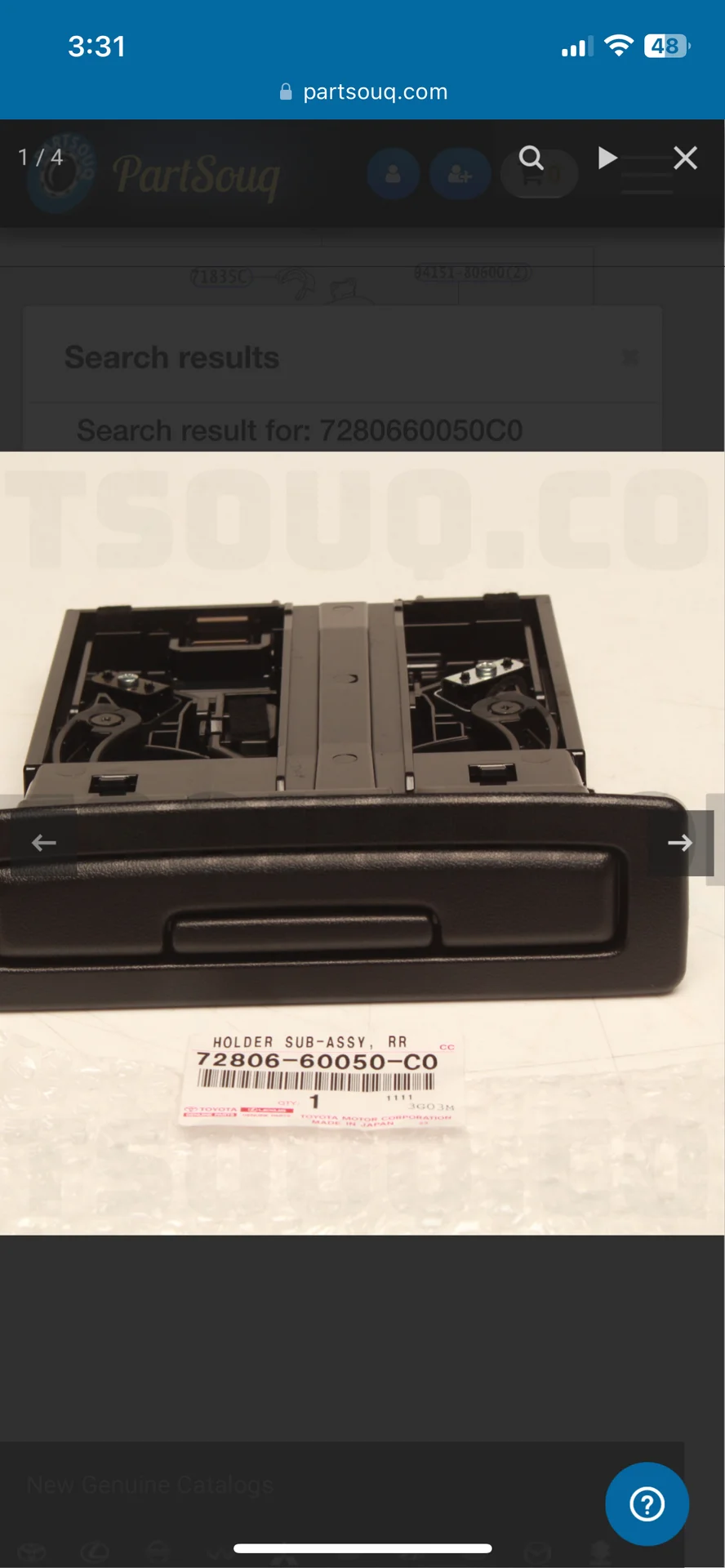

can you post more photos of the brand new replacement ? that will give us some hints of how to go about removing the old one

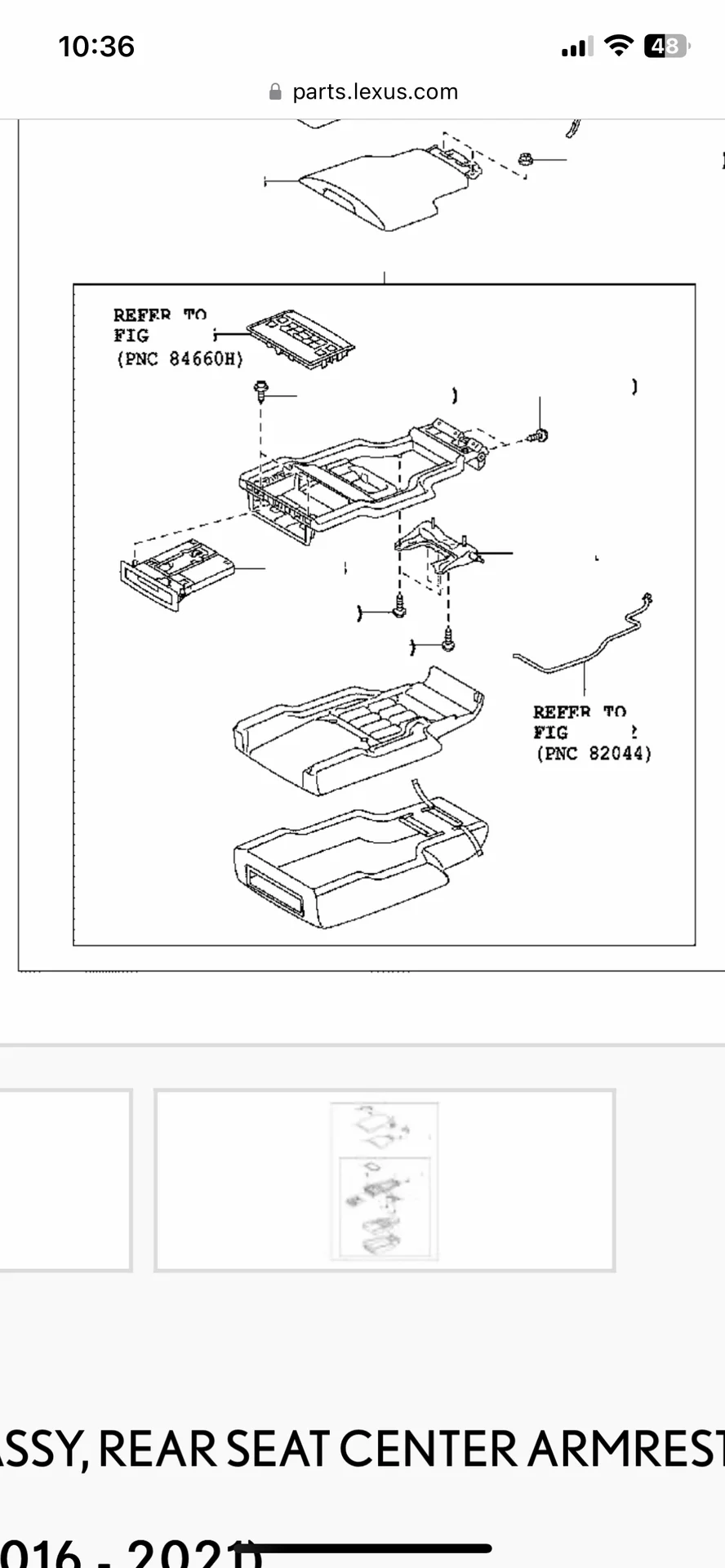

I have this screen grab about how there are 2 screws to take out (of which I have done) but the part still feels like it is locked somewhere in the back - but I can’t get to that to see.

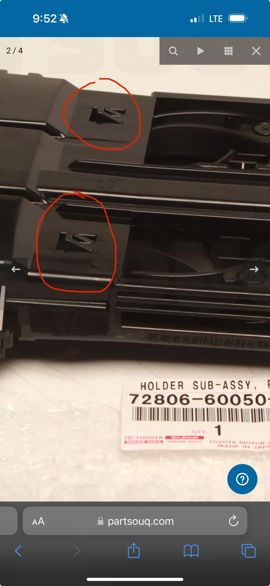

The red circles tabs are holding it in, likely with two more on bottom. It may need removing of the slide out cupholder and releasing those with a screwdriver. Or if that won’t come out to be pried with some plastic trim tools.
Mate, you’re a legend. You got me thinking and I went back and had a proper look at it. I saw the bottom clips after I broke the top ones away. I had to attack them with a screwdriver and break them off, but once I did that, the part came sliding out.
I put the new part in with no hassle at all.
Thanks for your reply - I can now cross this problem off my list.
