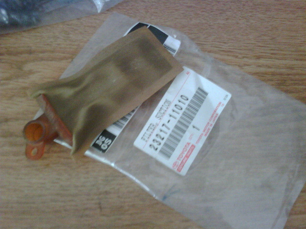

I was worried when i opened mine up and it was orange instead of white but i realized the OP had a FJ80 and part #'s were off just a bit too. Missed the part about the clip and new banjo bolt gaskets so waiting for those now.
Here's my nice and brown one off my 91 with ~132k miles. sorry for the crap picture, used my phone instead of my camera (lazy) :)

23217-16490 filter...mine is orange also
