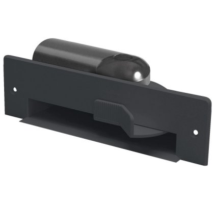

We had one of the under cabinet dustbin outlets installed in the kitchen and I have to say we used it a lot. Not sure how difficult it would be to install in a finished kitchen.
