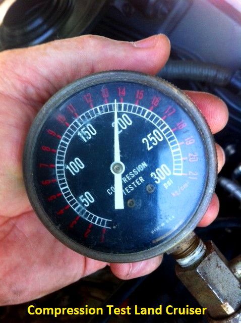

Have a compression check done it...or do it yourself. That would give you a good indication of the health of the Cylinders and rings....without pulling the head to look. Also you can 'bore-scope' the cylinders and see what they look like to some extent.
The 1FZ-FE is not an especially powerful engine anyway, but quite reliable. IF your cylinders and lower end are still in good shape, then refreshing the head, having your injectors serviced and just a good general tune up...might be all you need. (Plugs, Wires, Cap, Rotor and set timing).
I have 312K on my '97 and still have 190psi on all six cylinders.

So it took about one beer per cylinder, but I managed to change all the spark plugs along the way since why not. First the good news!
Compression test results:
C1: 190 PSI
C2: 190 PSI
C3: 190 PSI
C4: 190 PSI
C5: ~181 PSI (I had to run this cylinder a few times. Initial run was terrible at 150 PSI, but I re-seated the tool and the following 4 attempts came in at 181. I released the pressure after each run)
C6: ~180 PSI
So the numbers look really good considering 327K miles on the motor. But ... I'd like your opinion on the following I when I pulled the spark plugs that have less than 3k miles on them:
All of them had a healthy amount of oil on the threads (ignore the dirt they picked up after i placed them in the driveway). A quick google search offers explanations ranging from bad valve cover gaskets up to bad head gaskets. My takeaway so far is that I'm likely looking at a head rebuild no matter what if my goal is to cure the oil burning, during which all of these issues would / should be addressed.
Base on what you've seen so far, does anyone feel strongly that I need more than a head rebuilt at this point? My mind is blown.
