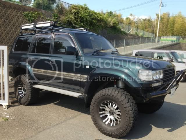

HDJ 80; 5mm steel bumper up front.
Front (ironman performance 2"; 1" rubber spacers) - 22.8"/580 mm
Rear (ironman performance 2") - 23.5" 596mm; has spare tire; shovel + mount. Pintle hook.
Pretty bad stink bug before the spacers. Now it sits level and el guapo points are mucho up hahaha!
