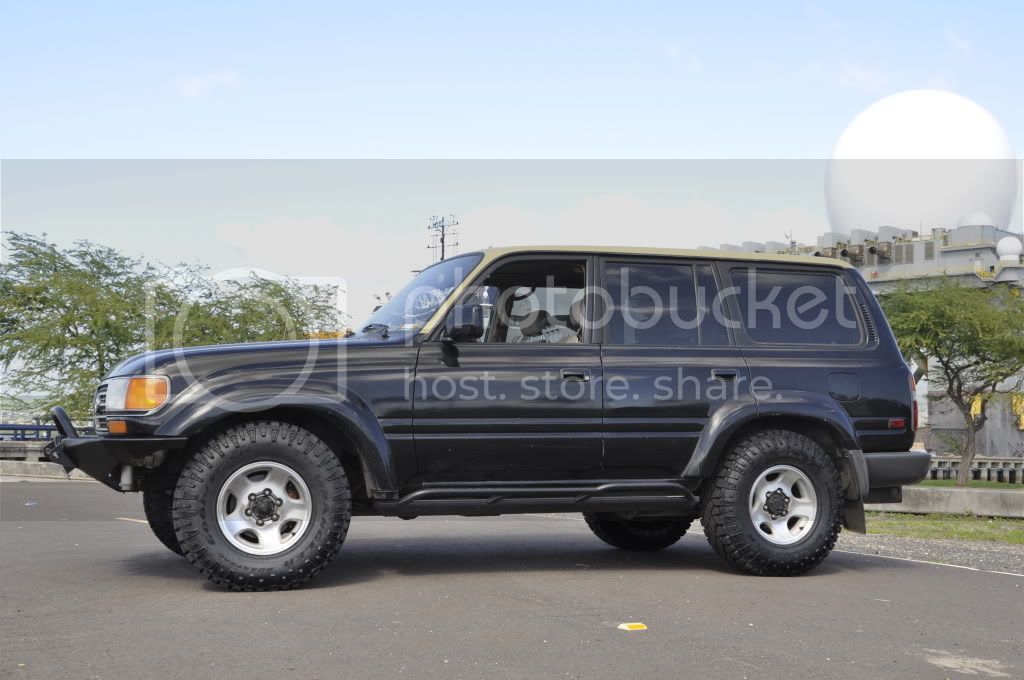

97 Lx450, No extra weight added, super saggy Js F&R... With an additional 2in spacer in the front & 1in in the rear:
Front: 24.5
Rear : 25.5
Rolling on Gen II 37x12.5x16.5 MT/Rs
