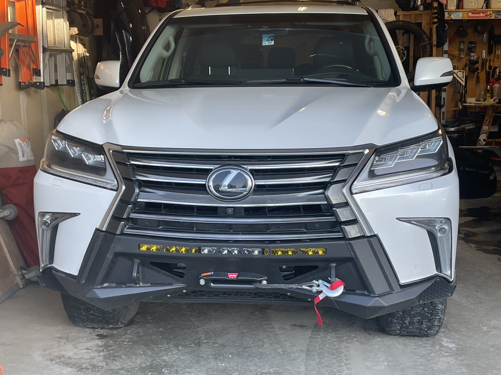

CBI covert Bumper on a LX570
I didnt weight the mass difference, I will say it has been on now for a while and many miles and it still looks great and finish is good. I waited the full length of the lead time but they were good with updates.
Looks great! Did you not weight it @ducky145 ? Did you weigh the take off/cut offs too? How long did you wait for delivery?

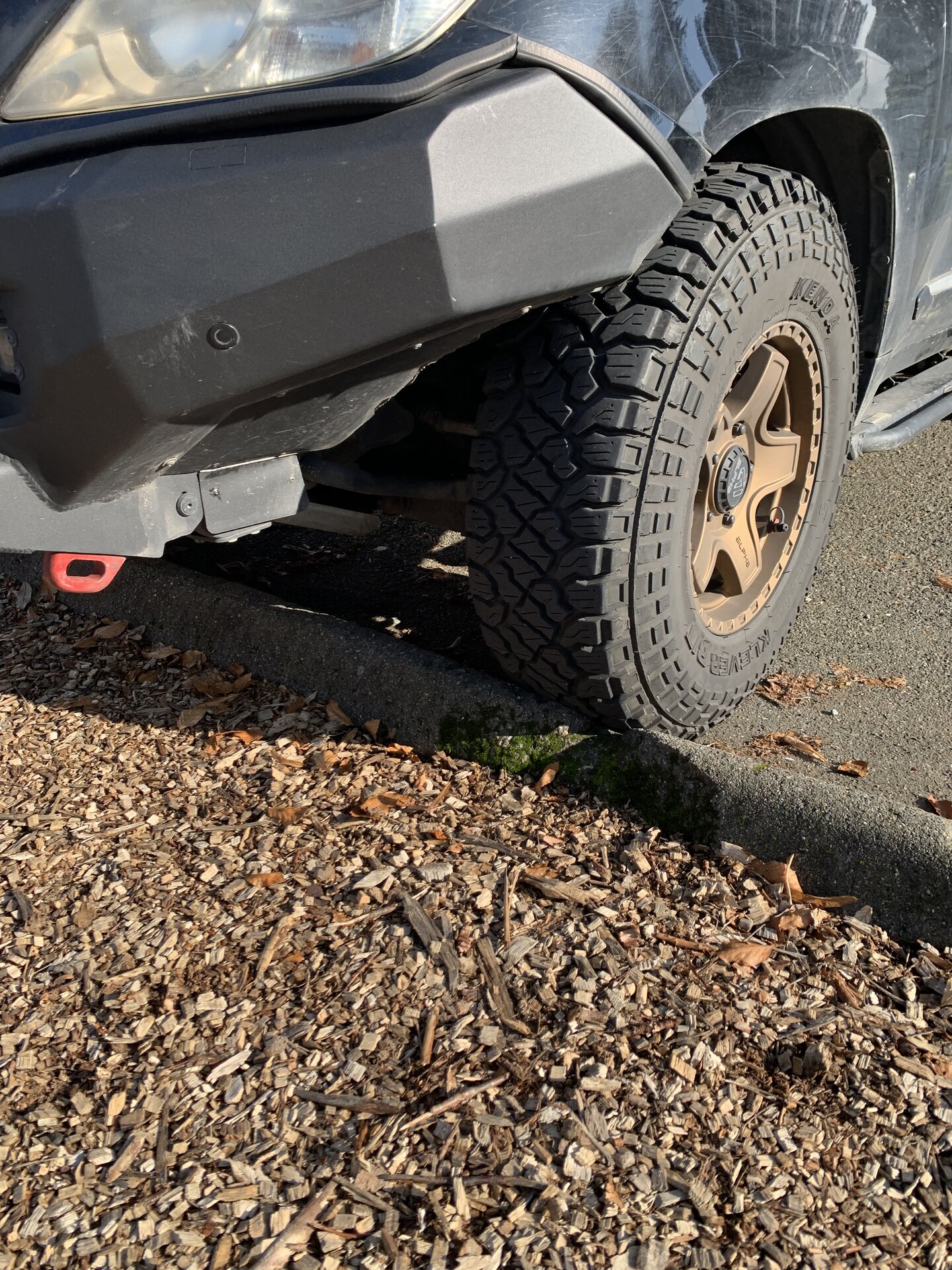

I agree with @tbisaacs that it doesn't capture some of the low hanging off-road design fruit, but as a installer of a TLC bumper on my LX, I didn't really get much clearance back either. The frame horns are where they are at, and the attachment point for the tow hooks on the frame isn't moving either.

OP, looks great! I wish they made a bumper like this for the 08 to 12 LX. Keeps the understated look intact, while providing some protection and capability,

100%. My GX bumper always got smacked on the corners. I had to reform it with a heat gun and bend the brackets back into place a couple times.
I have had to do the same. Before I had the heat gun I was able to prove the hot water via kettle and a little pressure from inside the wheel well will indeed work. Hopefully trimming the bumper a decent amount will reduce some of that, however it won’t protect from some higher side impact like I imagine this cbi will just as sliders help keep things out of panels etc.
It’s this part where the approach is much better on an aftermarket bumper, being able to edge up on an obstacle from an angle.
There isn’t much gain straight ahead approach with any aftermarket option.

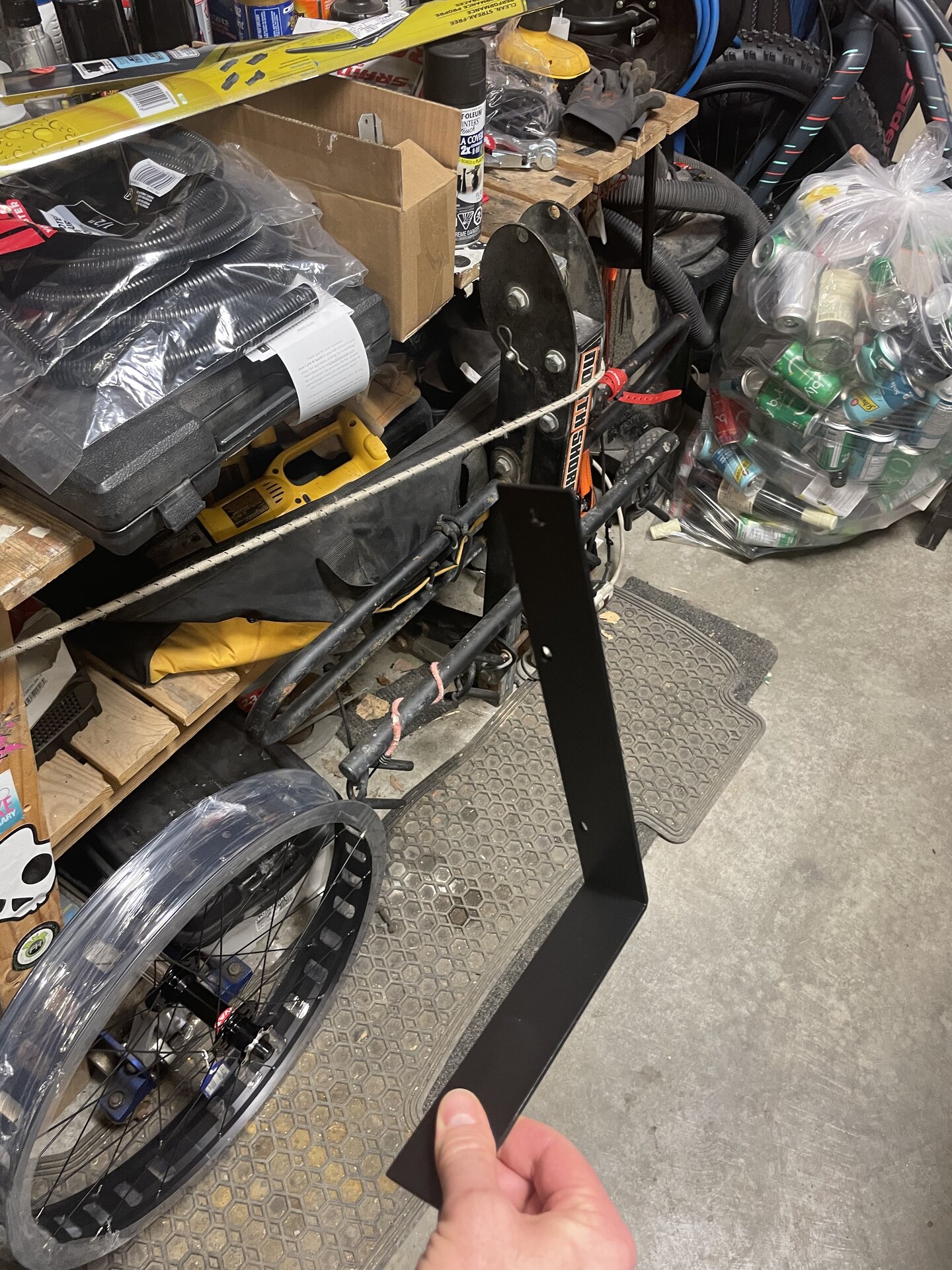

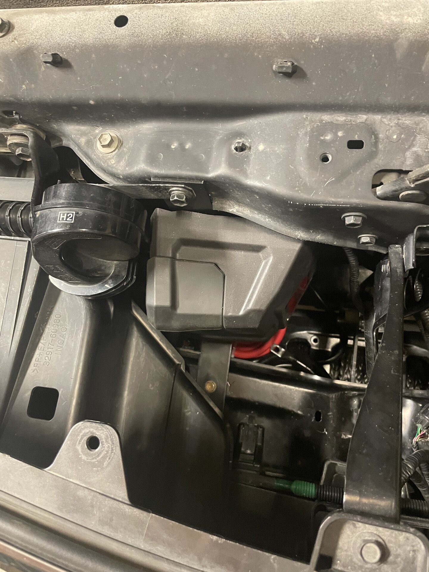

I have a question about the winch installation. Did you need to purchase the warn relocation kit? If not where did you mount the control module? Do you have any pictures? I’m planning to install mine this week, just want to make sure I have everything I need.

Would love to see some pics!
Here are some pictures of the winch fully installed. One of the bracket I built to mount the winch controller and one of the controller installed.
