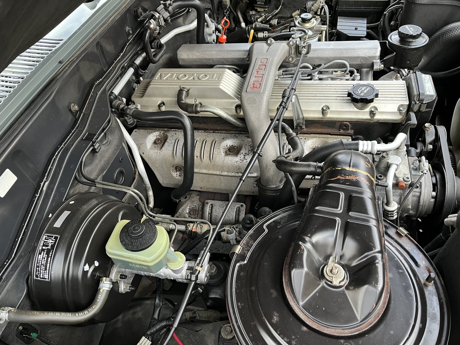

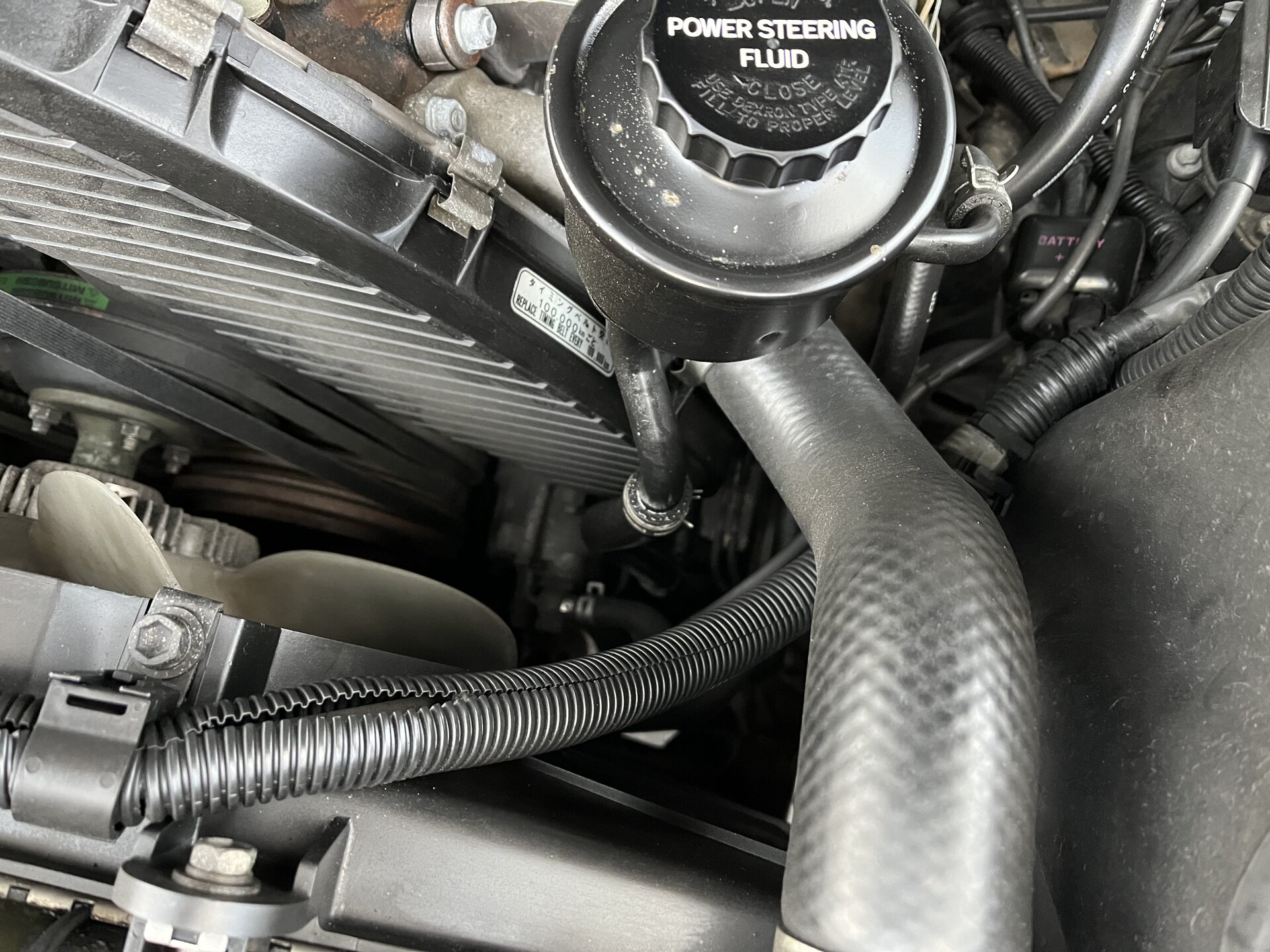

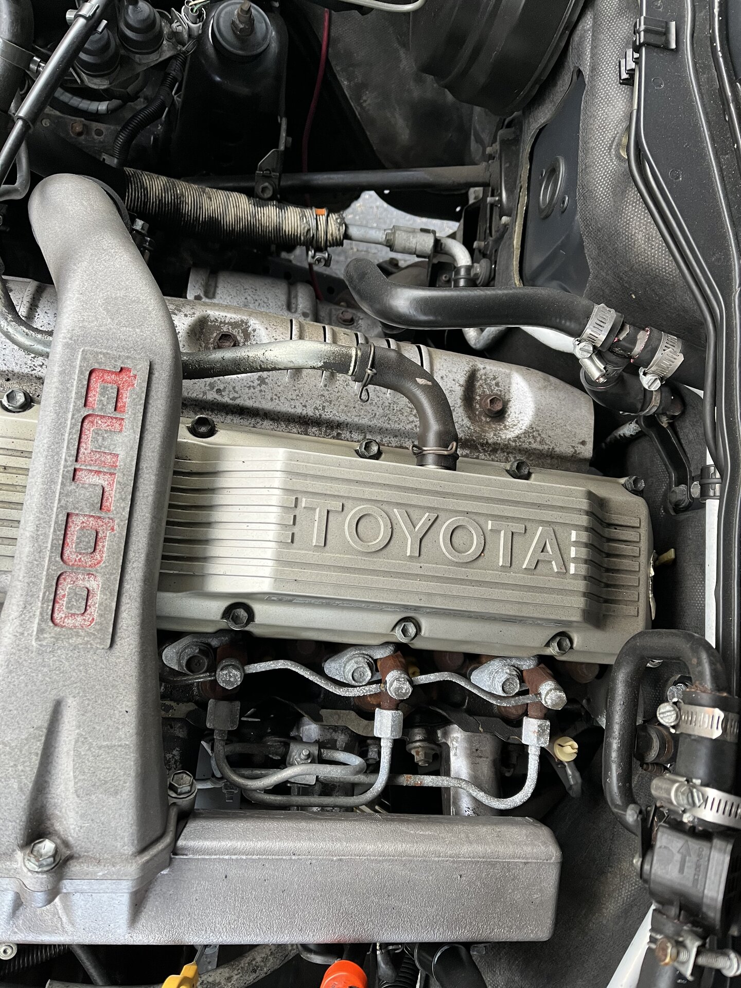

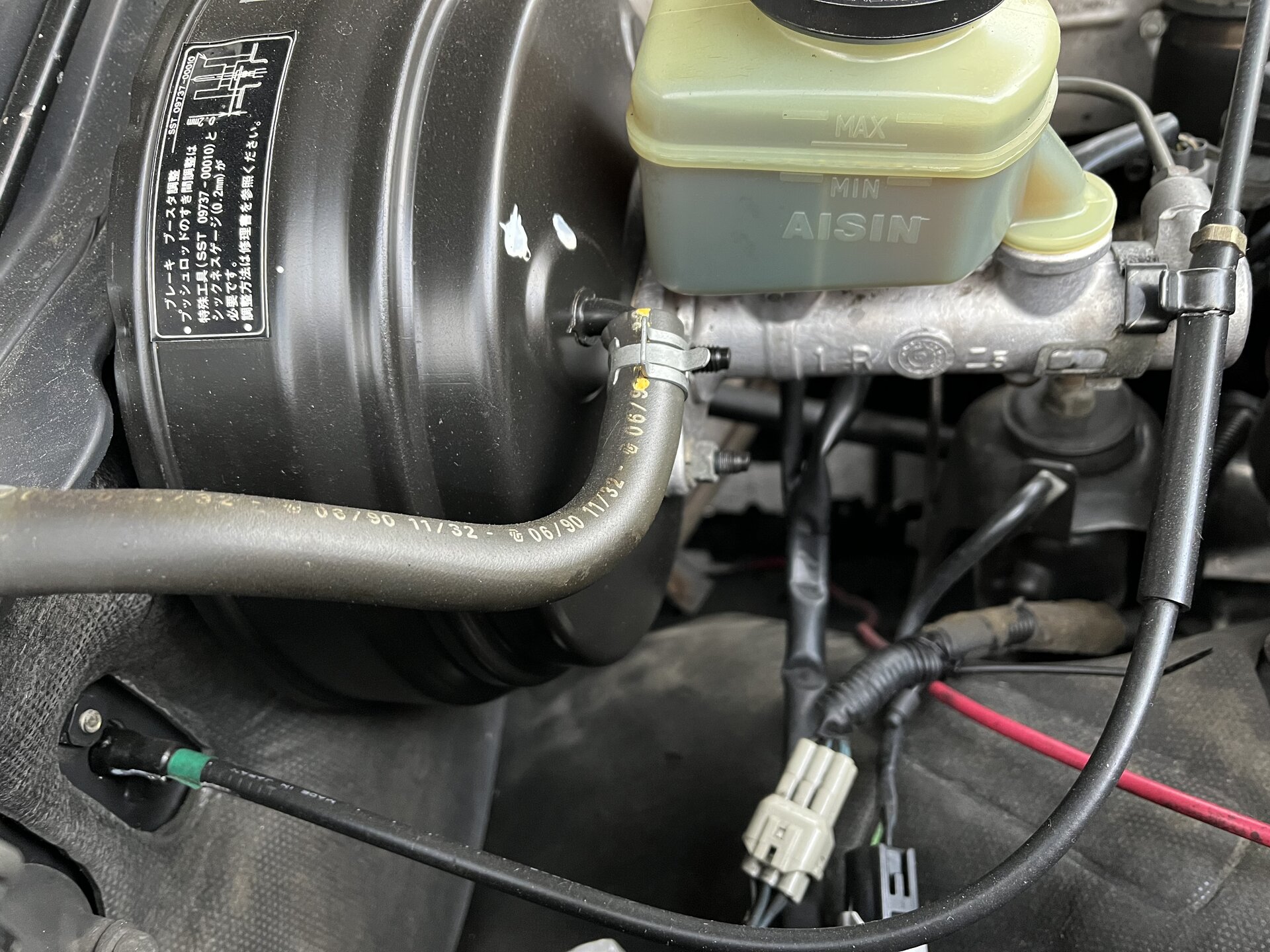

Here are the pictures of the engine bay…..
Any ideas where the “catch can” might be located. New to all of this, thank you for your replies.
No catch can there. A catch can would be plumbed in the hose that goes between the valve cover and the intake.

Does something suggest you need one?
If not done right, you have @franklin40 situation.
Unless you're trying to solve a problem, or trying to keep an intercooler core oil free, I would pass
No, just trying to get ahead of any problems that might show up at the worst time.
What problem are you anticipating a catch can solving? Its a pointless addition to that engine.
If you run an engine with the EGR that is operable, install a catch can. If you don't, then don't waste your money.
If you have no EGR but so much blow-by that you're worried about oiling up the intercooler, save the catch can money and put it towards a rebuild.

Excellent, thank you. Would it be worth installing a catch can?
No intercooler or egr system so I wouldn’t bother. Keep it simple.
