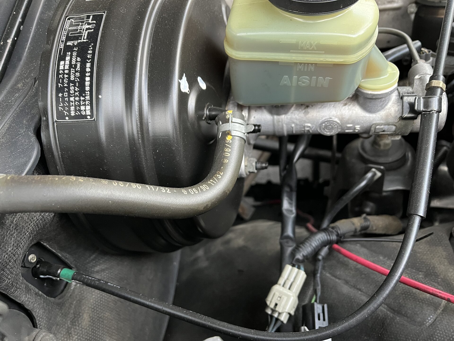

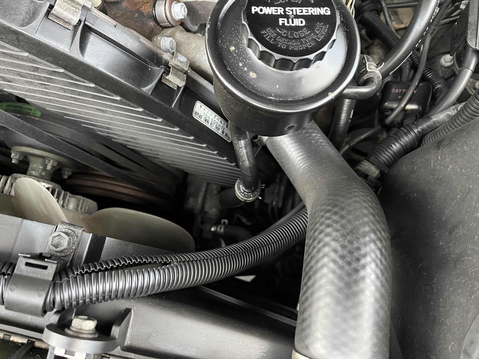

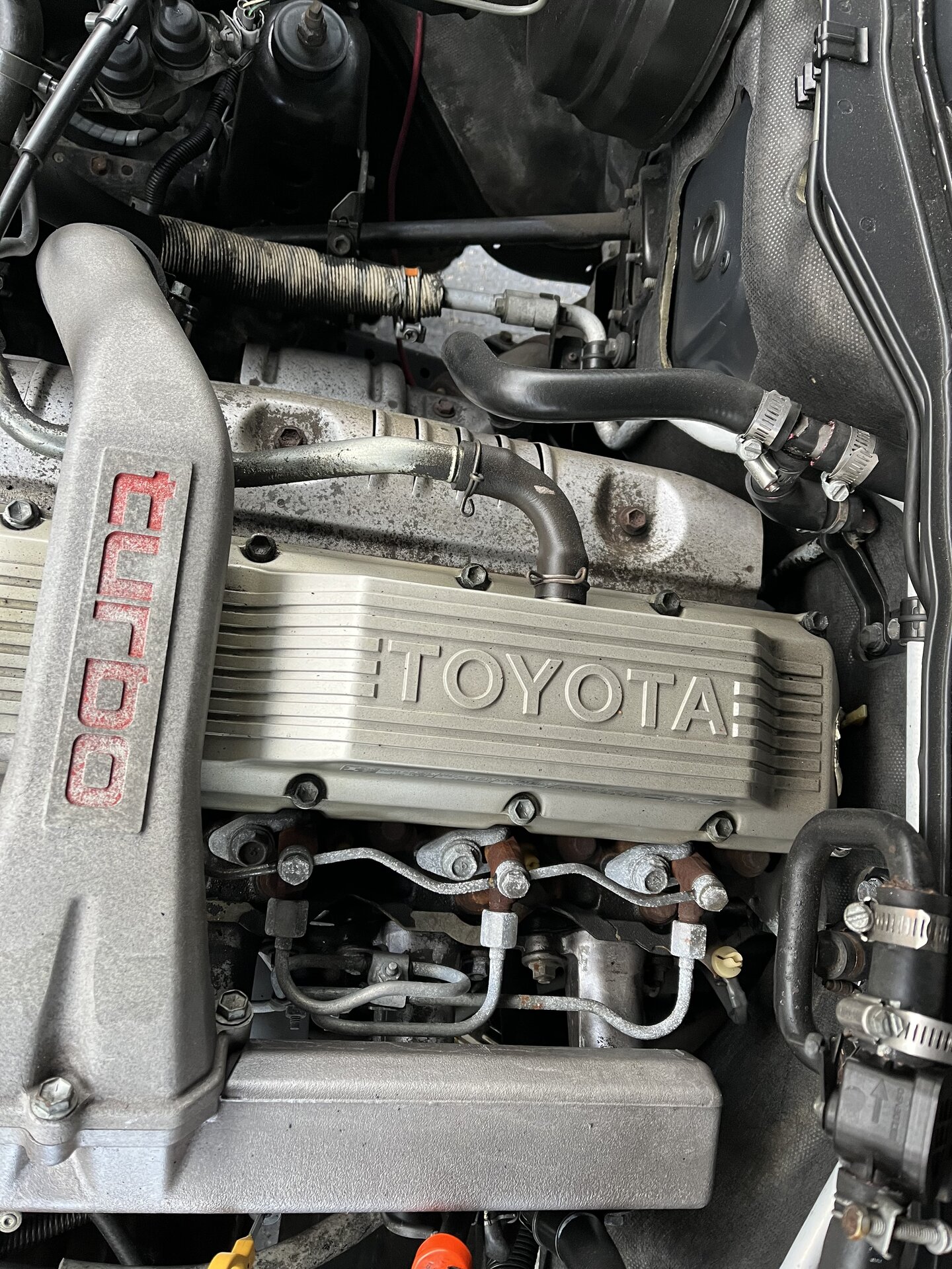

Here are the pictures of the engine bay…..
Any ideas where the “catch can” might be located. New to all of this, thank you for your replies.
