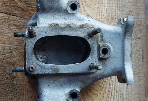

View attachment 3075155What is the hole in the carb for? I looks like it would have pulled vacume if the3 hole in the insulator was open. thanks for your reply
There is a hole drilled horizontally in the primary throttle bore that provides vacuum to the chamber with the hollow screw. The hollow screw provides vacuum to the power piston to keep it retracted during normal driving.
When you accelerate moderately and vacuum drops below ~7" or so, there is insufficient vaccum to keep the spring-loaded power piston retracted and it descends, opening the power valve directly below it.

the insulator has two holes and is what I am referring to. It also has the third hole which is sealed and would have lined up with the hole in the carb. Its about s/8 inch in diameter. It would supply vacuum if it was open. i will send pictures when I figure how how to do this.

I guess you answered that. no hole drilling as I thought. Just can't figure why the hole (about 5/8" and vertical) is in the carb.

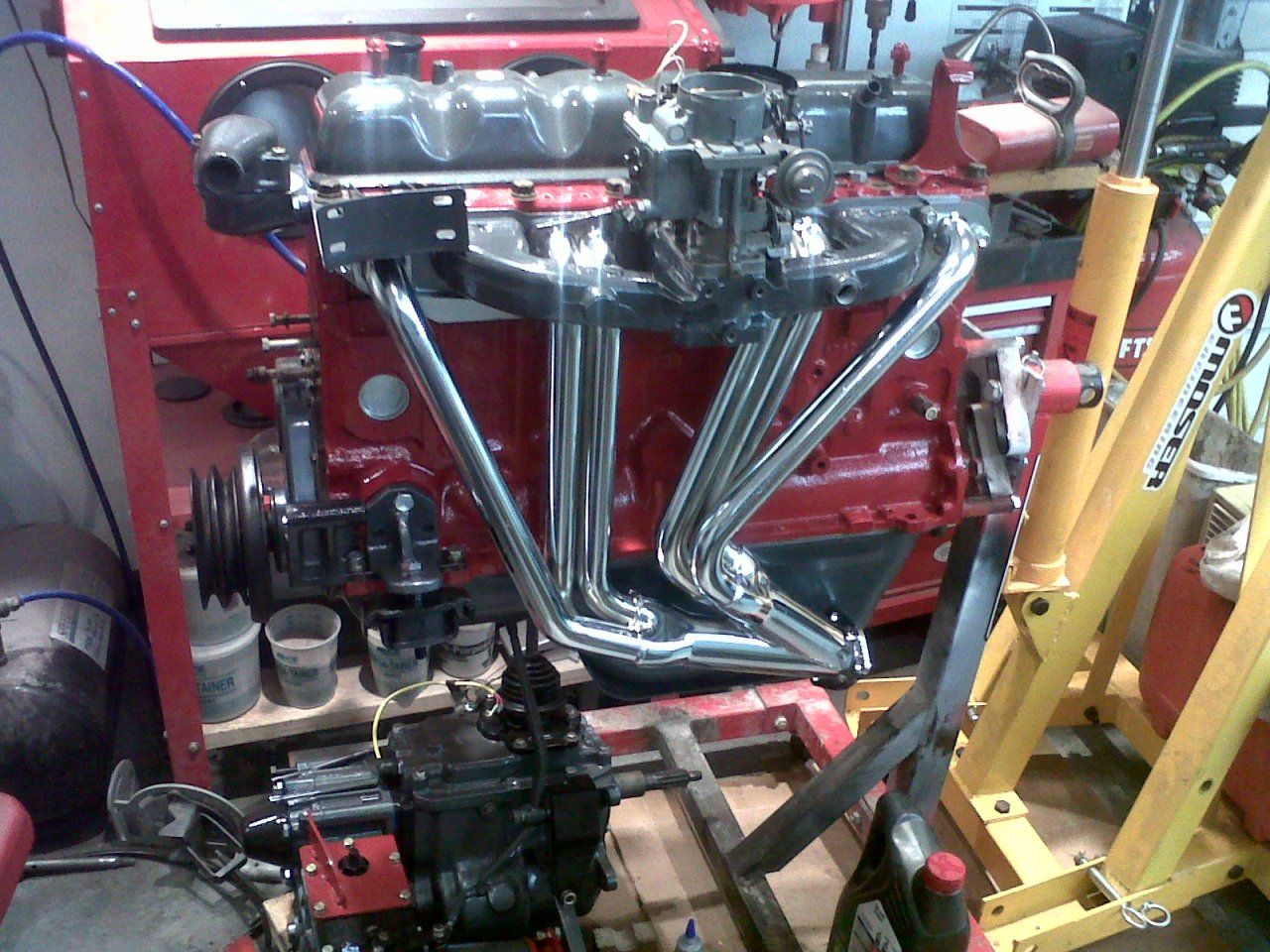

Hey there thats sweet looking!! I see your carb insulator gasket (just under the air filter and on top of the carb) is white those always seem to die early who made yours and where did you get it? Will it last longer then normal ones?

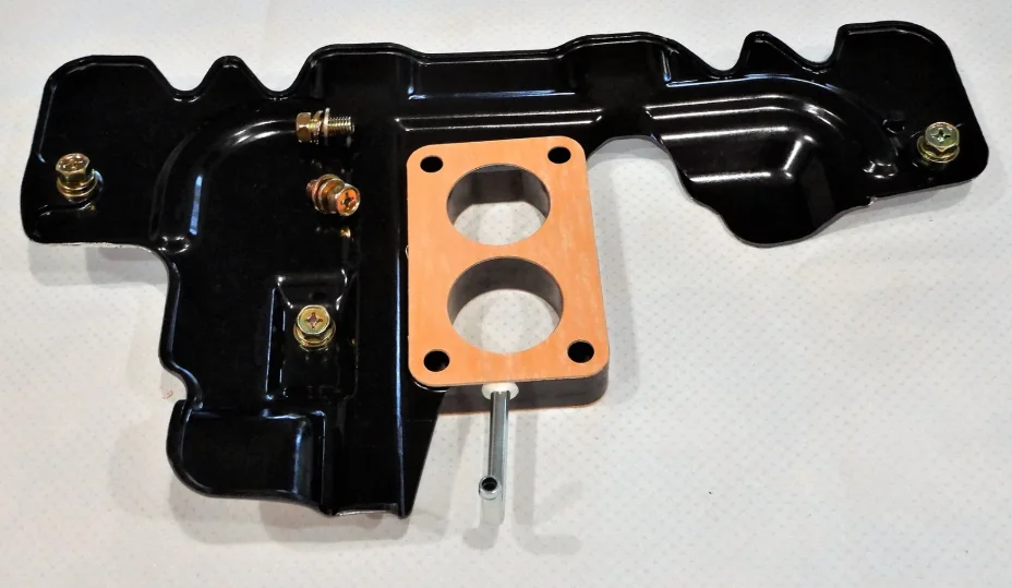

The extra hole in the gasket is because the gasket is also used in a DIFFERENT APPLICATION where a hole is needed. It is not needed on the Landcruiser carburetor.

Carb insulator should look something like this:
thats it exactly but with no seal for the carb. It has leakage of vac, so I think the only answer is a gasket even though you say we shouldn't need one. I did spray starter fluid around the base before removal and the rpm's increased. thanks for your help over my rebuild and also today. thanks to all the forum members for your replies. It;s a big help

It's not supposed to need one, but if it does, it does. Make sure all the original gasket material is sanded flat.
