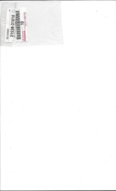

Here's the retainer clip I got from Toyota--should be the same for yours--

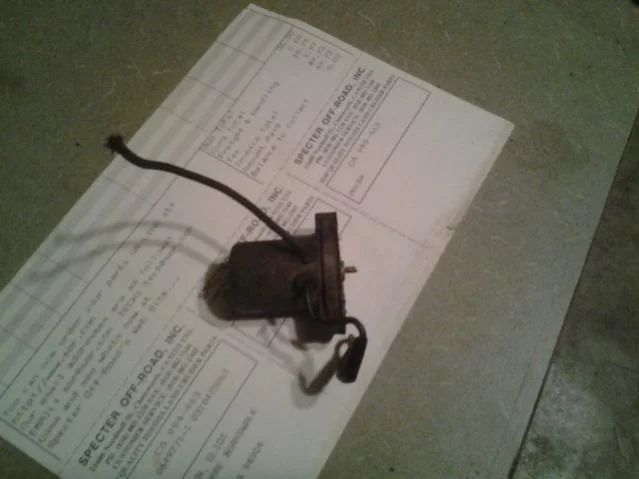

I attached pic of solenoid. It is the retaining clip, not the pump spring
The tip on the solenoid is about a 1/4" long. Not sure how long it should be.
Is that retainer shaped kinda like a capital G? Man, if that is the clip I will be a happy man...
Thats fantastic news... just go to dealership or do they have a website for old parts? I appreciTe all your help gents.

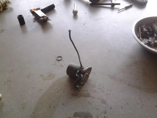

It is at an angle
If it's cut, you might as well cut it off completely. Then you don't have to worry about wiring it. Hopefully your rebuild solves the problem.

Got the clip from toyota today. $4 out the door. Was just a little big, just had to cut a very small piece off and went in. Got it all back in and assembled. Hope tomorrow is a happy day...
