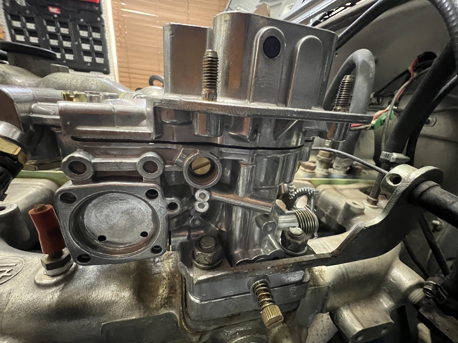

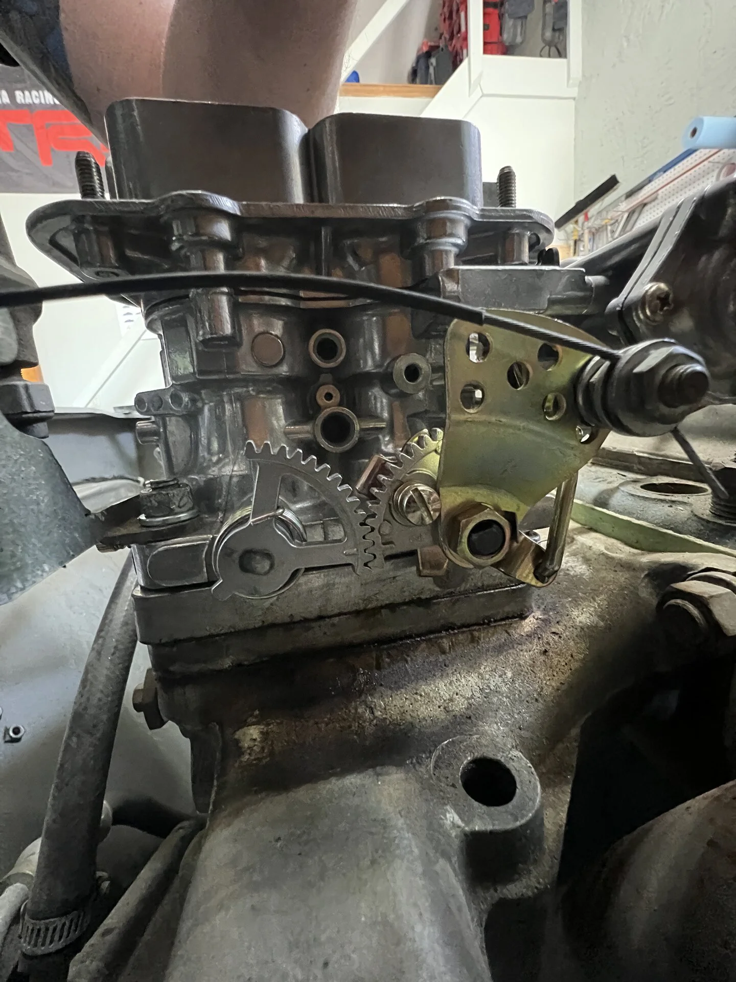

I’ve had my ‘76 almost a month and I’ve gone over the ignition system, discovered a faulty coil, replaced plugs and am now setting my sites on the carb. My 40 has been running great warm but I noticed it really struggles idling cold. Upon further inspection, the electric choke does not appear to be functioning. The carb looks like a Weber, but I can’t find a brand or part number anywhere on the body or casting. Is there a way to verify/authenticate what I have? It runs and drives right now, but I’d love to get it really dialed in. If this carb is an EBay special, I’ll happily punt it and start over.
Also - the throttle is cable driven. Looking at other parts, it seems like the ‘76 originally had a rod driven carb and gas pedal, so this may have been swapped somewhere along the way. I’m not looking for a concourse restoration or anything, just piecing together the history here.

Awesome advice all around - thanks all! I suspected it was a clone and the lacking of branding anywhere on the casting seems to confirm it. I don't believe that the automatic choke is working at all right now, I'll test voltage and confirm. Has anyone had great luck running one of these clones? I'm not opposed to replacing it for the genuine article if improves my odds of a working carburator.
Lots of reasons… to name a few… no weber embossed logo on the top plate … nor serial number stamp… certified weber dealers have a tag on the first bolt near the fuel inlet
They do not come shiny… they are a dull metal

The Chinese carbs are notorious for metal shavings in the carb bowl … mostly on the toyota copy carbs

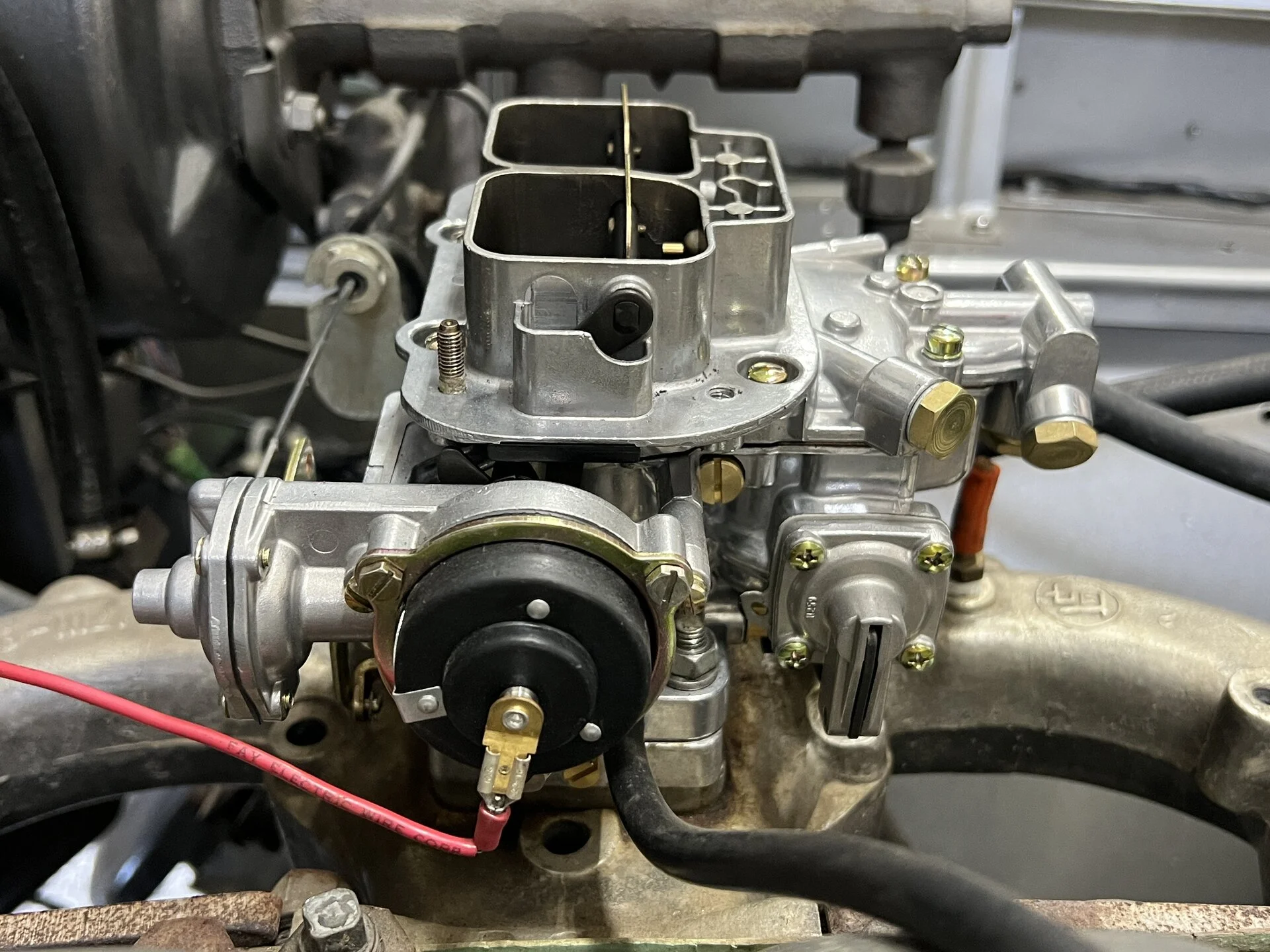

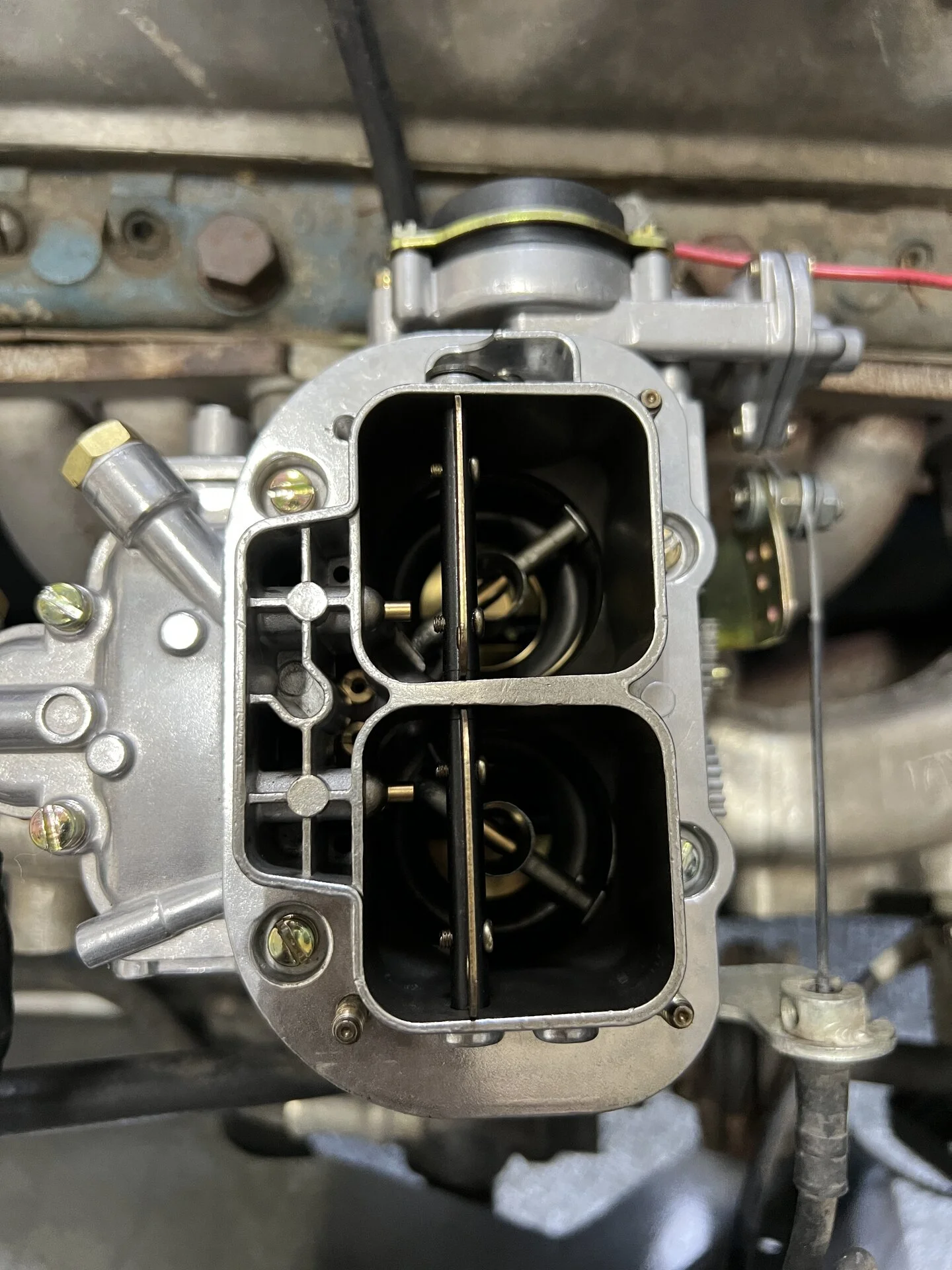

Following up: I removed the Chinese Weber clone and replaced it with the real deal Weber carb. I also reran the fuel line to go from the electric pump to the regulator (it had previously been connected to a mechanical pump inline with the electric). I removed the mechanical pump and installed a block-off plate.
Night and day difference. In addition to a functioning choke, my LC cold starts, idles and runs sooo much better. I also discovered a few other shortcuts taken previously regarding venting and vacuum plugs that I was able to correct. It’s a different truck.
Now I just need to make up some more excuses to go drive it around.
The photo shows the real Weber carb, which is identical to the knock-off except for the color of the metal and casting stamps from Weber (exactly what JohnnyC mentioned above).The spacers and gaskets included were higher quality, but identical in shape.

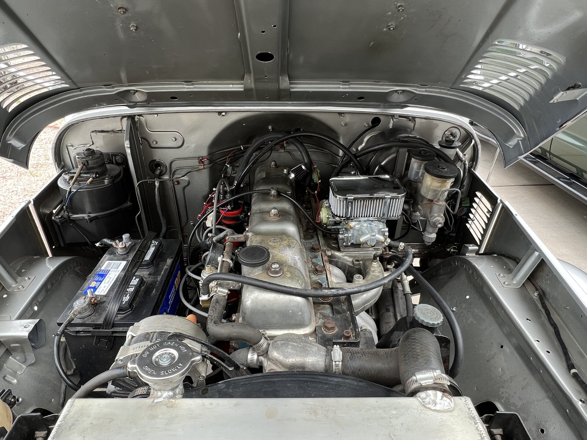

Webers run at like 3 to 5 psi. Make sure you add a fuel pump pressure regulator in line between the pump and the carb. Without it is almost impossible to tune. Go to reblineweber website. They have all the tuning instructions
Thanks, I appreciate it! I do have a regulator and gauge on there - you can just see the top of it left of the oil filler cap. It's getting a steady 3 PSI.
