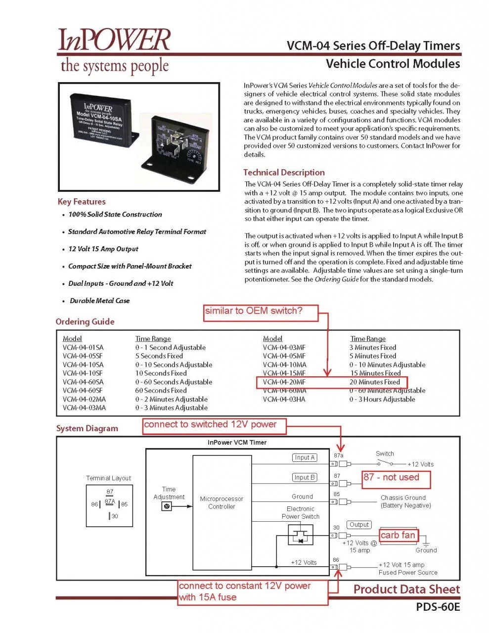

A while back I read a post where someone had a carb fan fix using off the shelf parts to replace the carb fan sensor and thermostat. I purchased the parts and stowed them in a box for "later". Now that I want to install them I can't find the post. Tried searching any carb fan posts I could find. Any leads? The box was from Rockauto and contains a thermostat with a probe and a 5 pin relay.
Thanks, I will go through that. Here's the switch I bought from the post
Mine has the fan and factory plugs just no sensor as far as I can see
Here was my solution to installing an OEM Carb Cooling fan, but with a non OEM electrical setup.
I remember reading that. Good information. But having purchased my parts in 2020 I'm hoping to find the post that inspired me to buy the part I did. Should have printed the thing
