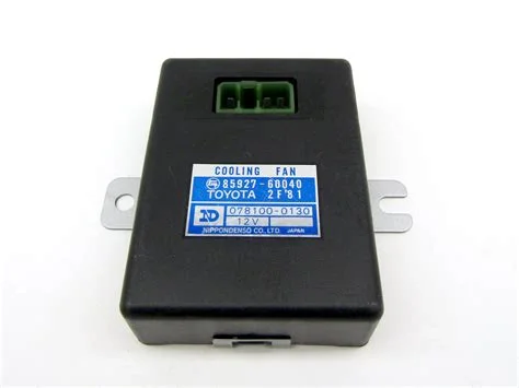

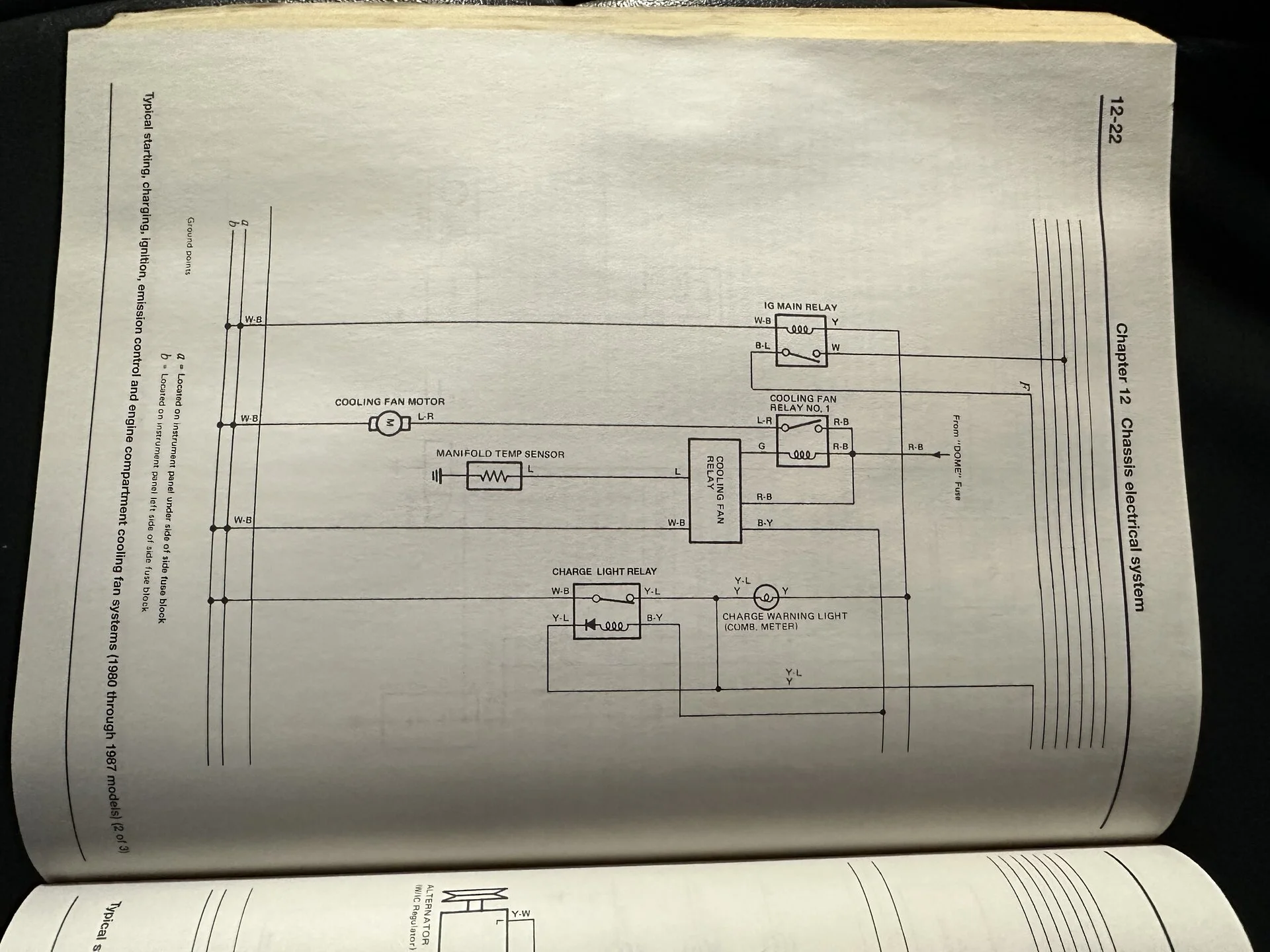

I checked my haynes manual but I didn’t find a diagram for the carb fan. Is the relay one of those metallic can looking ones or is it a box shape? And the temp sensor, what does that look like?
For 1988-1990, at the bottom of page 12-39 in the Haynes 92056 1980-1996, FJ60, 62, 80, FZJ80 book, you will find the diagram for the cooling fan circuit. For 1980-1987 it's on page 12-22.
I'll try and get some pics and post 'em.
Ok thanks a lot I’ll check that. Just got the little one down for a nap, going to mess with it now.
So I started by looking at the diagram in the haynes manual but I still didn’t understand what the relay looked like. Here’s a picture for future reference in case anyone comes across this thread with a common issue:

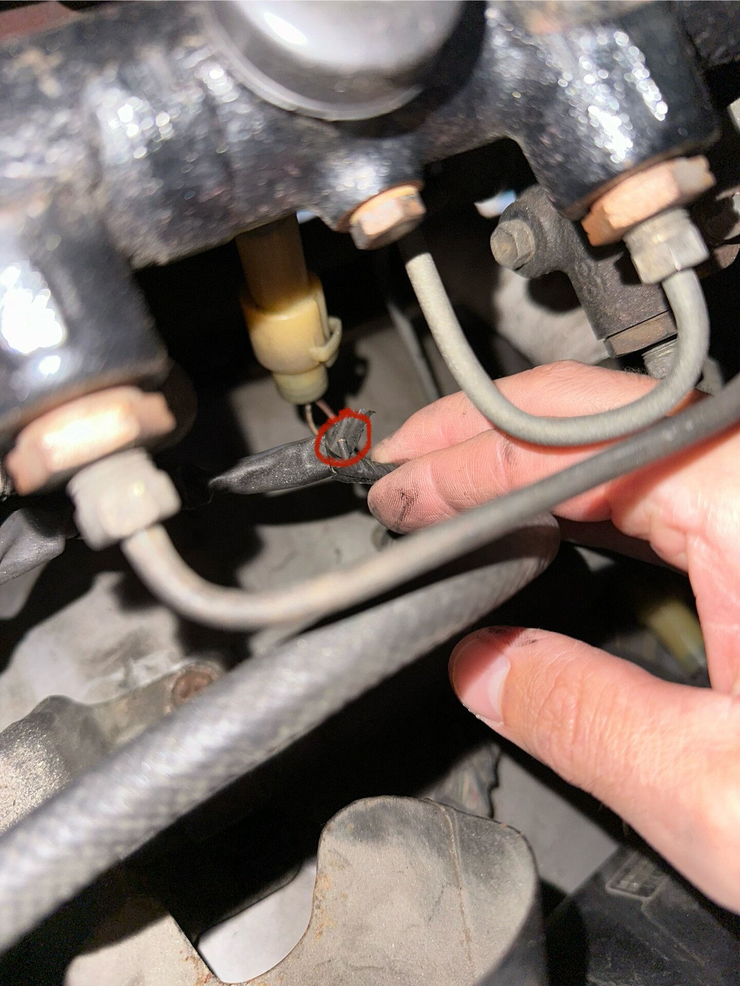

For my smooth brain, it was easier to follow wires from the fan, and sure enough there was a severed wire. The mechanic likely jostled the wire harness around just right so that it was rubbing up against some sort of ground and intermittently making the cooling fan work (bad contact also explains the clicking type noise in the video above).

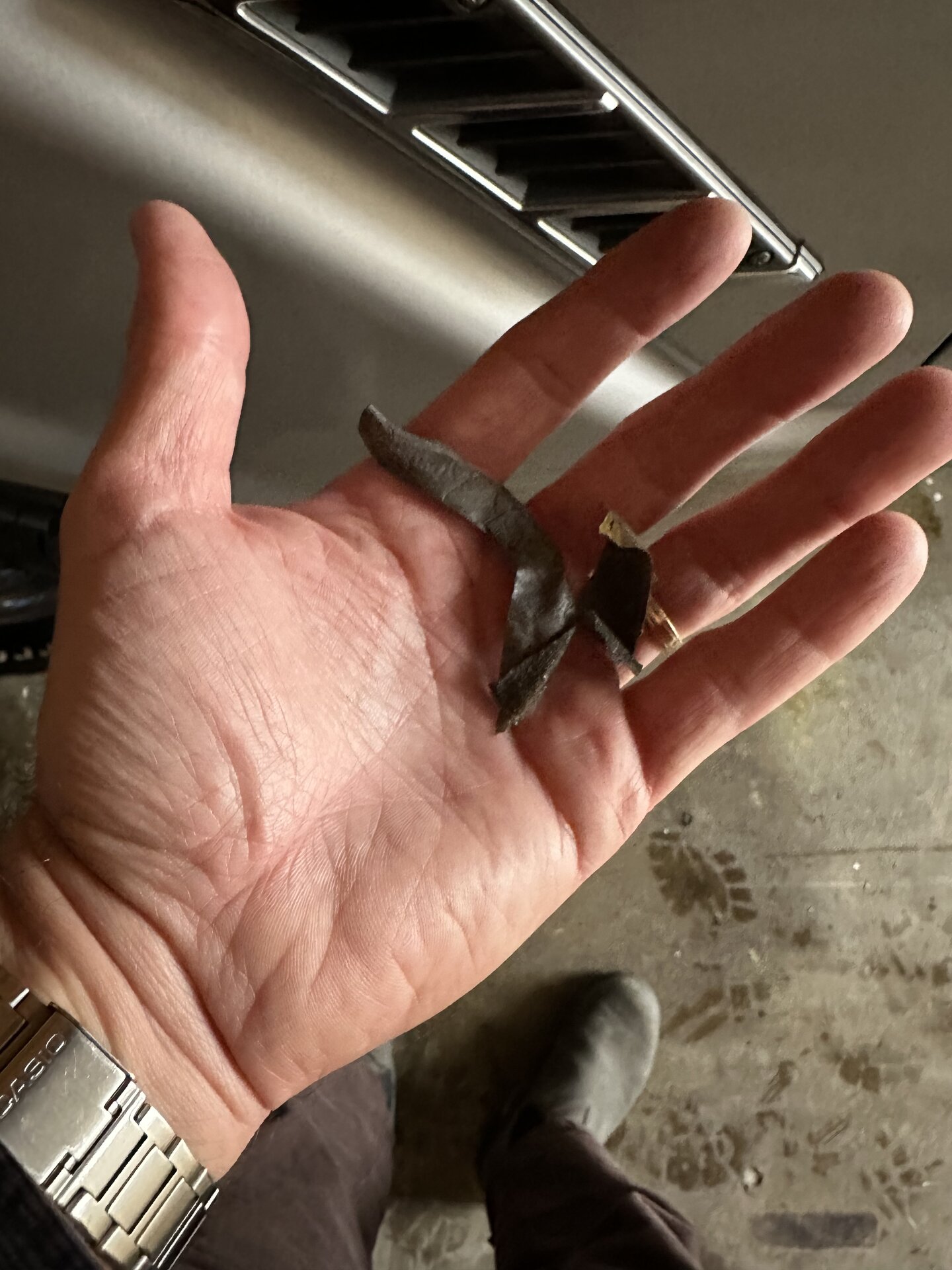

I think this is the wire that is intended to go to the manifold temp sensor, but I read a few other threads on here that suggested it is fine to just ground the wire as the fan has an automatic cutoff ~20 to 30 minutes after turning off the vehicle. I opted to do that instead and the fan started blowing nicely, however there was still some crackling noise near the vent on the front fender. I pulled that off and cleaned the chute which had some electrical tape flapping around in it:
30 minutes later on the dot my fan shut off. Excited to see if this helps my hot starts, which always seem to take a little bit of extra effort.
