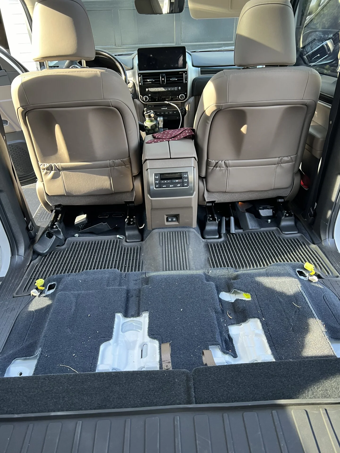

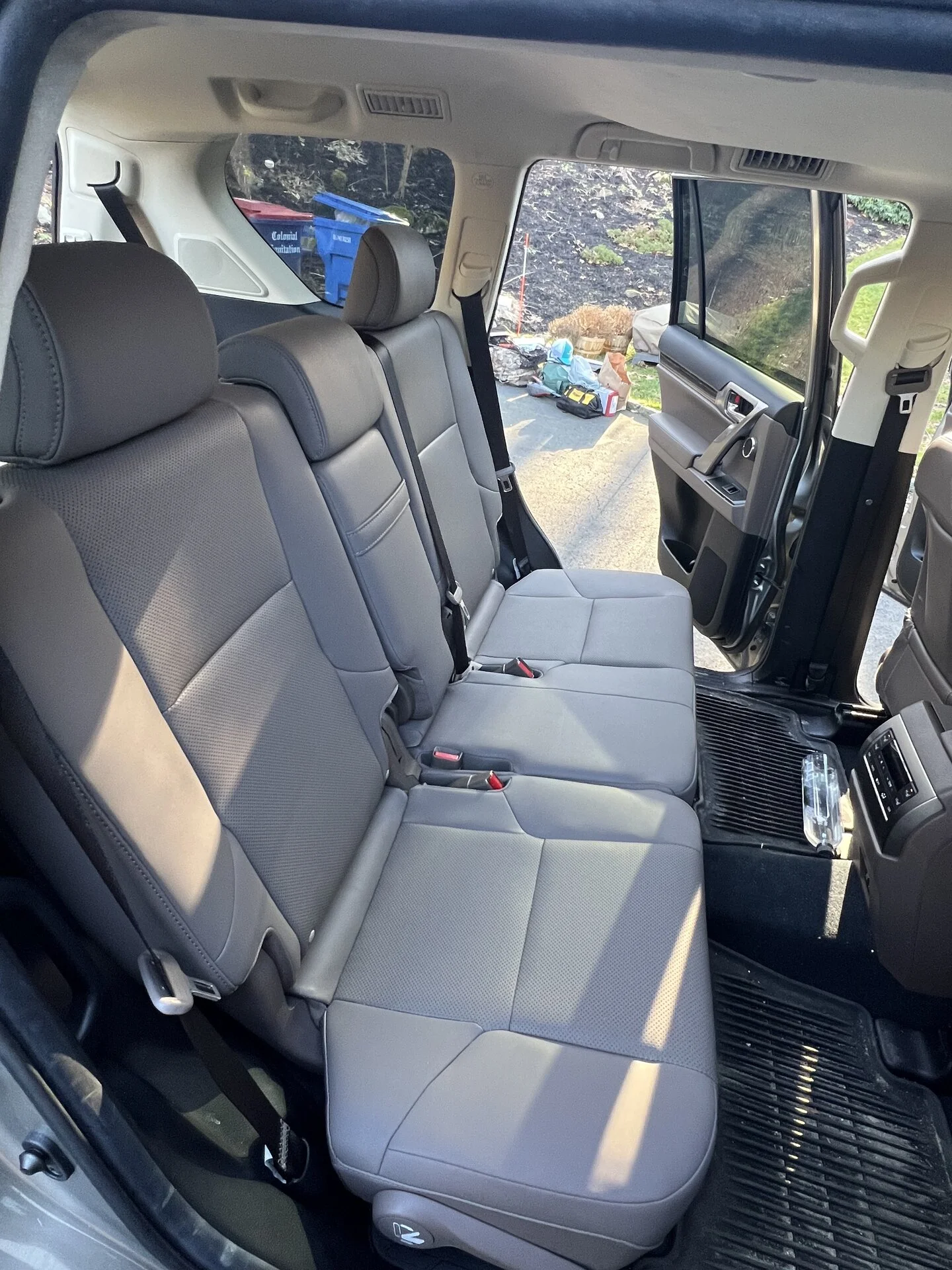

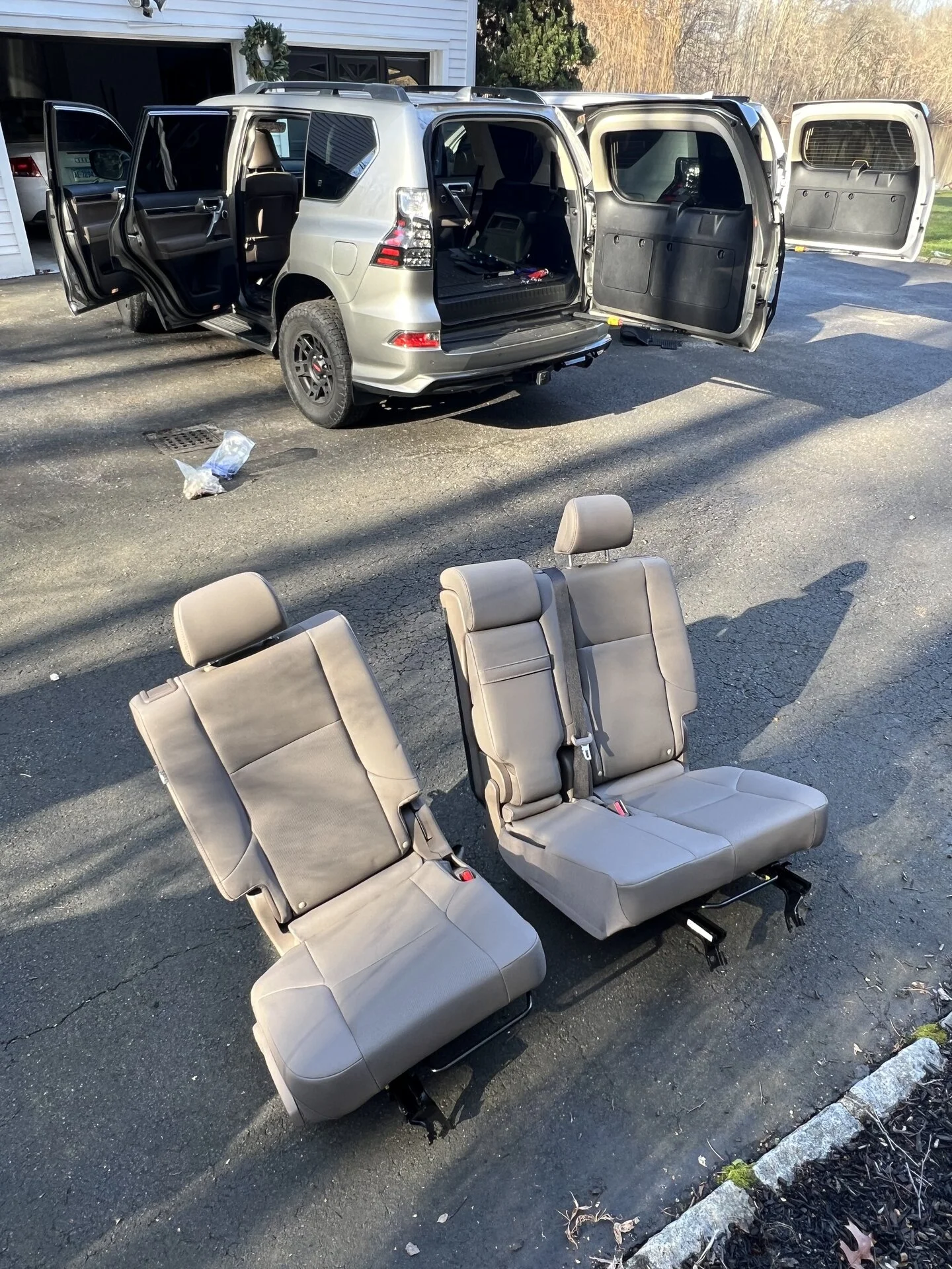

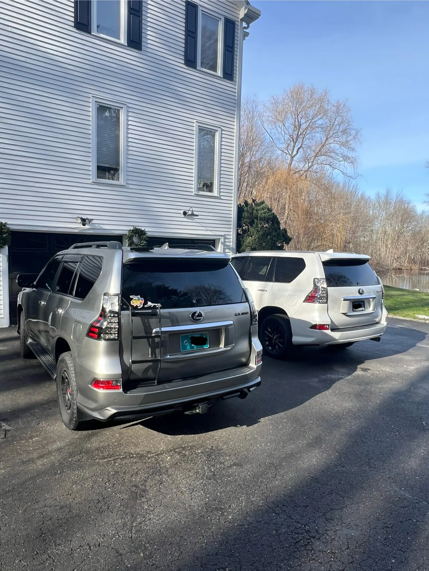

After months of searching and planning, I finally
got around to a fellow GXer on my road trip who wanted my captains for his bench. It is LITERALLY plug and play, nearly everything is identical. Just 14mm bolts, plastic removal tools and a couple plugs. Took us about an hour and a half on both trucks. The only thing that needs to be noted is the plastic trimming that covers the rails NEEDS to be swapped along with the seats. The plastic retaining clips line up with the bolt pattern on each seat. Also, shoutout to GX Bob’s video, which is essentially the process.
This is awesome! I have been pondering this as well. My 2013 has the bench and my wife’s 2020 has captains, I would to switch hers over to the bench.
It’s super simple! Just make sure when you do the swap, either both have either heated or non-heated. I’m sure it’s still no issue if the other person doesn’t care to lose the feature, would probably just have to zip tie that connector somewhere.
