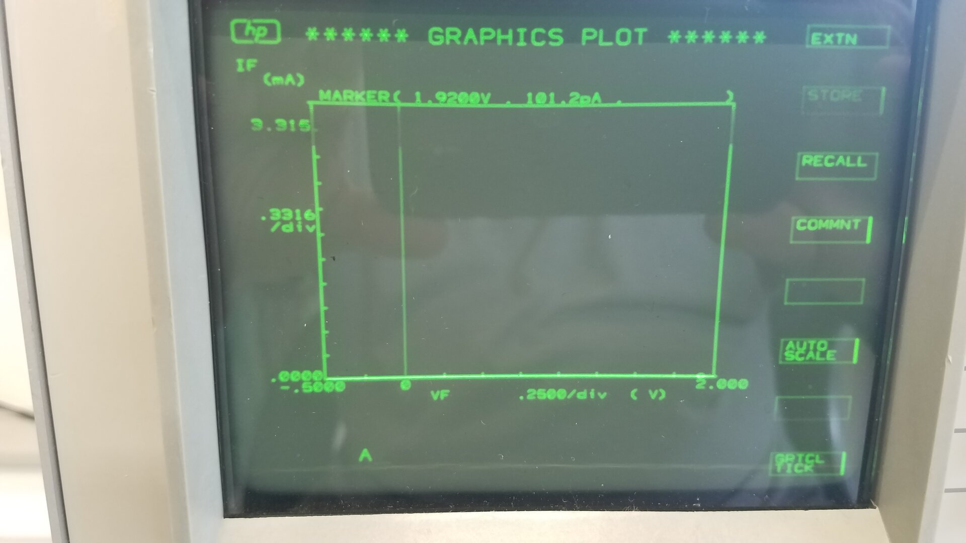

Working on a 08600-00014 radio today. The first check on these is to see if the output transistors get hot. Well, these did. Took it apart to check the bias diodes.
first diode (drifted way out of spec):
second diode (open):
Good diode:
