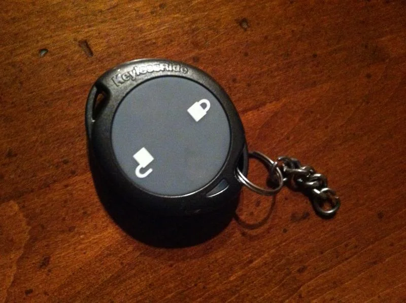

Tried programing the new remote again and still nothing. I happened to remember where the OEM remote was and it would not work either.
Then tried programing the OEM and it worked!
Next tried the new remote again and it worked as well!
It seems that I was waiting too long to push the program button on the remote. It needs to be pushed as soon as the remote indicator light comes on. The ignition
needs to be turned off and door closed before the remote will work.
This thread helped me and hope this info helps!
Here is a photo of the new remote:
