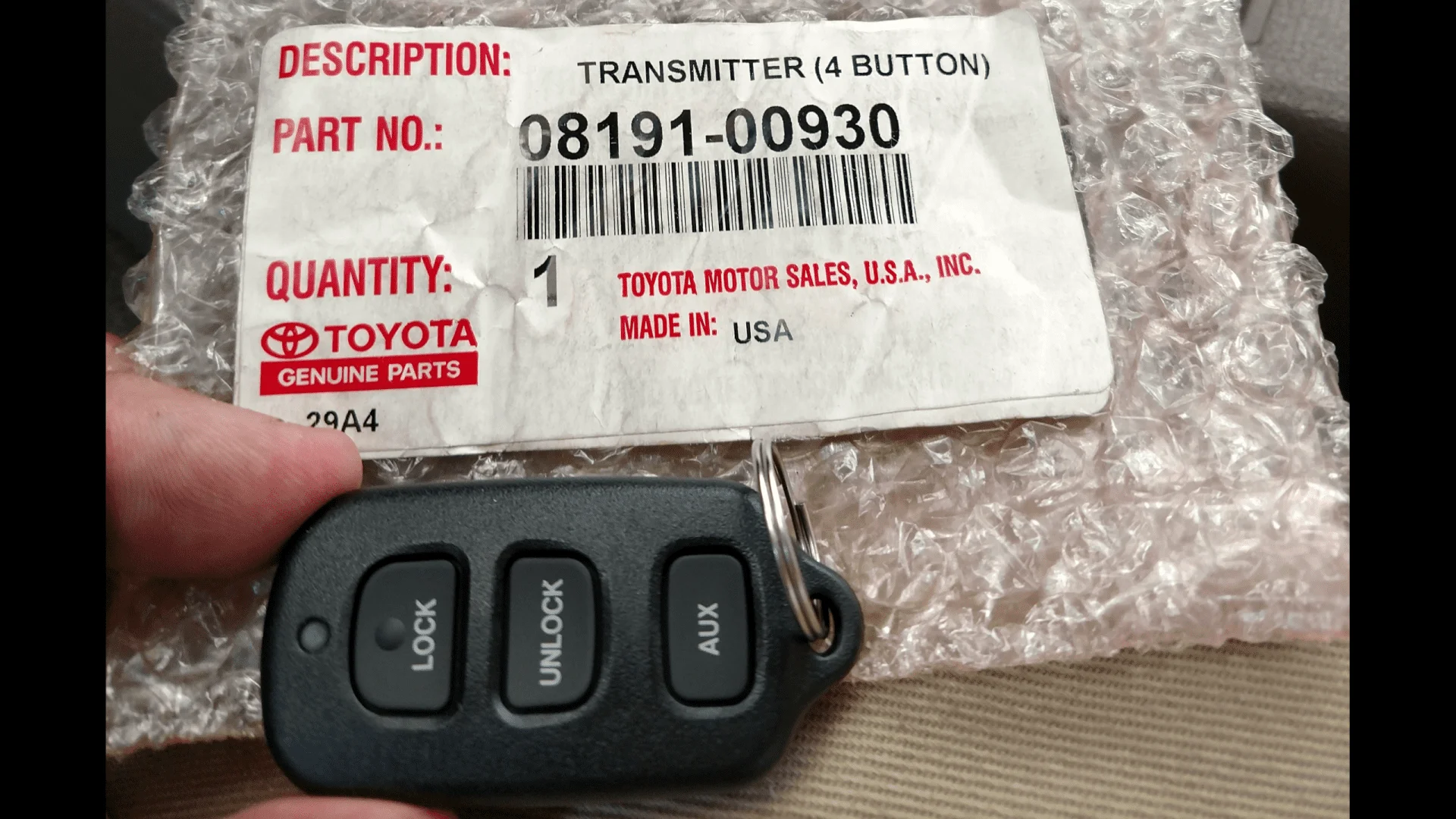

I just came from the dealer. They swore toyota 08191-00930 would work. It won't program. I got my hopes up when I saw a durable modern remote.

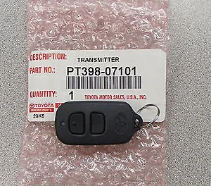

Wrong one, this one works w/ one button to lock/unlock.
PT398-07101
Sorry if this is a dumb question, but do you mean that there is one button which is used to both lock and unlock, or that each function has its own button? My generic eBay remote has only button, which is irritating because I'm always cycling the locks and I feel like I'm putting undue wear on them. I'd like to have a remote with two separate buttons, one for lock and one for unlock.
Thanks for posting up the picture with the remote.
I have the same remote for my 1997 80 series just a slightly different part number.
Yes the top button works for lock and unlock
