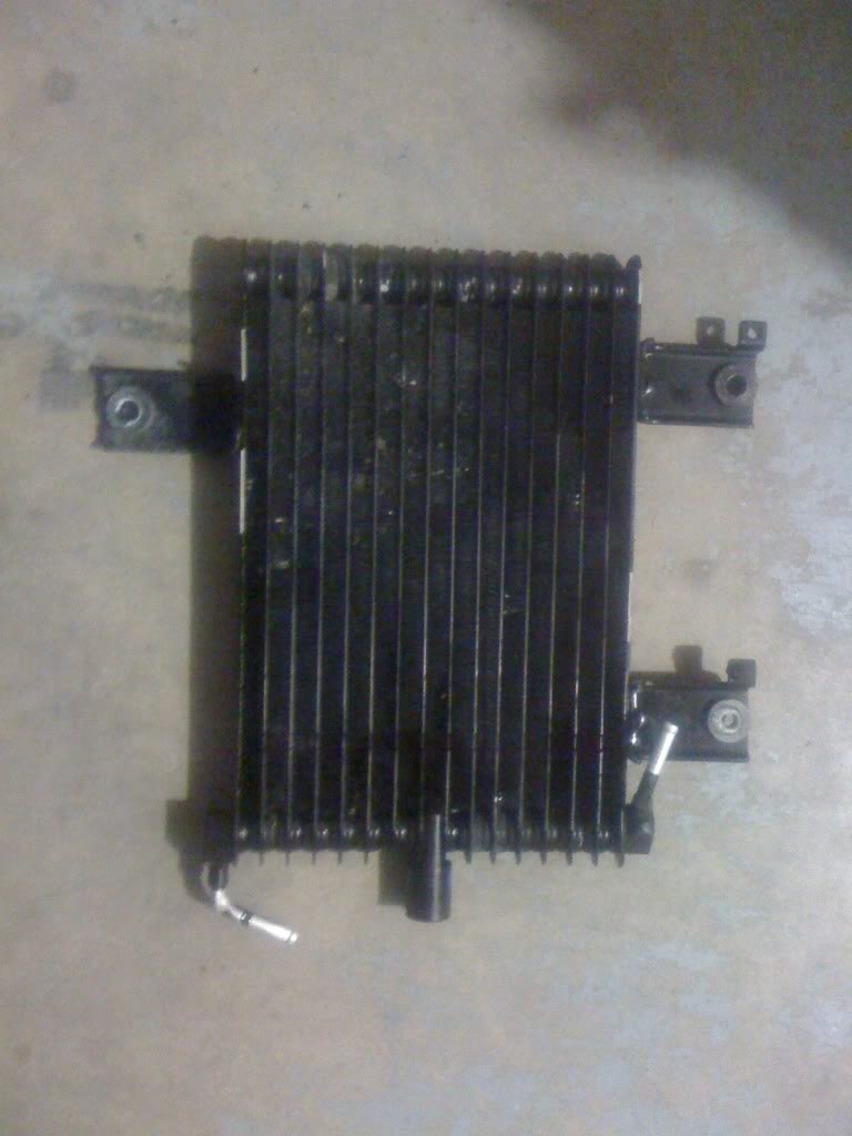

A 8x10x1 oil cooler from a 2011 Nissan Titan (front end hit, cooler was slightly bent. Put it on the ground stepped on it and now it's straight again and still holds oil):

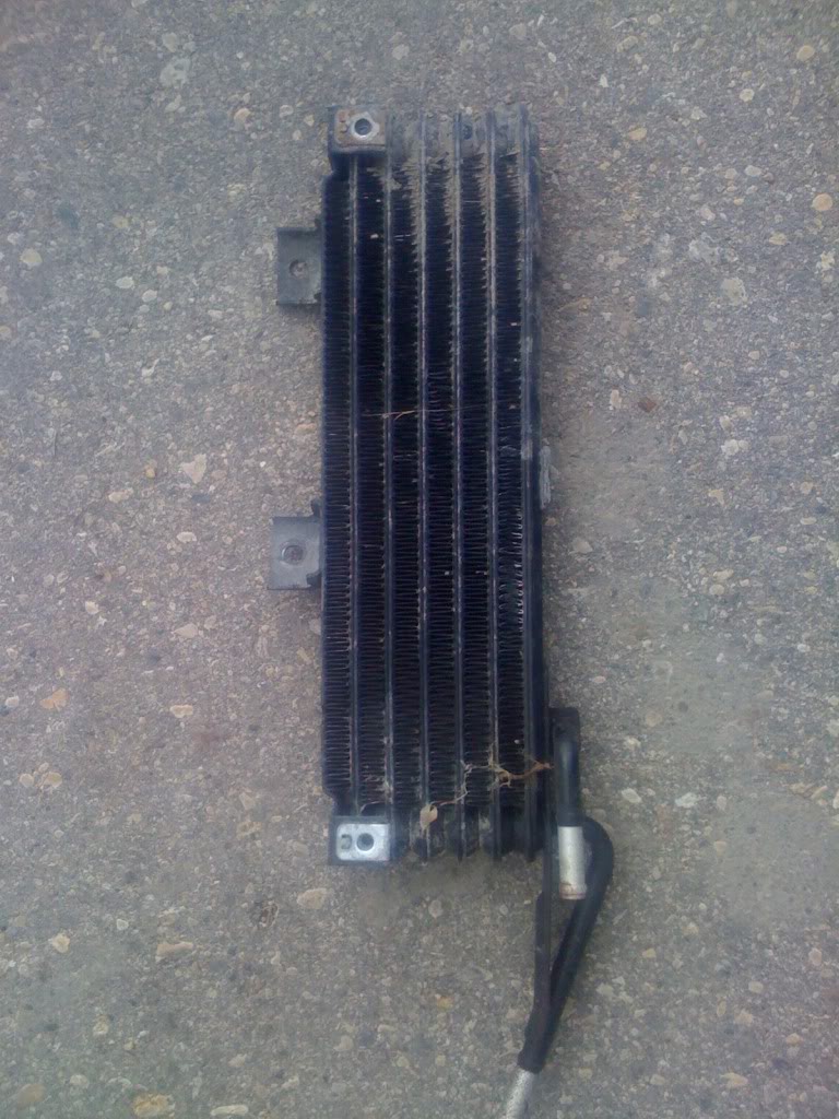

A 10x4x2 power steering cooler from a Toyota (not sure what model with no visible damage):

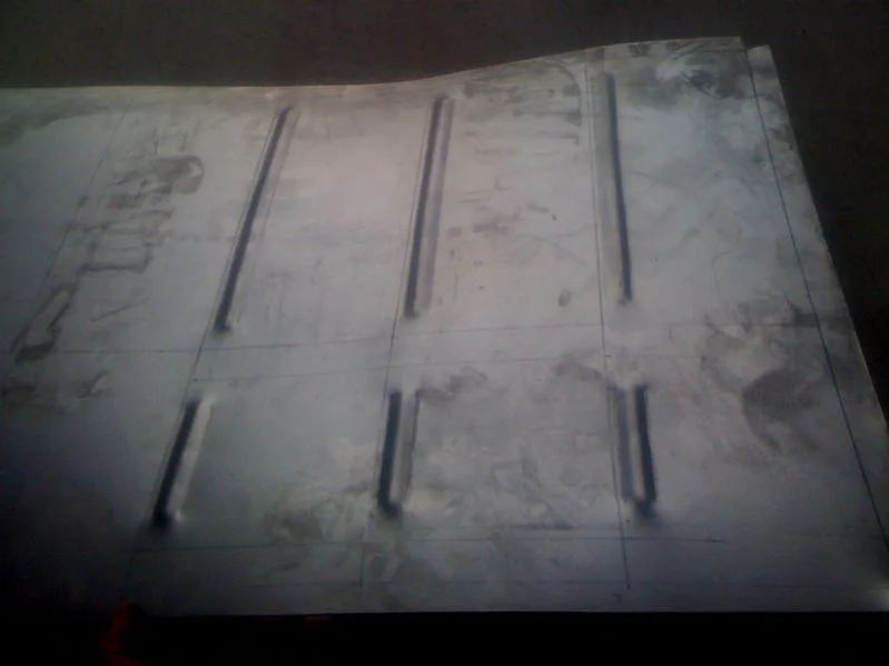

Here's a picture of one of my wheel wells before I bead roll it and bend it into place (nothing special just thought I'd share):

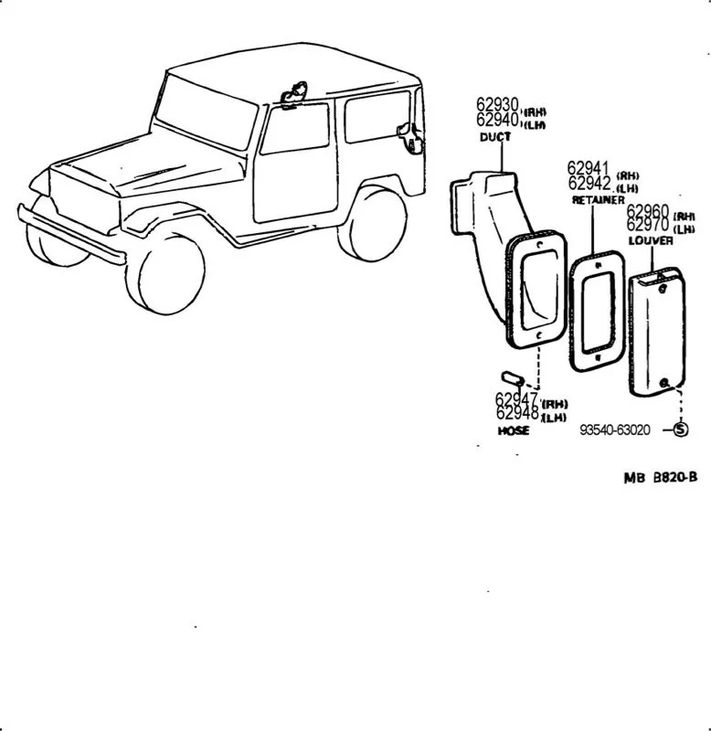

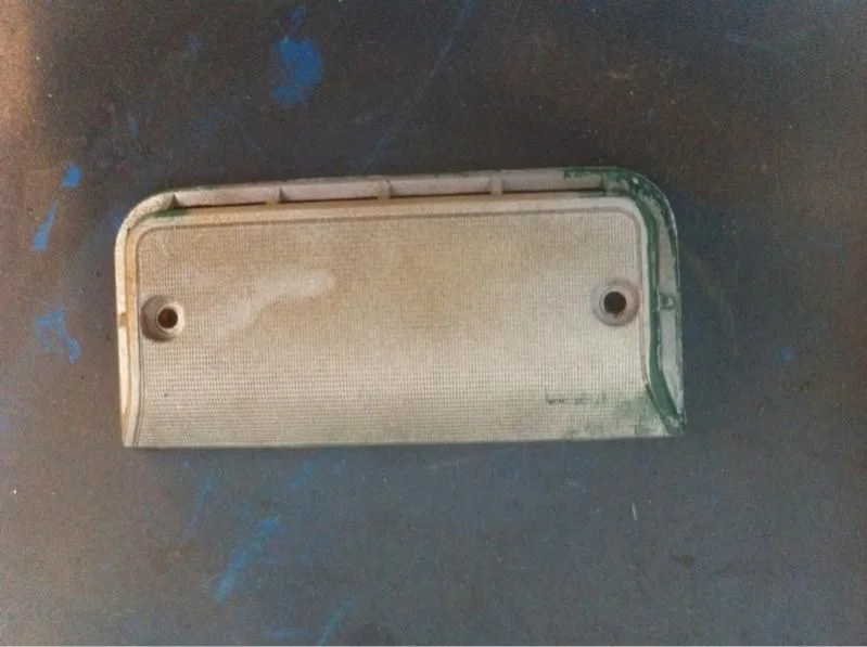

Sorry to jump in your thread but I have a quick question . I have a 1984 Canadian bj42 it has the same air vents on the hardtop that yours has in your first photos do you have any idea where I can get one of those mine is broken . Just the outside cover part ? Thanks for your help
I can't see where that goes but I'm sure a dealership would have it.
It goes vertically on the side roof panel under the pop-out rear vent window about 3" from the bottom lip of the roof with the opening facing aft.
Here's the diagram showing those vents. It should be around $25 per side. (The part number on the diagram is only part of what Toyota needs. But those are the last digits)
Good luck
Try Cruiser Dan at American Toyota in Albuquerque. He is a Cruiser guy and has the fiche for most regions too.

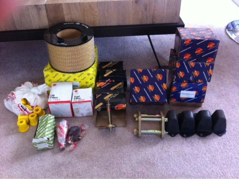

Just got my first round of parts. Super pumped to start working on it again!!!

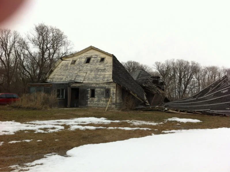

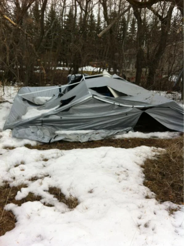

Now all I have to do is dig out the truck from the collapsed car tent and snow.
So I went to go make a path to pull my land cruiser closer to my in-laws house and here's what I find.
Oh we'll, this is where it was before that.
Good luck
The Dealer has had them for like $30 each(or pair)
I've seen billet ones made that won't break if you look at them cross.

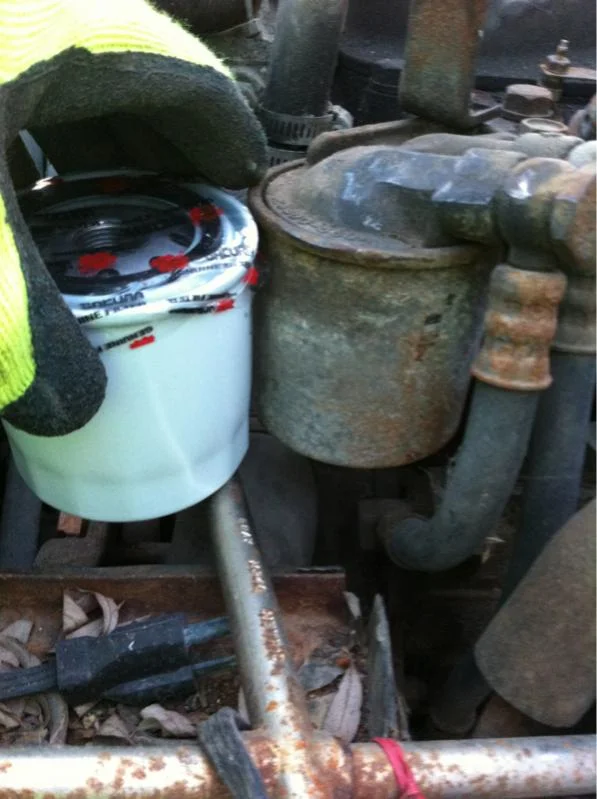

So I bought a filter kit (oil, fuel, air) and the spot where the fuel filter goes looked like a housing for a paper style filter. So I compared the one I bought with it and I don't think this thing has ever been changed. I took a big set of channel lock pliers and it took 25 minutes of grabbing it in different spots and crushing sections to loosen it. Yikes.
