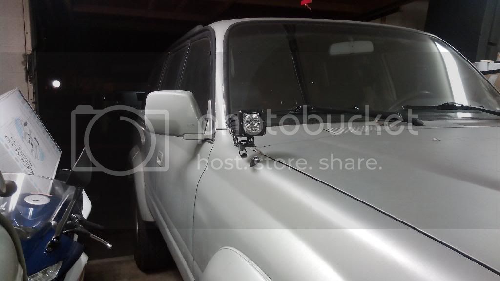

I went to go visit SOCAL at his work. He has tons of stuff available to him. He showed me a few things he was working on and sent a few images today. I think he is on the right track.

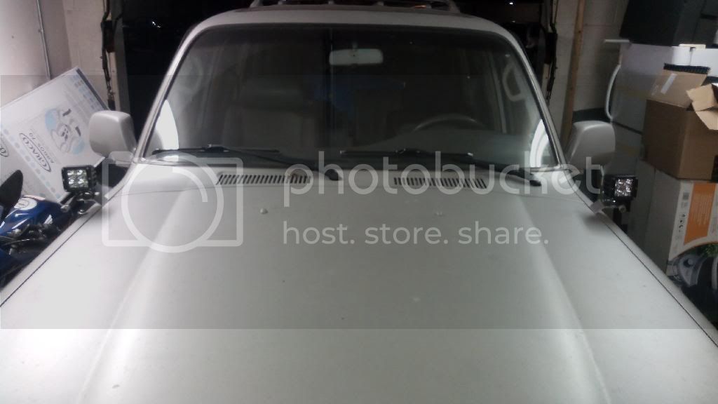

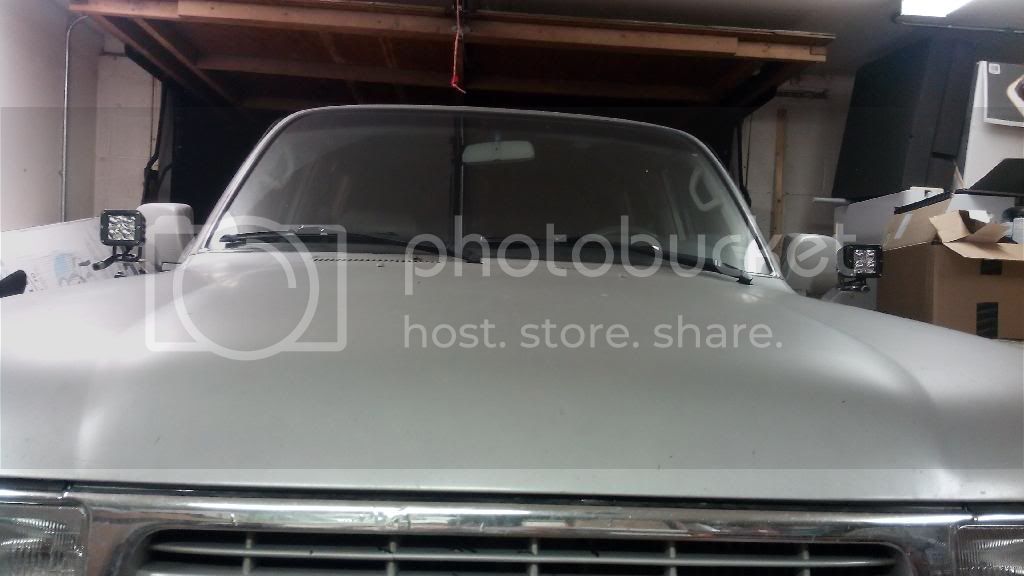

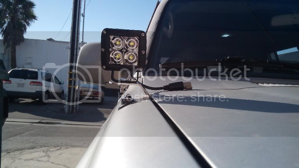

This bracket is made for the smaller 3-4" lights, mounted are the Rigid 3"
Again, this is still a rough draft, I still want to refine it a bit more. I was able to test out the side brackets today driving really rough alley ways,
it seems to hold up fine with minimal vibration, but it's also hard to pay attention when I'm driving in narrow alleys behind warehouses. There a re a lot of people there so I couldn't keep my eyes on the light, I will be testing it on the freeway in the morning. Video to come.

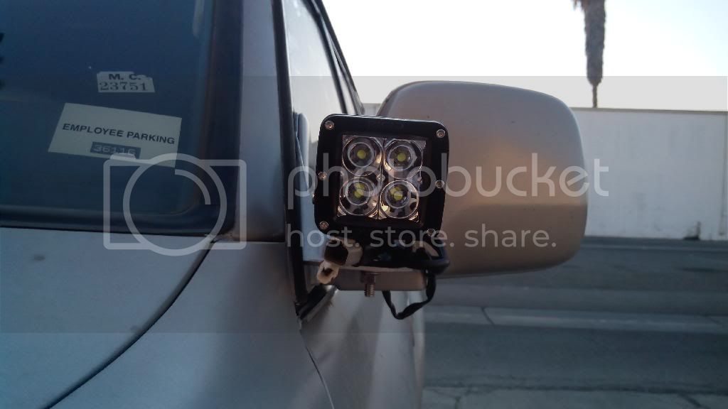

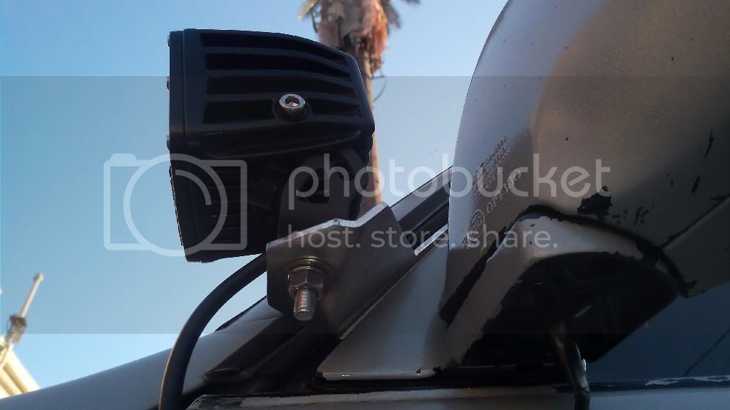

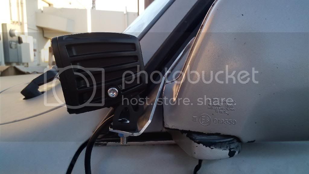

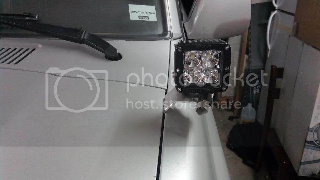

Alright, last week was hell but finally had a chance to work on the new bracket.
This mounts onto the mirror, adjusting the lights is just an arms' reach away.
It is very solid, you shouldn't have to worry about doing 90mph or using it on rough terrains.
This is a rough draft i whipped up today, you can still fold your mirror as seen in the photos, the wiring can go into the mirror and down into the door panel.
Putting your new light bracket on is a breeze, you only need a 10mm socket to take off the mirror, put bracket on and tighten.
I'm going to refine it a bit more and the CNC cuts will be perfect, I'm going to make the base 1" bigger and also 1'' longer so you can mount a second light from the bottom side if you wish to. Still deciding which type of finish I want to go with, but I will have to look into prices for powder coating, anodizing, or using Matthews Paint.
This is only a thought, I have to test it out to see what the extra weight will do.
I like that, simple and solid. Wondering about the glare, have you turned them on yet?
