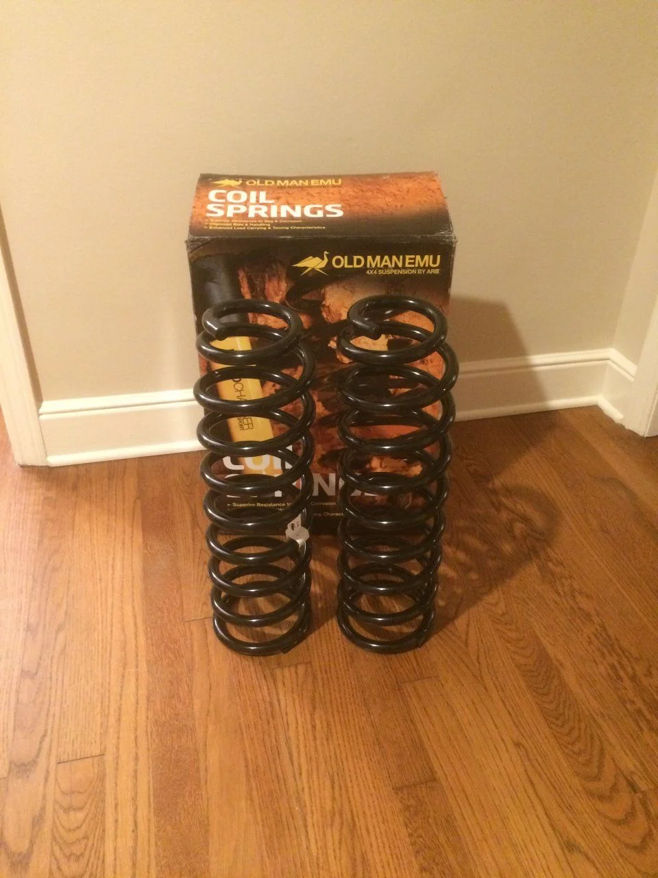

A big thanks to JT for the rear springs and to Fergie for dropping them off at 901-Hybrids Monday...

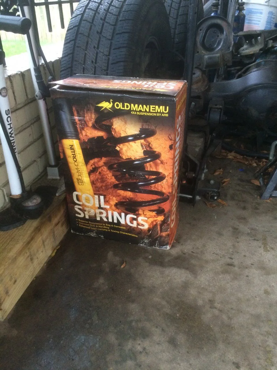

And then today, Brown Santa dropped a package down the chimney ...
I'm going to try OME 850J's up front and 863's in the back for the initial testing.
