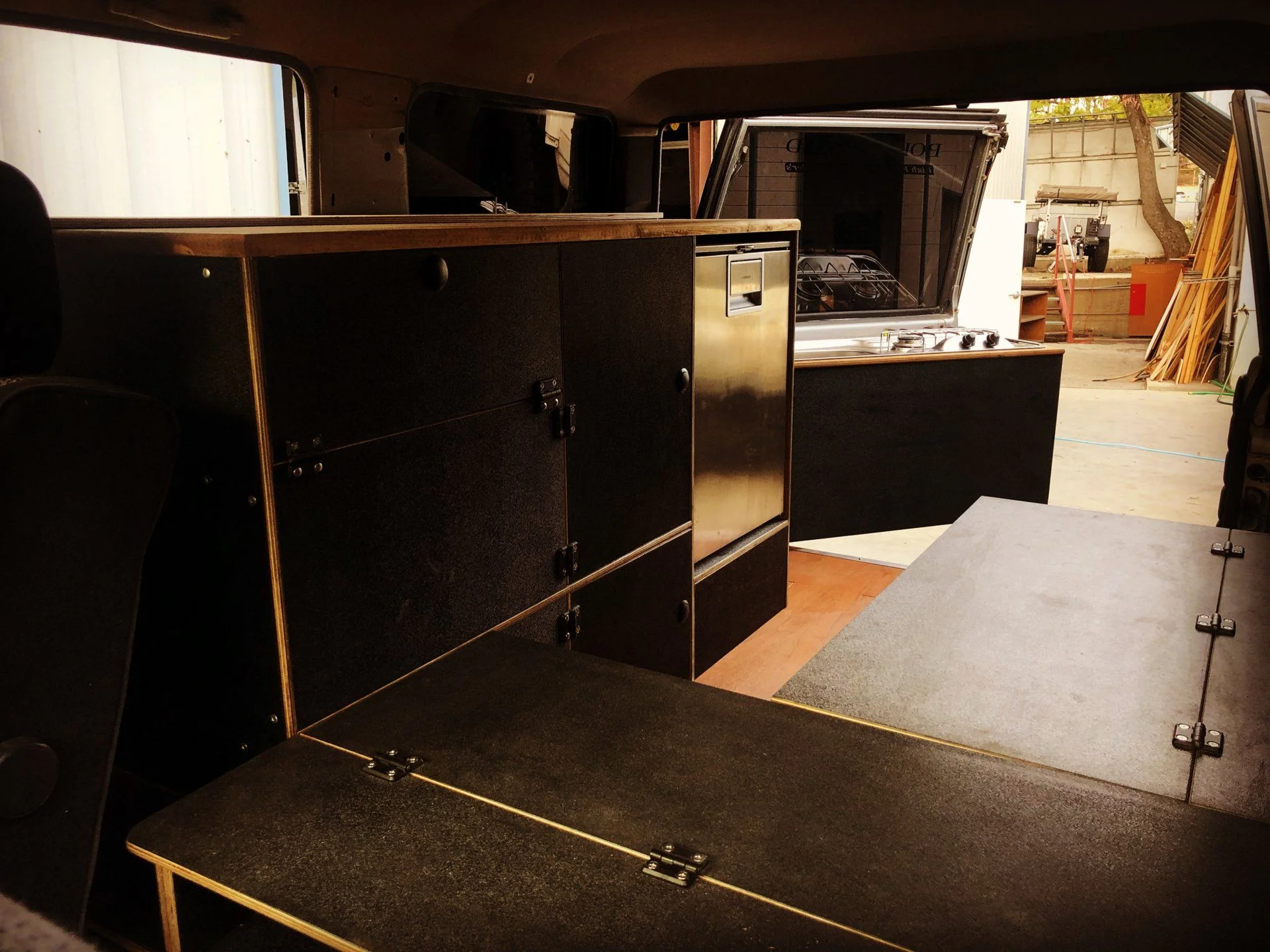

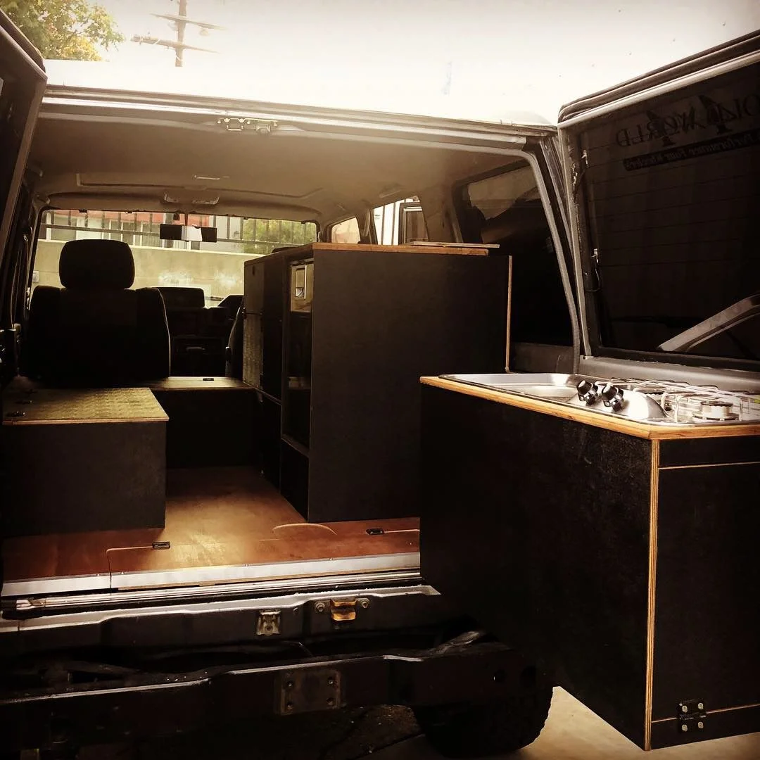

It has been great roaming around and bumping into so many cruiser enthusiasts. I have been building a couple of tops and interiors for 2 77 series trucks in California. Roof cutting is totally a game changer. Wind, rain, and cold temps are inevitable while being outside. Here are a couple pics of some new interior layouts I have done. LCP is always on point and will be styling with those barn doors.
How does the floor space of your new builds compare to the 80 series?
Liking the new drawer fridges with the tiny ice box:clap:
What is the floor tip open access?
I just experience poptop build without an upper bed given the ability for some 6' to be sitting upright without the top up. Now thats game changing and a strong possibility for me going forward.

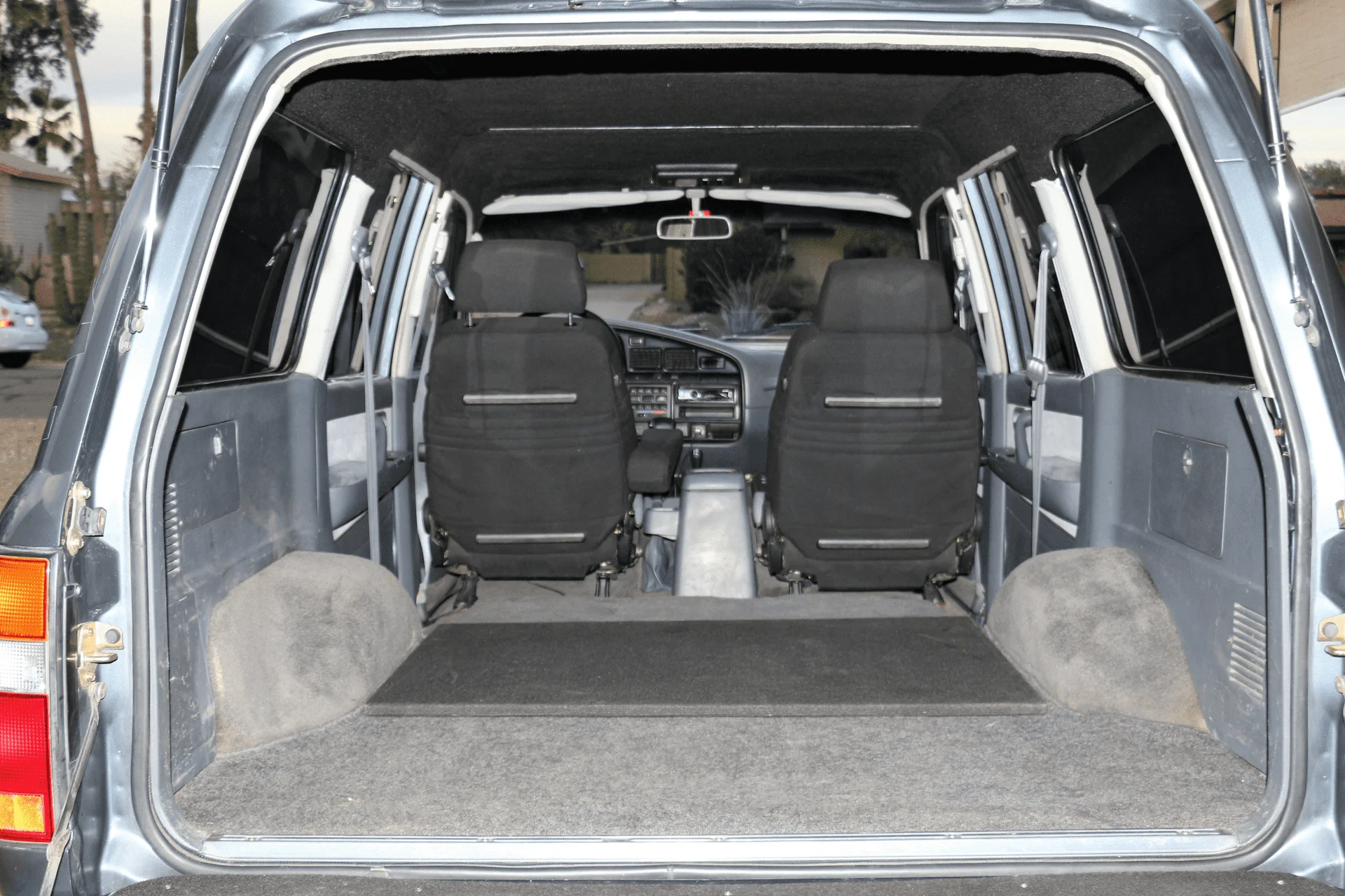

Any pics of finished portion of the roof cut on the older style headliner as mine is a 1997... Looking for some detail on how its finished off and the final look with the tent installed.

check out ab1985's thread "project alpha bound ll: electric boogaloo" on expedition portal. its a nice thread on his campteq conversion.
Thanks - Great thread and nice pics... Some of the pics near the sunroof show some sagging roof material or something else... Just trying to see some finer details of the end product..
Will just have to wait for @LandCruiserPhil to start cutting!
Cheers.
John
Cheers.
John
ab1985 is ~3/4 cut not a full cut.
dirtsunrise is a full cut done to the max
