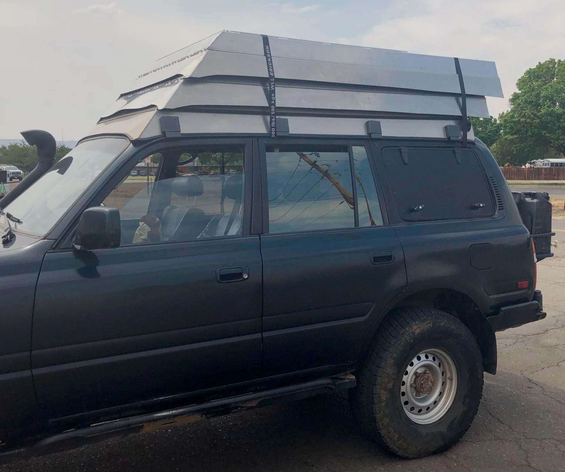

The one reason I wouldn't switch is if I couldn't carry over my alucab shadow awning. I love it more than probably any upgrade to my truck. It would need brackets to bolt into the tent. Is it possible? Also wondering if a roof rack is possible with the campteq? I need to carry a bunch of surfboard around ocasionally
The Campteq is a rack in itself. Add some aircraft tie down track to the top.
Hey, Dan. I have a Shadow Awning as well and Eric has said that he can accommodate it. This was his response to me when I'd asked...
"The mounts that I have made in the past were welded brackets to adapt the Campteq body angle to a 90deg. For this application the bracket would be a permanent cheese wedge (nothing is really permanent with aluminum) that the alu cab will bolt to. It looks like they use pretty hefty hardware and less of it. I see only 2 mounts. You would be able to still reach the top mounting hardware and remove the entire top/ awning set up in 15min."
Hope this helps.
Does someone mind telling if its possible to mount these to the top without cutting the roof and accessing from the inside (with the pop up being the same size)? Id like to retain my rear seats and keep my camp kitchen/storage box in back. Ideally I would like to be able attach a ladder to the side or back of the campteq when in use. Just confused about this. Thank in advance. I emailed campteq but figured I might get a reply here faster.
You don't need to cut your roof. Most with the Campteq have cut, but at least 1 person @LandCruiserPhil has not cut his roof.
