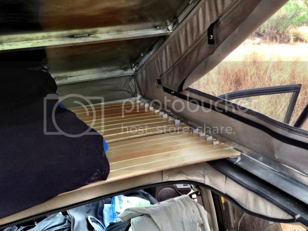

The bed platform is left up to you. Eric gave me a slatted bed platform and that is what Phil is currently using. Since I cut my roof I knew I wanted a platform that I could raise up out of the way and stand inside. I made a platform out of plywood into two sections. The main platform is 60in length and the rear platform is 20in length. Both sections have gas struts so I can raise them both out of the way with my bedding remaining in place. The main platform hinges from the front and the smaller platform hinges from the rear. With the smaller platform open I can crawl upstairs and then shut the smaller platform behind me.

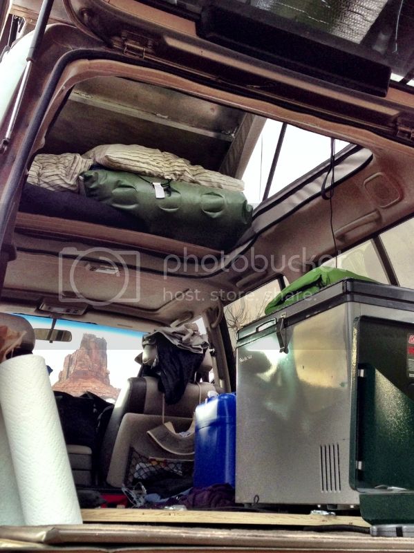

I’m using 3” foam in total. 2” firm plus 1” plush on top. I have 1/2” ply wrapped in fiberglass split in 3 sections and upholstered. I can store a double width north face bag, sheets, house pillows and 2- 800 fill goose down bags up top while closed, along with bear spray, large knife, and headlamp. I have skipped the insulation for the added room. The bare aluminum is easy to wipe any condensation from in the morning and there is no place for moisture to absorb. I’m currently building a composite raising bed system to shed some weight and added convenience.
