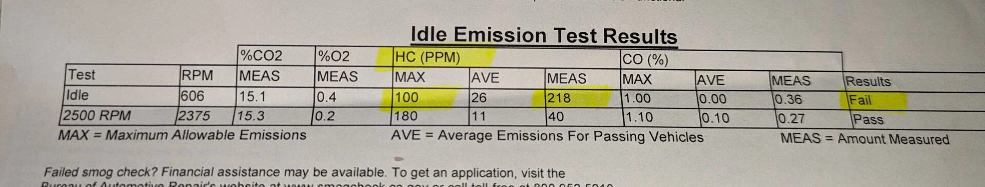

Failed a smog today - OBDI..... 2500 RPMs passes everything great - but at idle the HC measure 218 - max is 100. All other numbers pass at both idle and at 2500.

I couldn't figure it out, so I finally bit the bullet and spent $524 in diagnostic fees and labor to learn that the new fuel filter I had installed was faulty....
Don't know why it mattered, but it passed smog nicely after getting that fuel filter re-replaced....
