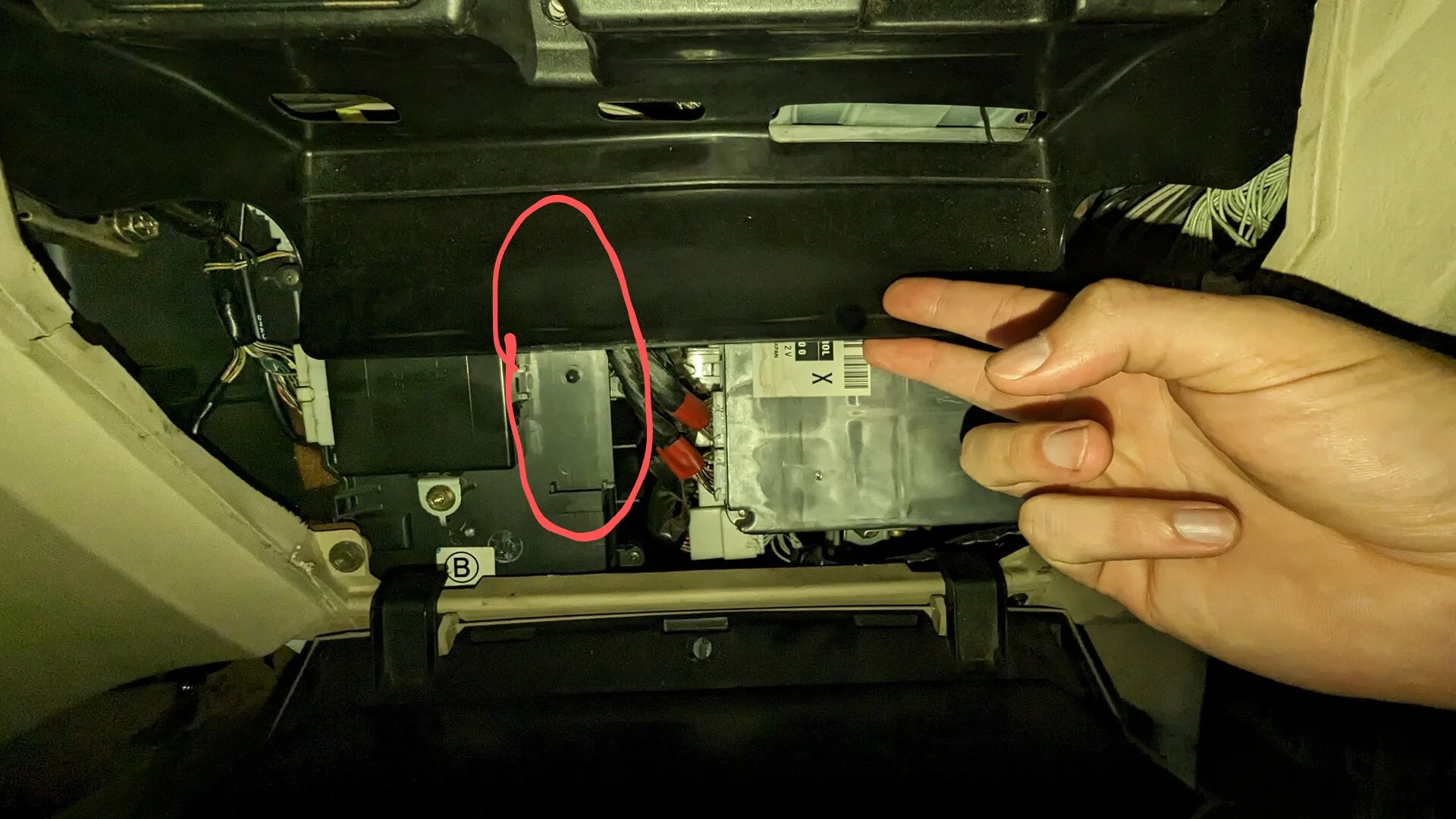

Thanks, all! I got the box dropped and see this. The plastic piece I'm holding appears to be removable if I unscrew a few screws. But it doesn't look like there's a slot for the CF...?
Thanks, all! I got the box dropped and see this. The plastic piece I'm holding appears to be removable if I unscrew a few screws. But it doesn't look like there's a slot for the CF...? View attachment 3465659
Remove that piece. Looks to me like you have the cabin air filter door behind it.

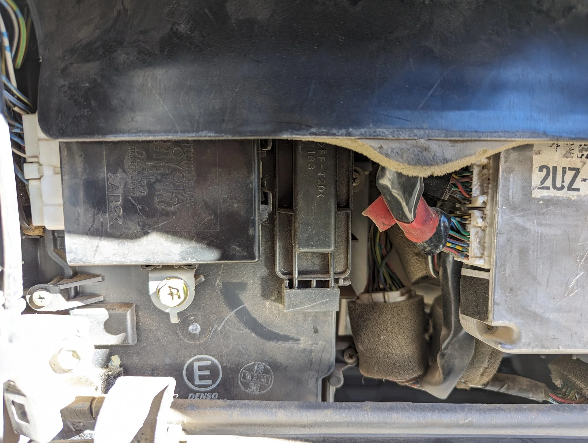

Yours isn't just cleaner than mine, it also looks a little bit different.
I don't think he has the door for it. There's a thread (and youtube) on retrofitting the front of that airbox with the one that does have the slot, think it has all the part numbers too.
No door, but can be retrofit to fit one.

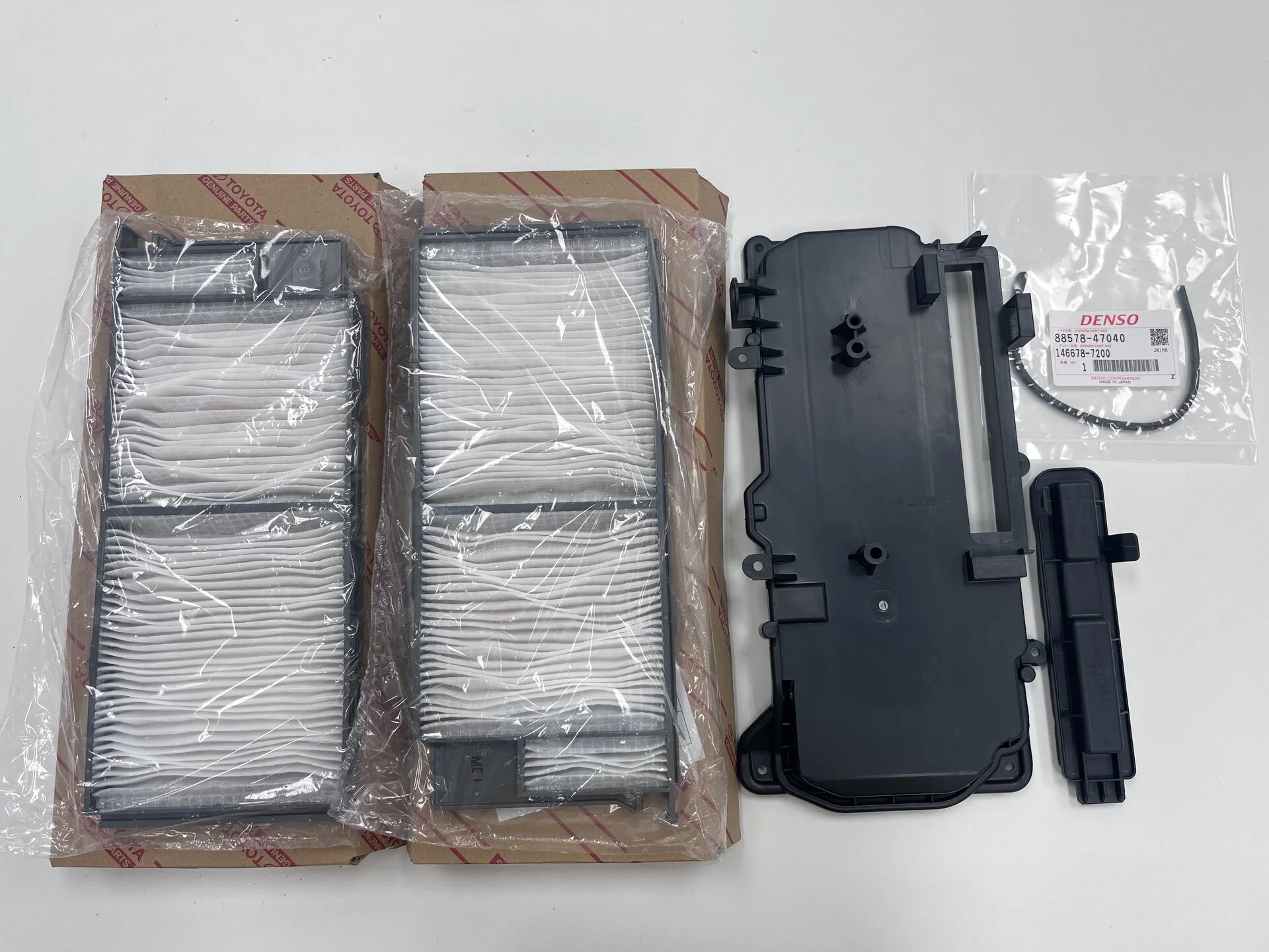

These are what you need. I carry this retrofit kit but not sure if shipping cost feasible.
