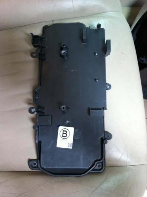

Quick update from iPhone. Cover removed, inside evap you can see the solt where the filter goes. Evap filthy, BTW, any tips for cleaning? There's little room to insert a vacuum cleaner or whatever.
Anyway, insane that all it is is a wrong cover that determines whether or not you can insert filters. Quite a hassle to remove the cover, tight fit.

It was a tight fit and tough, but I finally got it out by only removing the antenna relay. There is a clip/connector on the top left of the cover, which is clicked onto the cover somehow and I could not figure out how to remove it and broke the part of the cover it connects to, no biggie. Getting a new cover anyway.
The dash is screwed onto steel strut braces on the bottom and left, I removed the screws so I could pull on the dash a bit more to get some more room to remove the cover. I finally got it out by moving it down.
I went ahead and ordered the part -60040 and (I think) -60050. Filter cover and clip/holder, as per recommendation by hoser.

Update, I received the small filter holder cover today. P/N 88891-60050.
This should click into the new "cooler cover no.1", which I hope to get tomorrow.
Once I am sure it fits, I'll report its p/n, and then will go looking for filters.

Anyway, for the record, the "small cover" that is p/n ***60 in your diagram, is ***50 from Toyota. I have it waiting for me, still bagged and sealed in the car, while I wait for the dealer to cough up the large cooler cover no. 1, which I ordered (I think) as ***40, as per hoser's guesstimate about 50 postings ago in this thread.
