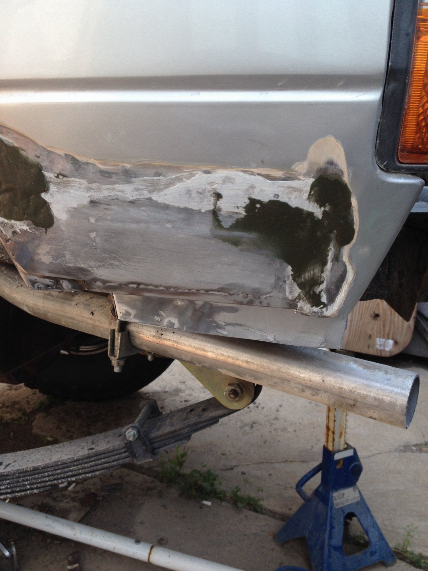

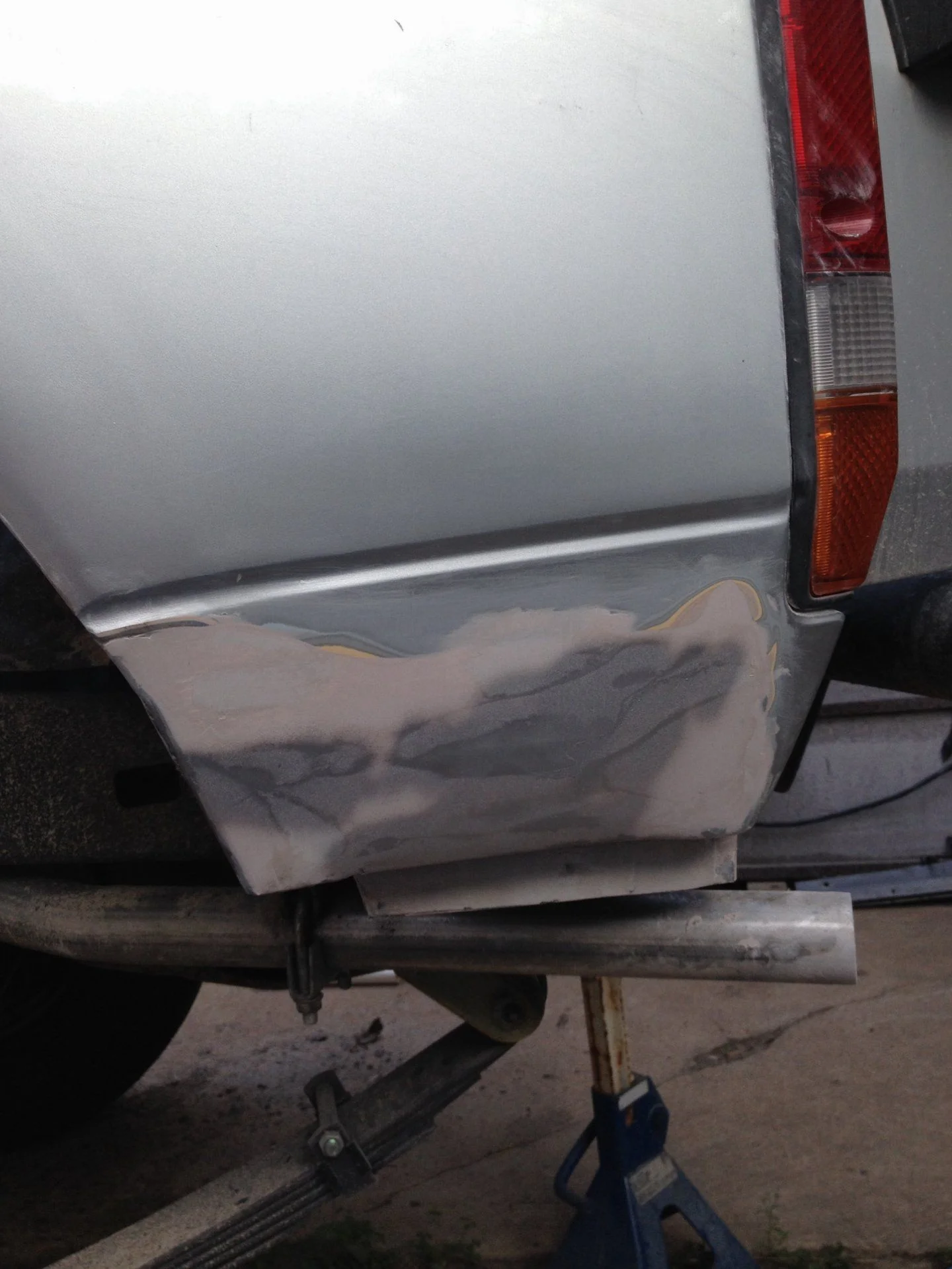

-look at the rear body lip just in front of the rear bumper where it meets the inner fender, same with the front section of the same inner fender, the 70s rot there because of overlap.

rust issues are NEVER easily repaired. they are just easily hidden.

The old saying that you only see 10% of the rust is unfortunately accurate and something potential buyers should keep in mind.

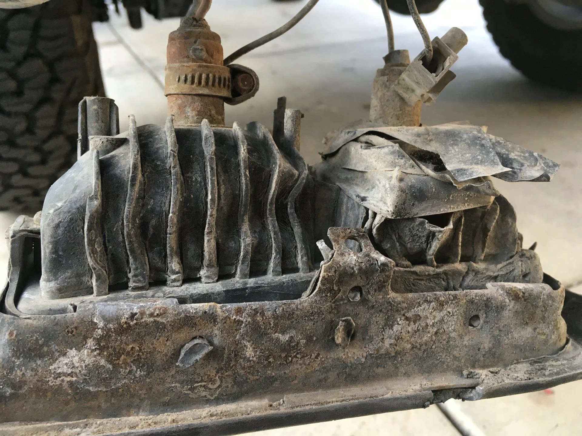

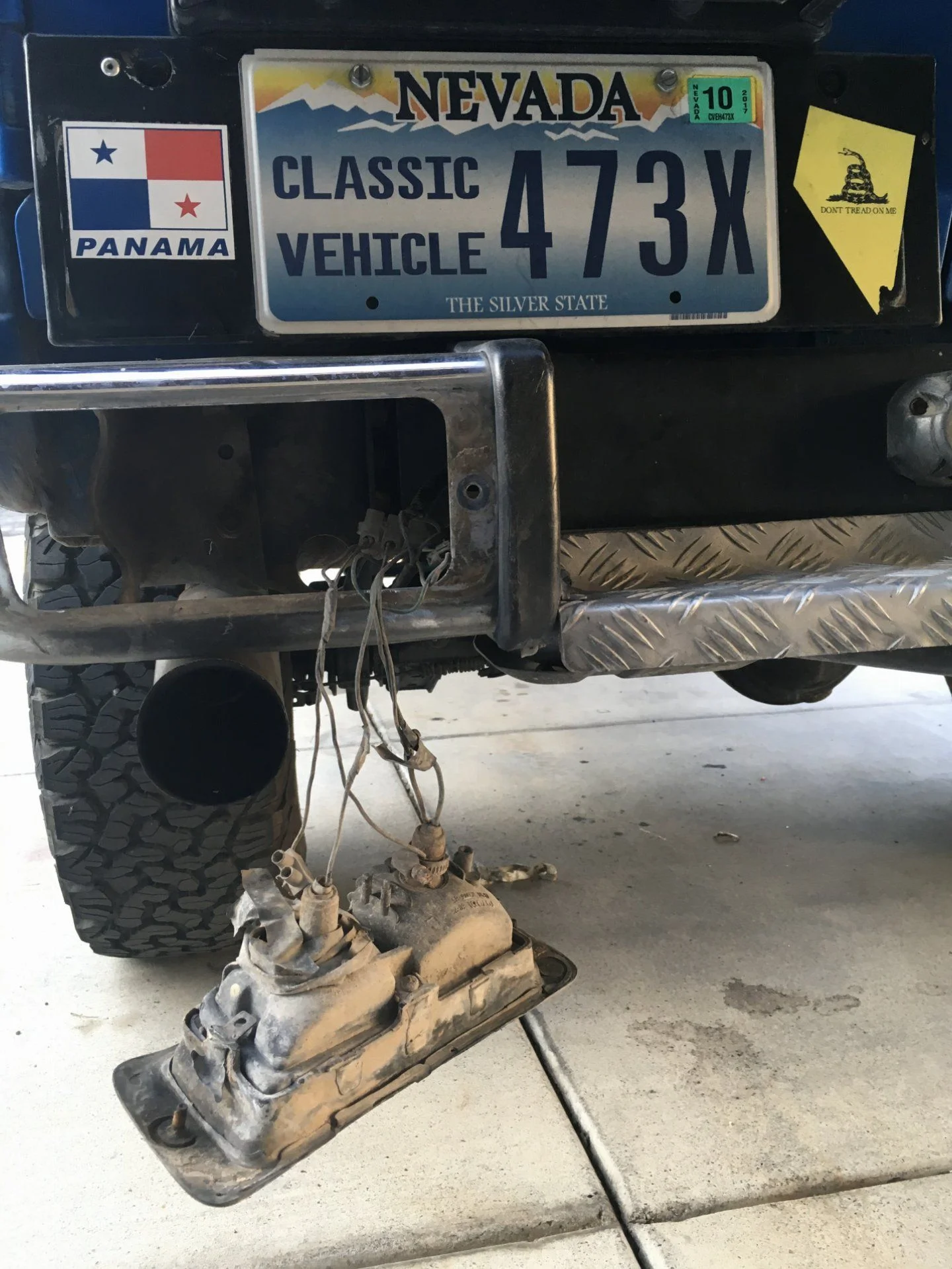

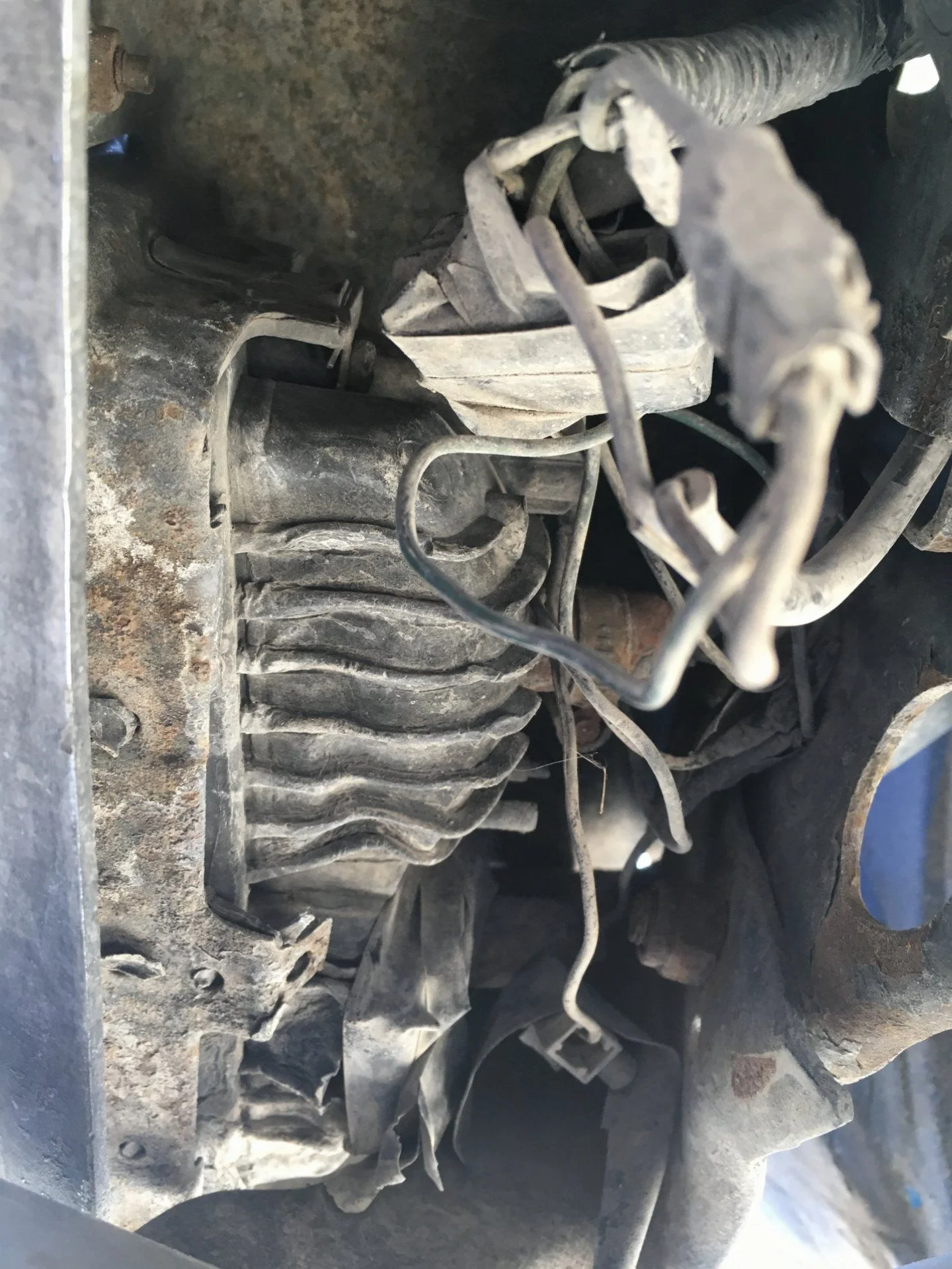

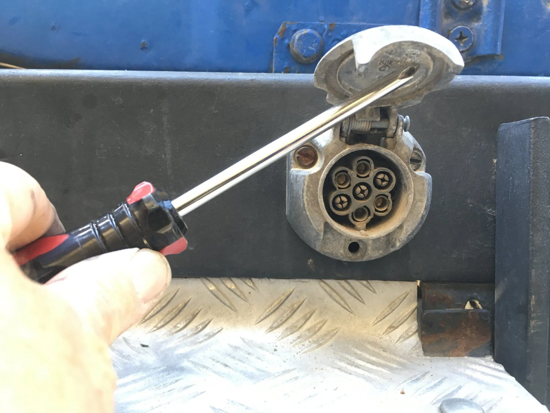

In addition to Crushers and GoFast comments, I would also like to add, I found a relatively rust free, but high mileage, 70 Series. Top on my list were LHD and Coil Sprung. I was sort of awed when I finally found one, and by that fact that it had little rust. I thought I had done my due diligence. That said, I didn't do a thorough inspection of the electrical. All the lights and high beams, and turn signals were functional. So I didn't really second guess it. One big "Red Flag" on the electrical should be a electrical connection for a trailer. I saw the connection, and thought it was a "bonus" at the time. However, I have a nightmare behind the rear quarters and under the bumper due to a "hack job" electrical connection for the trailer.
