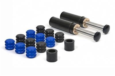

Got a deal on some 14inch 5125's for my FJ40:
Obviously the 14's are a little long, and logic says..it would be cheaper to buy shorter ones than fancy pants bump stops, but I believe I can make them work. Plan is to move the Ford shock towers to the top of the frame then gusset and brace it. Also going to move the lower shock mounting location to the side/bottom back side of the axle. That should give me about another 5 inches.
I am currently looking at:
Daystar Stingers: $209 a pair http://www.summitracing.com/parts/dys-ku71090bk/media/images
FOA 2.0: $300 a pair: http://f-o-a.com/shop/index.php?main_page=product_info&cPath=20_44&products_id=25
Sway-A-Way : $253.00 each so $506 a pair..:censor:
http://www.polyperformance.com/shop/Sway-A-Way-2.0-Air-Bump-Stops-p-17676.html
Fox 2.0: $201.00 each $402 a pair: http://www.polyperformance.com/shop/Fox-2.0-Air-Bump-Stops-p-63.html
Any other options? Suggestions regarding the bump stops? Or should I just extend the brackets for regular bump stops? Pro's cons of each?

I like the functionality of those Daystars .. you can make 'em harder or softer within small range, no need to charge or worry about seals or anything on them .. just fix your can and wheel it ..
I agree, although 90% of the people on Pirate 4x4 disagree. I like the idea I can replace the innards and wont have to worry about a bump stop loosing air/fluid of any type. I am also partial to these out of the ones here due to cost. If I was to do what I listed above it would all still come out close to the same cost overall. The extensions from Marks are $44 for a pair, not including the bump stop's themselves at $56 each. I am not even sure that the extensions are long enough. Making my own would be a little more time consuming and not as clean...ah decisions decisions.. :D

The bushings in the daystars doesn't hold up well.....foa's leak notoriously.....watch pirate for a whole and you can find some used fox, king, swayaway, bilstein, racerunner, or radflo's for around $200 and they are all good quality
:clap: Thanks, been awhile since I checked out Pirate classifieds.
