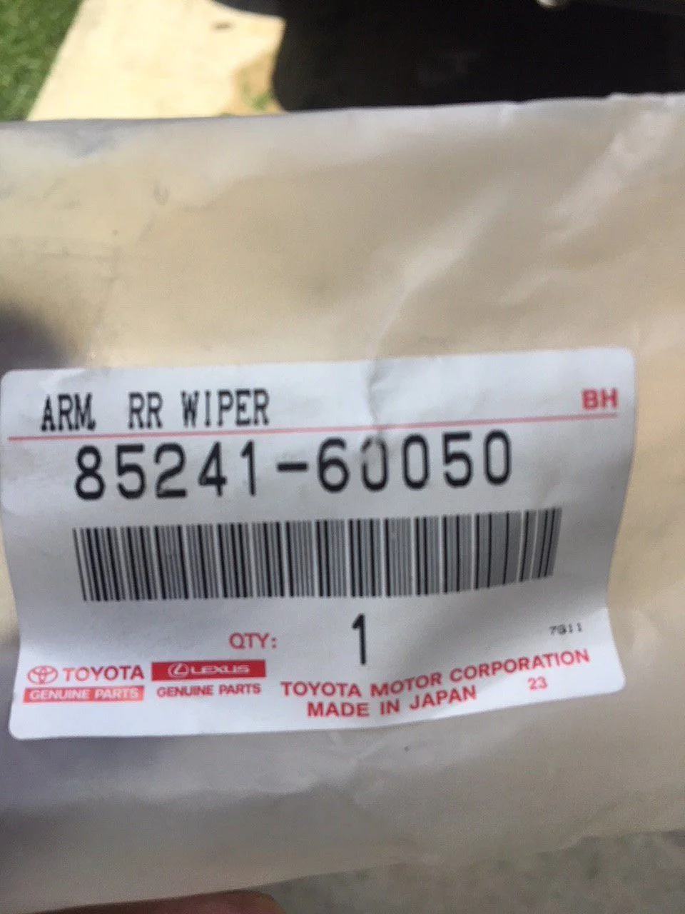

I’ll start with a nice discovery I made. The rear wiper arm for the 07+ J76 is perfectly compatible for the 77, and presumably with other hard top trucks with a rear wiper. On the plus side, the new design has the blade clip integrated. No more baby screws and clip out back.

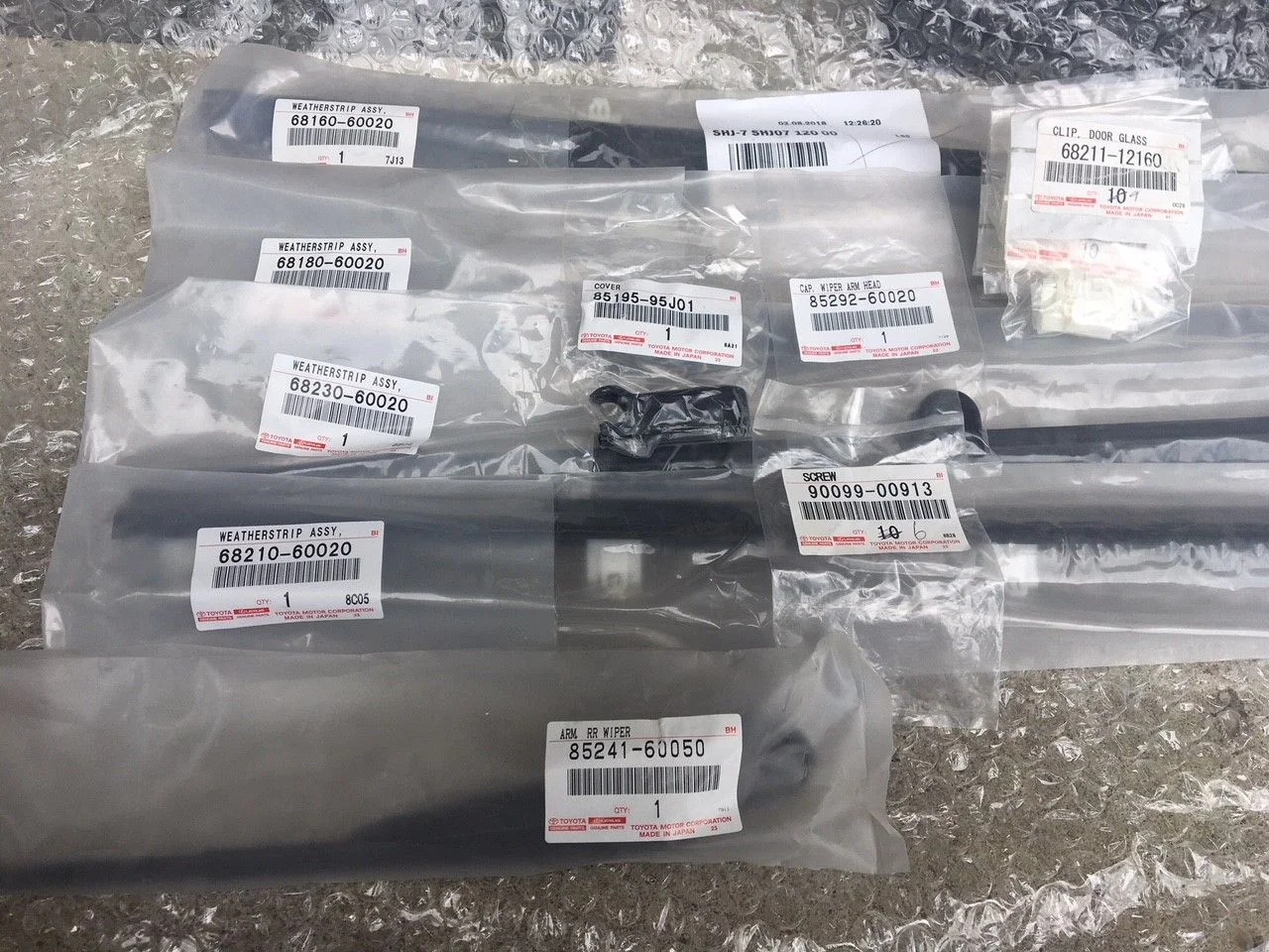

I also replaced the front wiper arms. The left side is listed as unavailable, I decided to order two right sides. They work well and its nice to not have rust wiper arms anymore. Additionally I'm starting to collect stuff to do an interior refresh this winter. more to com on that later, but weather stripping was part of the order.

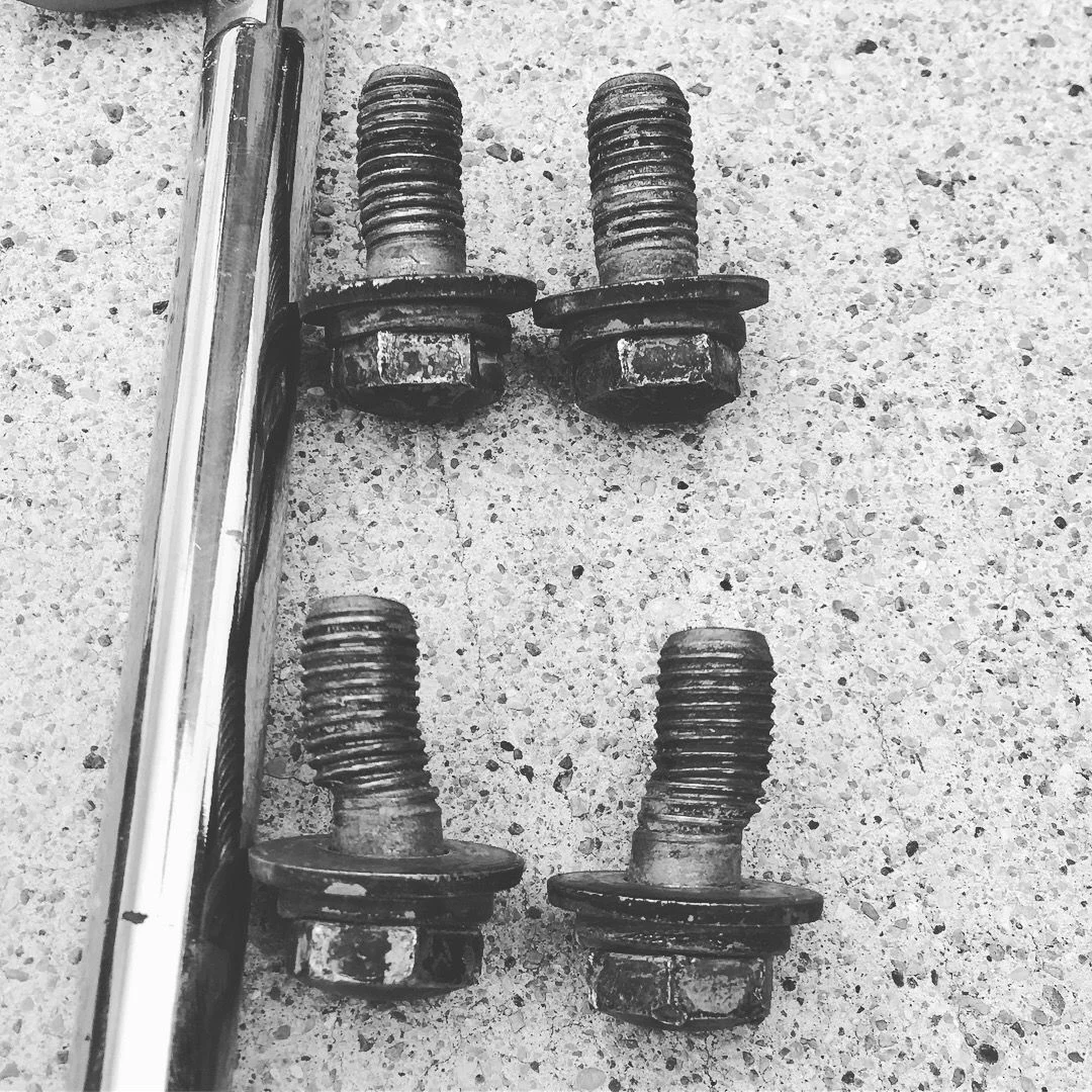

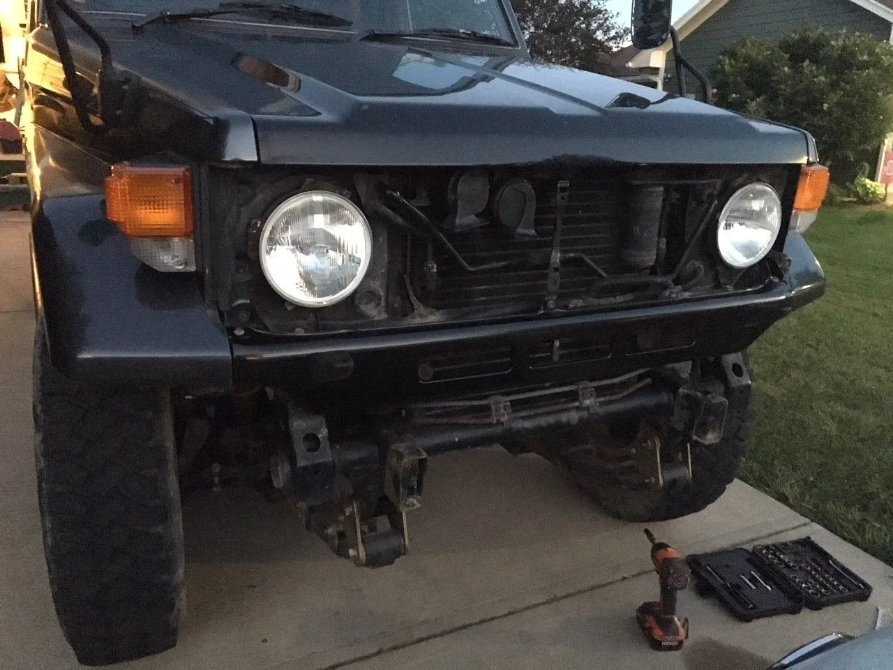

As a result of the failed bolts I figured it was time to start a face lift on Sophie. Earlier I cut into the lower valiance knowing I had another on the shelf. I stripped down the front of the truck, addressed the surface rust and started ordering parts and prepping to tiddy everything up.

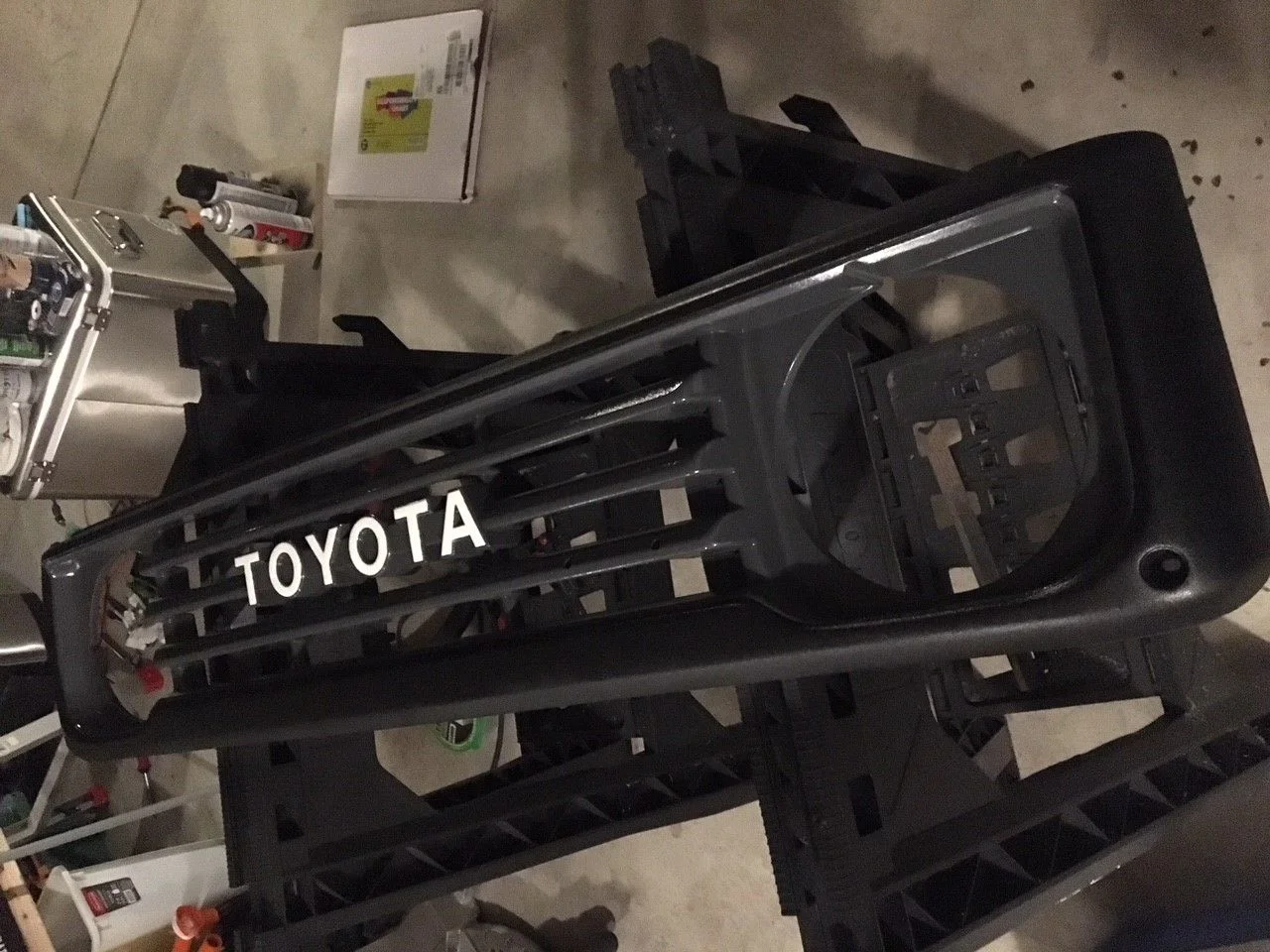

While I had the front striped my wife stole my grill and brought it to a local body shop who “has done some concourse work” to get refinished as a Father’s Day gift. Long story short, they held it for 6 months. It sat in a corner collecting dust. About 1 week before the 4th Annual Meet N Greet I told them to give me my s***. I cleaned, primed and painted it myself. 4 coats of automotive primer and 4 coats of rustoleum gloss grey enamel spray paint. I wet sanded between coats by submerging it in my kids’ bathtub and used 1800 paper. I painted the TOYOTA in Testers gloss white enamel and the DIESEL in their satin aluminum. Finally I painted the boarder in my favorite textured black. It came out pretty decent, not flawless, but it’s a Land Cruiser.

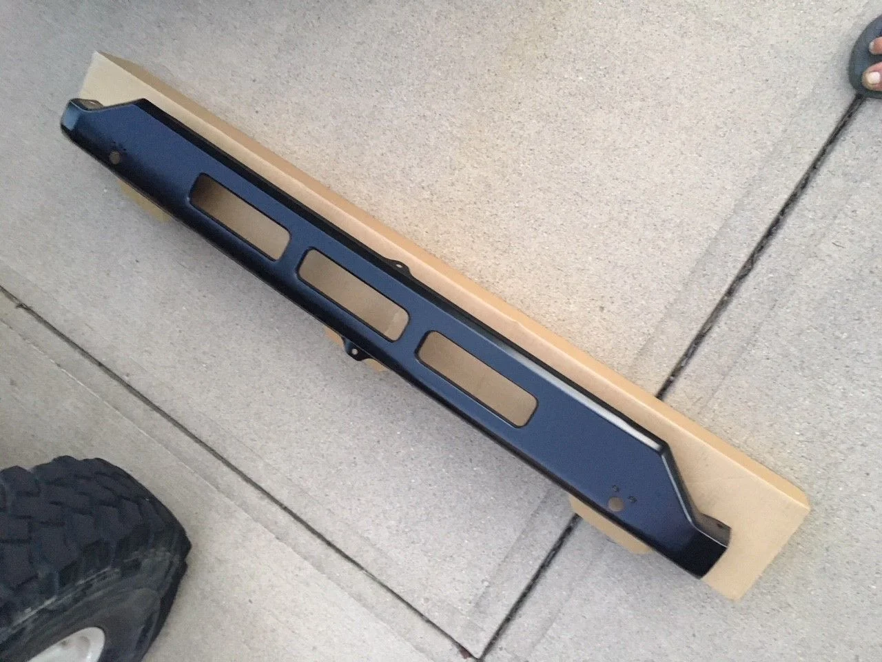

I’ve been collecting parts for a bumper, and it was finally time to buy an actual bumper.
I like a lot of the small builder’s bumpers, but I opted for the ARB for two reasons: 1) I had a 30% off coupon. 2) There are a lot of deer in the area, especially on my wife’s campus and I am terrified of smashing into one.

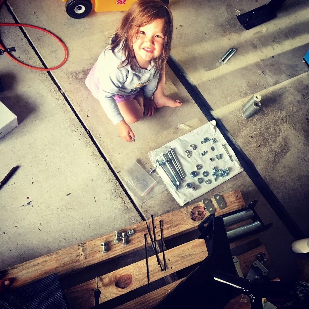

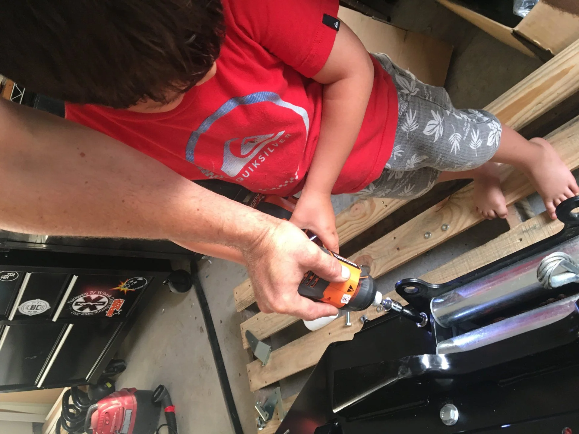

Once the ARB arrived, I started to build it up in the garage. One step at a time the kiddos helped me install my winch and fairlead. Huge thank you to @RJRandel for sending me pictures of the instructions. I put them in a place I wouldn’t forget (I later found them while doing pack-out for the trip). My wife helped me actually mount the bumper and held it in place while I bolted everything down.

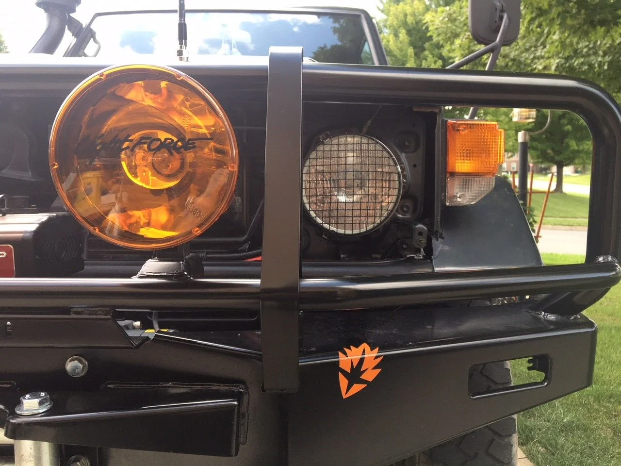

For some dumb reason, the bumper comes with 12v incandescent bulbs. I guess I assumed most HD 70’s were 24v, but I’m not the brightest. I called up Rob Smith and added his exterior LED lighting kit (including the indicator lights) to my already existing order for his recovery points. Shameless plug, this recovery points are absolute beef cake. I wouldn’t have ordered an ARB bar if I didn’t know that these were available. If you have a 70 with an ARB, you absolutely need to get a pair.
The bumper build was rounded out by a pair of LightForce Blitz lights curtesy of @Gun Runner 5 . They had clear stone guards which is great most of the time, but this truck was getting prepped for the smoky mountains. I ordered a pair of amber filters knowing fog was probable.
I decided to install some wire stone guards. My headlights work well and I don’t really look forward to them burning out. Plus I think they look cool. Apparently they’re OE parts for the FJ40. At $20 I doubt it, but they fit right on no dramas.

I wired the aux lights on their own relay with separate harness. Waterproof connecters were used as was waterproof wiring technique (Youtube University). I wired up the ARB indicators to run as DRL’s. Same wiring techniques used with them. That said, the housing of the ARB units are sub-par in my opinion. I will be changing them out for an actual sealed pod at some point. I did add black silicon caulk to help seal the units in the meantime.
As far as I can tell I did a good enough job keeping everything sealed.

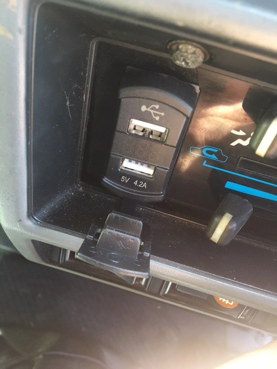

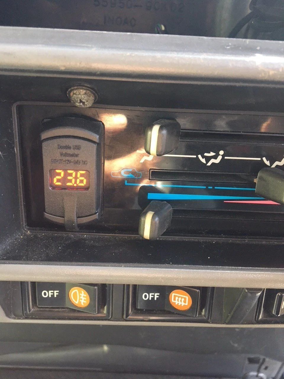

I added a voltage meter with two USB chargers. Enough power to charge two ipads at the same time. I like the little unit a lot, bought from Amazon.

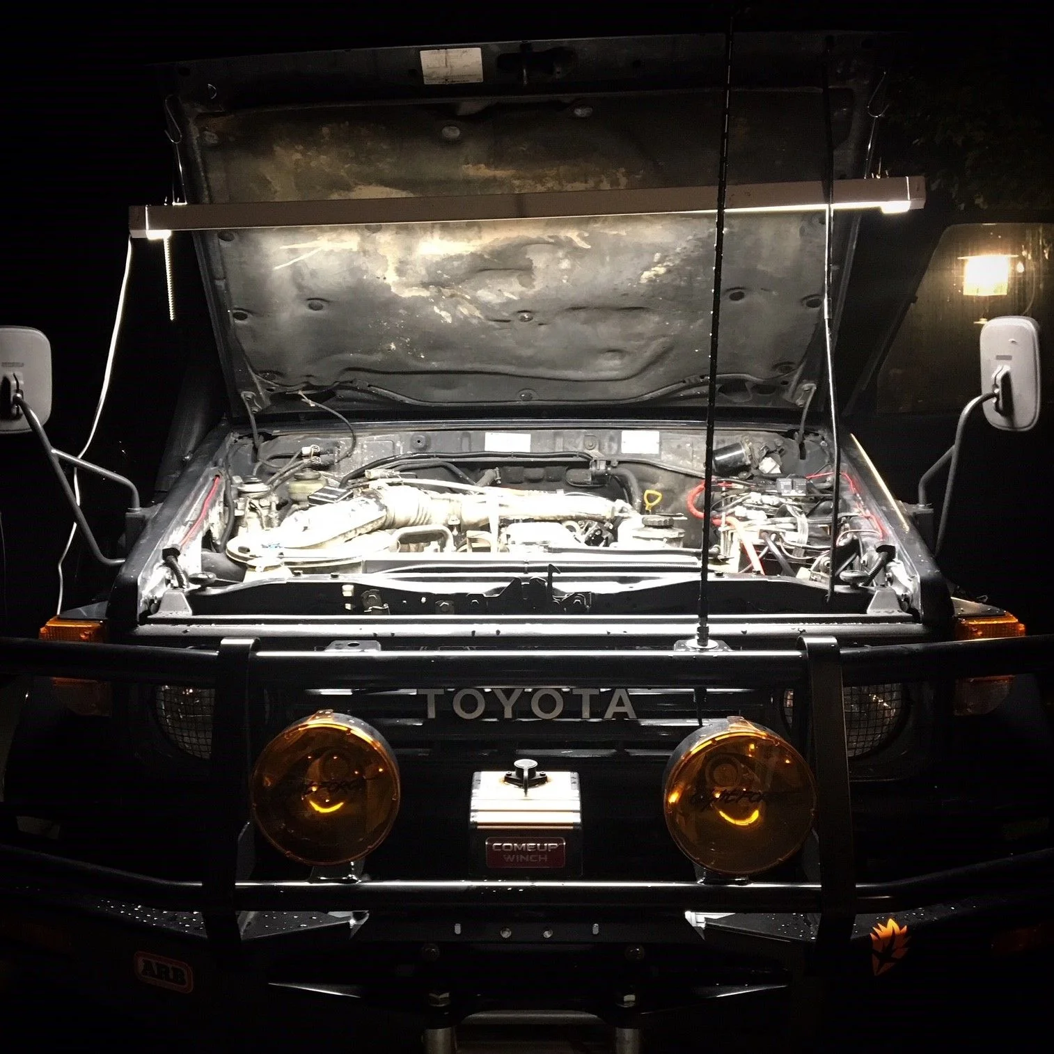

Wednesday night was an all-night affair finishing off last minute projects. Cleaning the truck and installing car seats. It’s a good thing I picked up this LED shop light, hangs just perfectly from the hood or hand holds on the interior.
