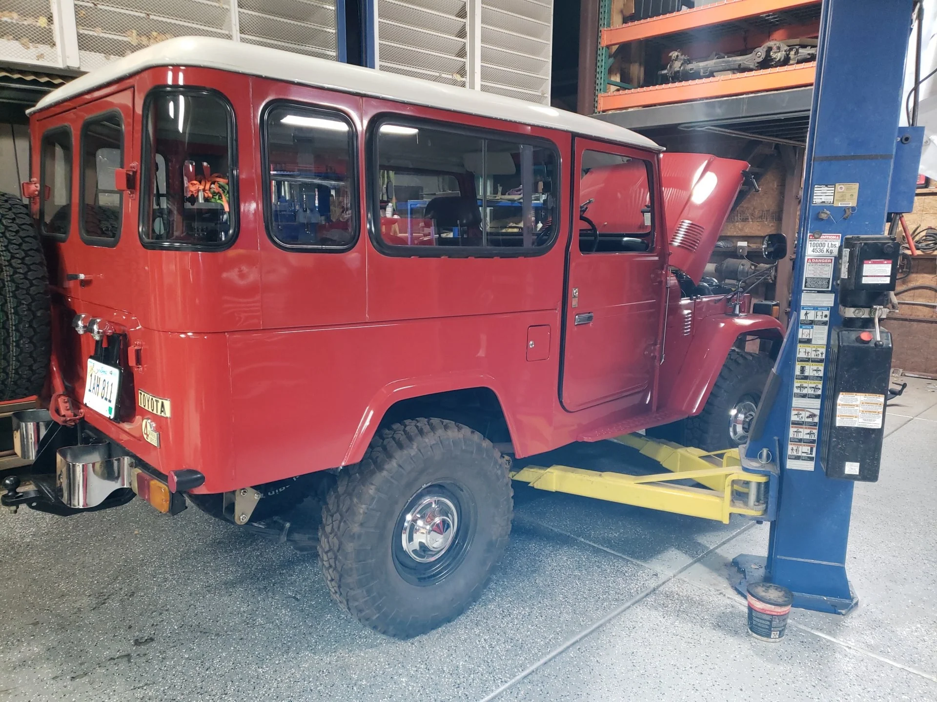

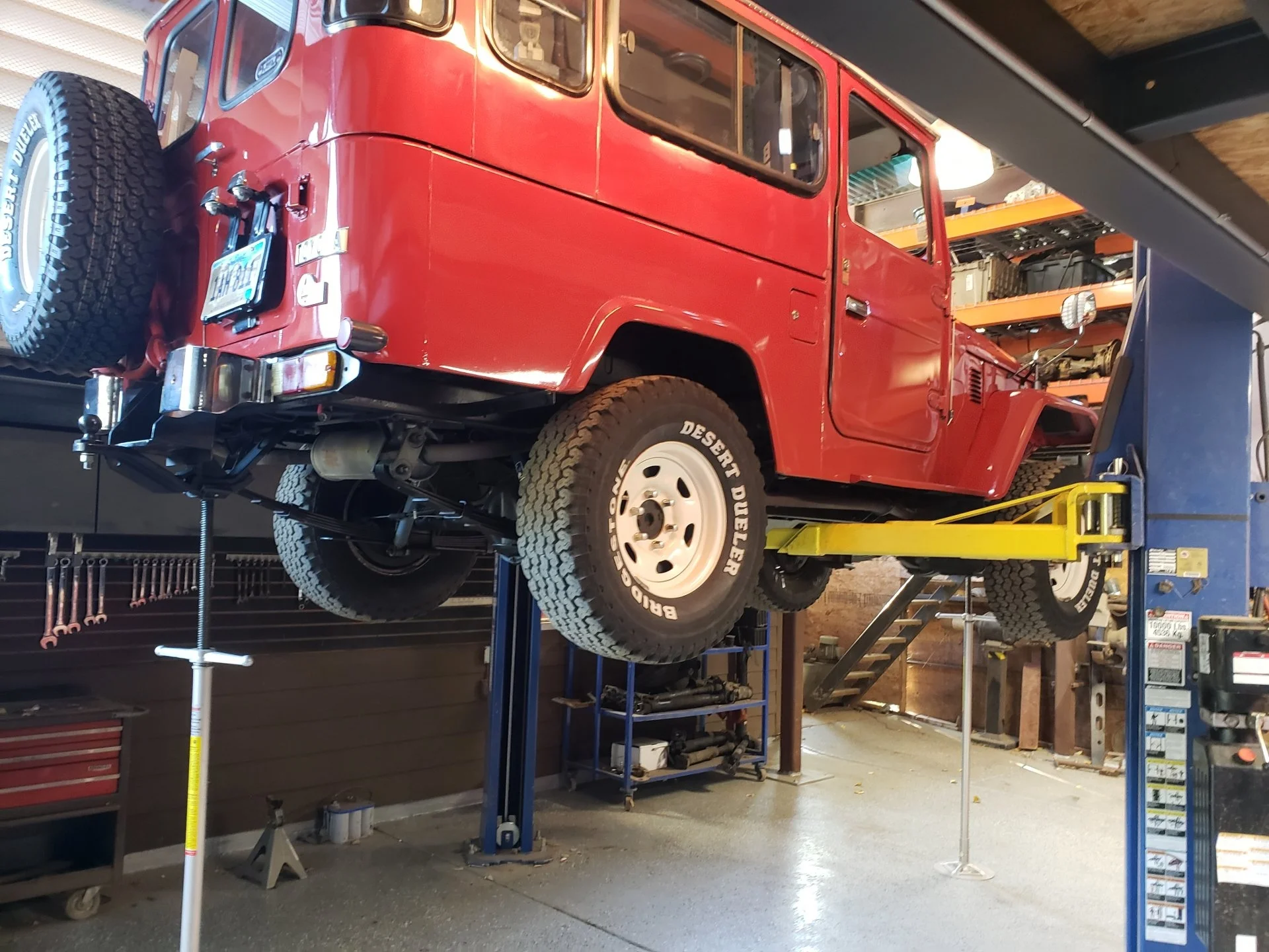

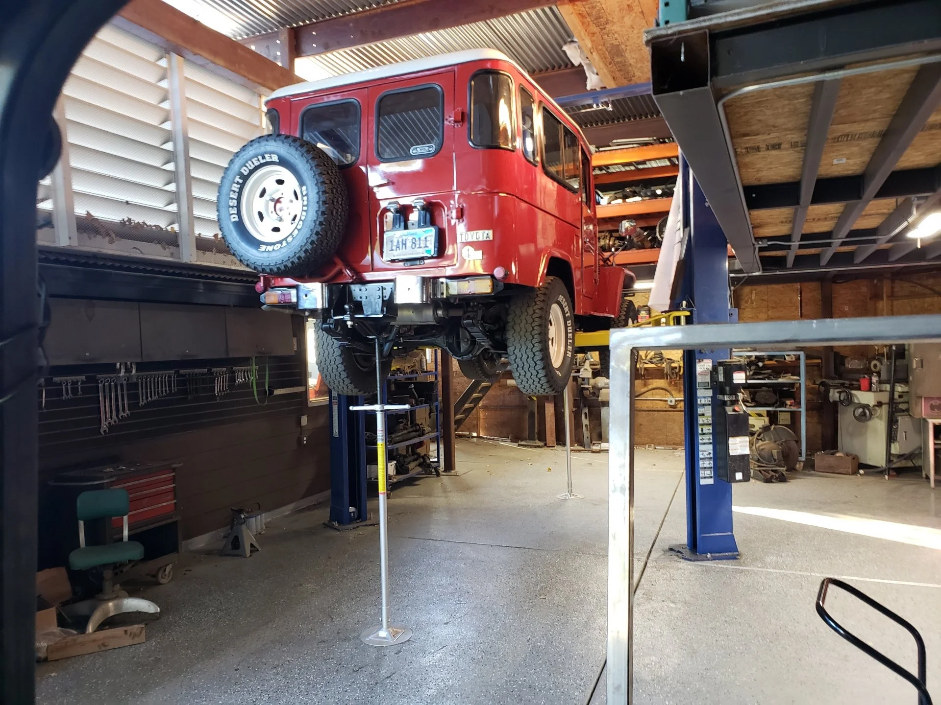

1st thing I did after trailing it home was put it up on the hoist and went front to back, I found it needed some love:
Main Points
- Swivel Hubs neede reduilding, they were long gone and leaking ( ironically it came with an invoice saying they were done 6mths ago, trust no one lol )
- Front wheel bearings
- Front disc calipers where seized on LHS
- All tie rod ends where shot,
- idler had play, steering damper leaking
- New brake pads all round
- oil leak front front of engine

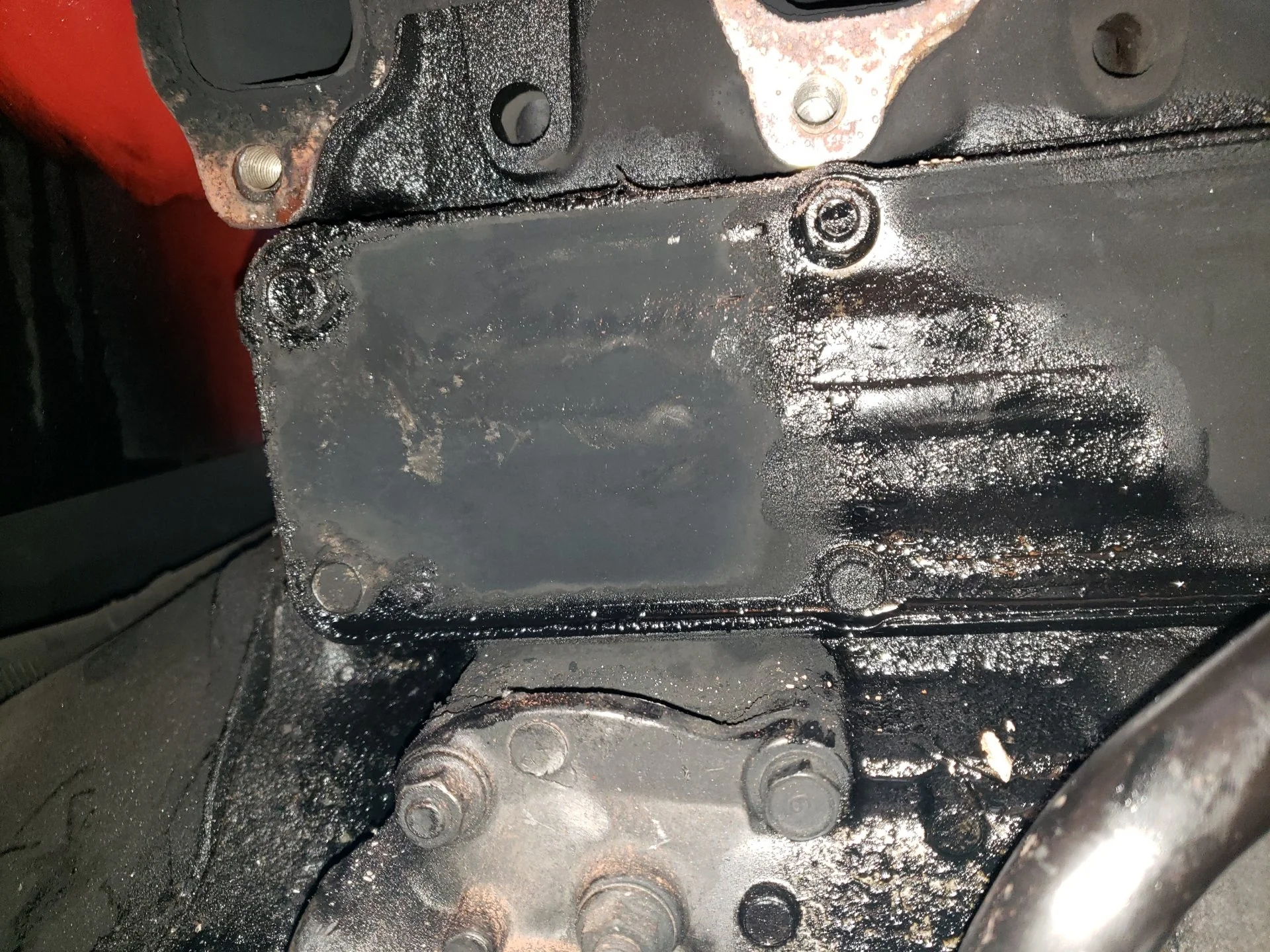

- oil leak from oil cooler side cover
- oil leak from tapet cover
- exhaust leak
- two broken exhaust studs
- oil leak from PTO drive
- Oil leak from front diff
- front Drive shaft missing 3 bolts
- rust under LHS sill
- Rear brakes
- tire where dates 2007 and awesome old school Desert Duelers, they were also rock hard lol.
- electrical issues - loom had been hacked
- stereo didn't work
- RHD Door window was missing rubber so moved loosely in tracks
- Rust in roof gutter RHD
- Dodgy Ass seat belts installed in rear though roof lip inside
- Rear seat was mounting incorrectly
- Driver seat had no cushion left on outside, material was still good
- running board was home made, looked ok but will address in future
- headlights where CRAP and you could hardly see them on
- front indicators where badly cracked
- fender mirrors where cracked and wobbling around
That was the main things I found. Keep in mind this truck only had 230 000 km on it and it was obvious it had been used as a weekend toy / eye candy .
So over all I must say I was initially annoyed as some of the things listed in the advertisement and supplied in writing where wrong BUT this was taken into account with the deal I got and after spending several hours inspecting everything I can say I am

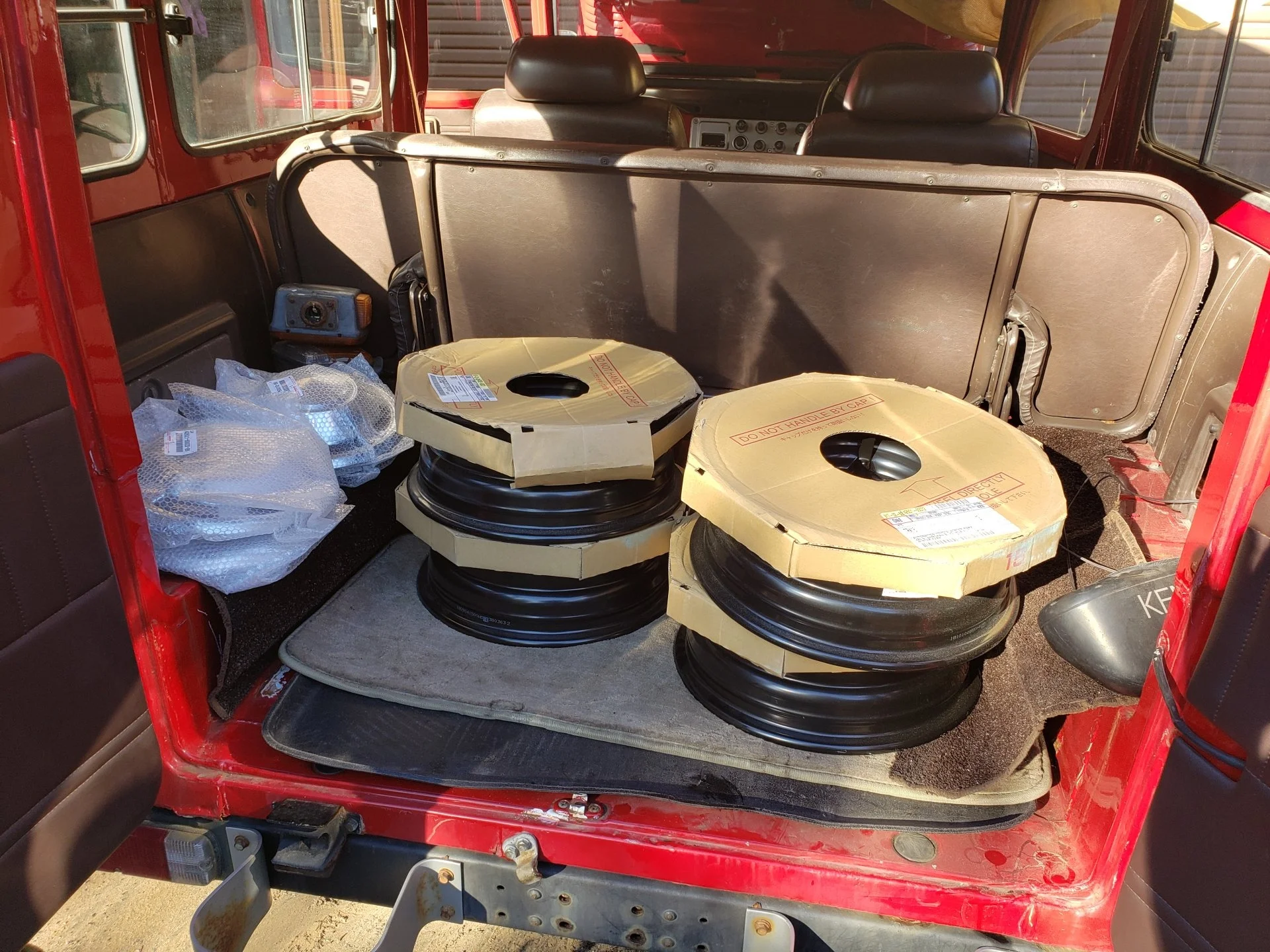

Good thing about the BJ46 is the extra storage space you get behind the rear seat, you can easily fit you new rims and hubcaps :) Big shout out to Toyota for keeping them available even after all these years . :)

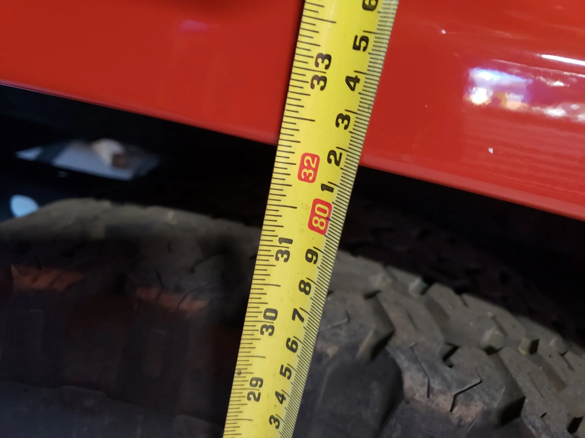

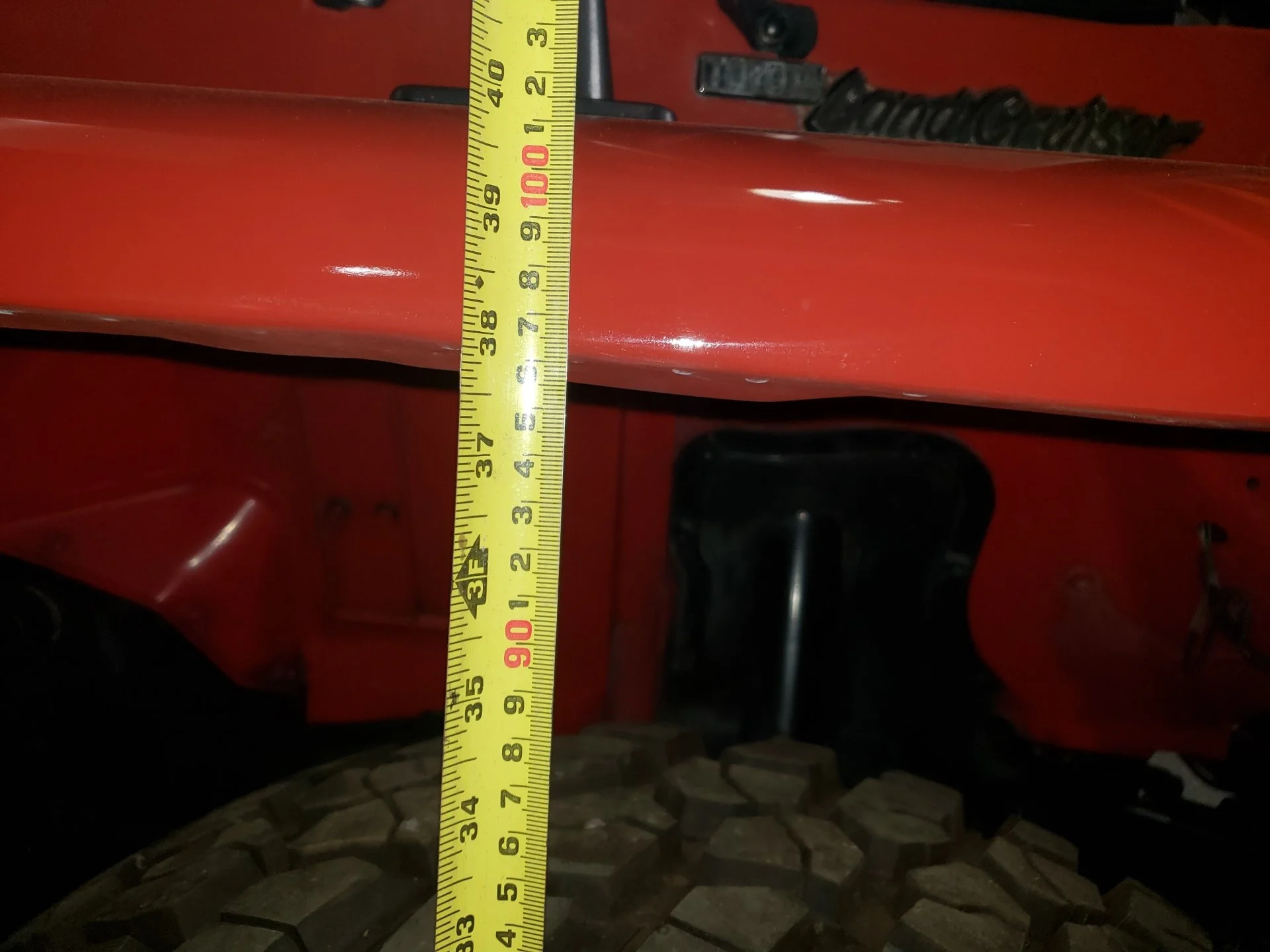

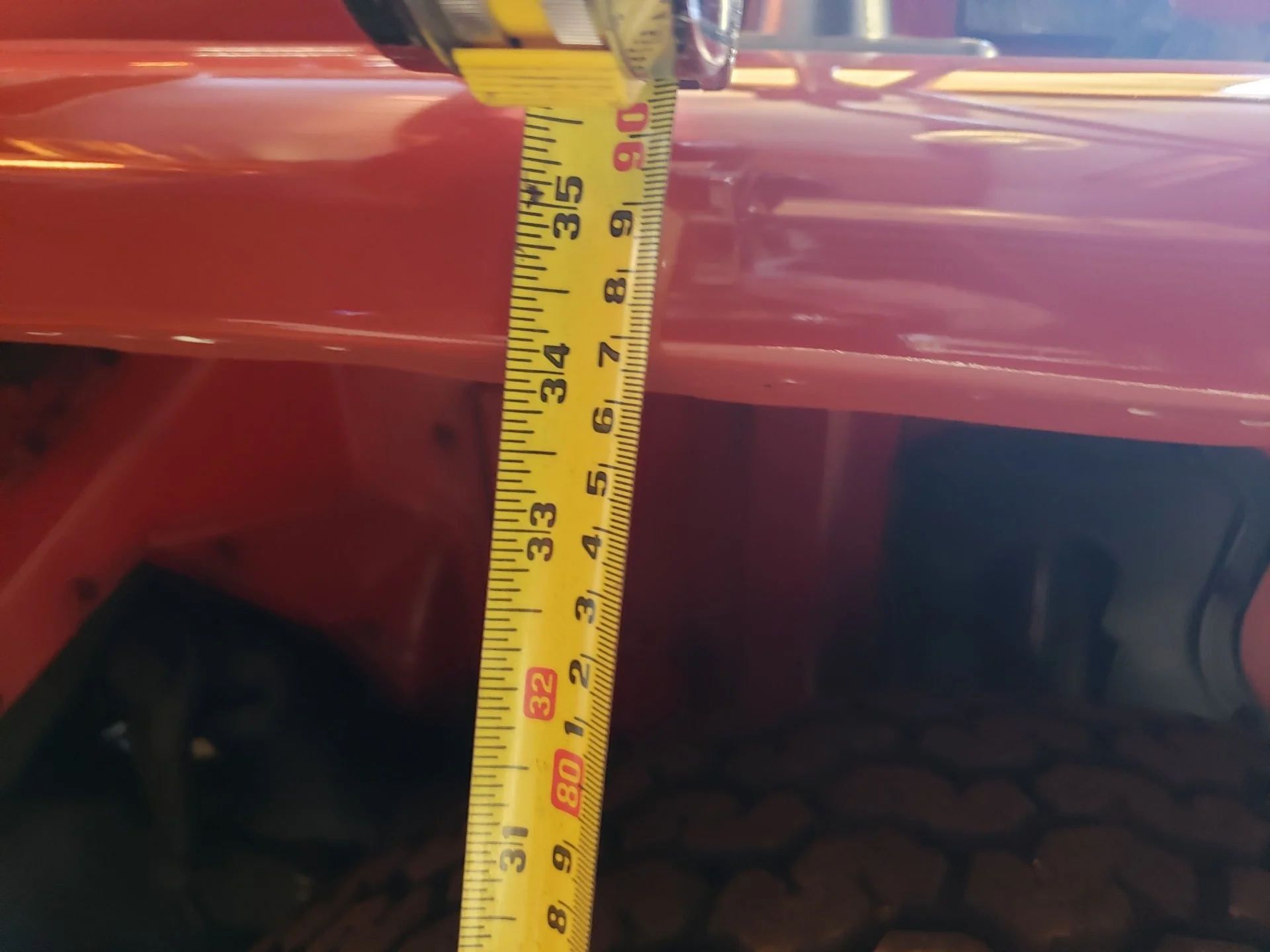

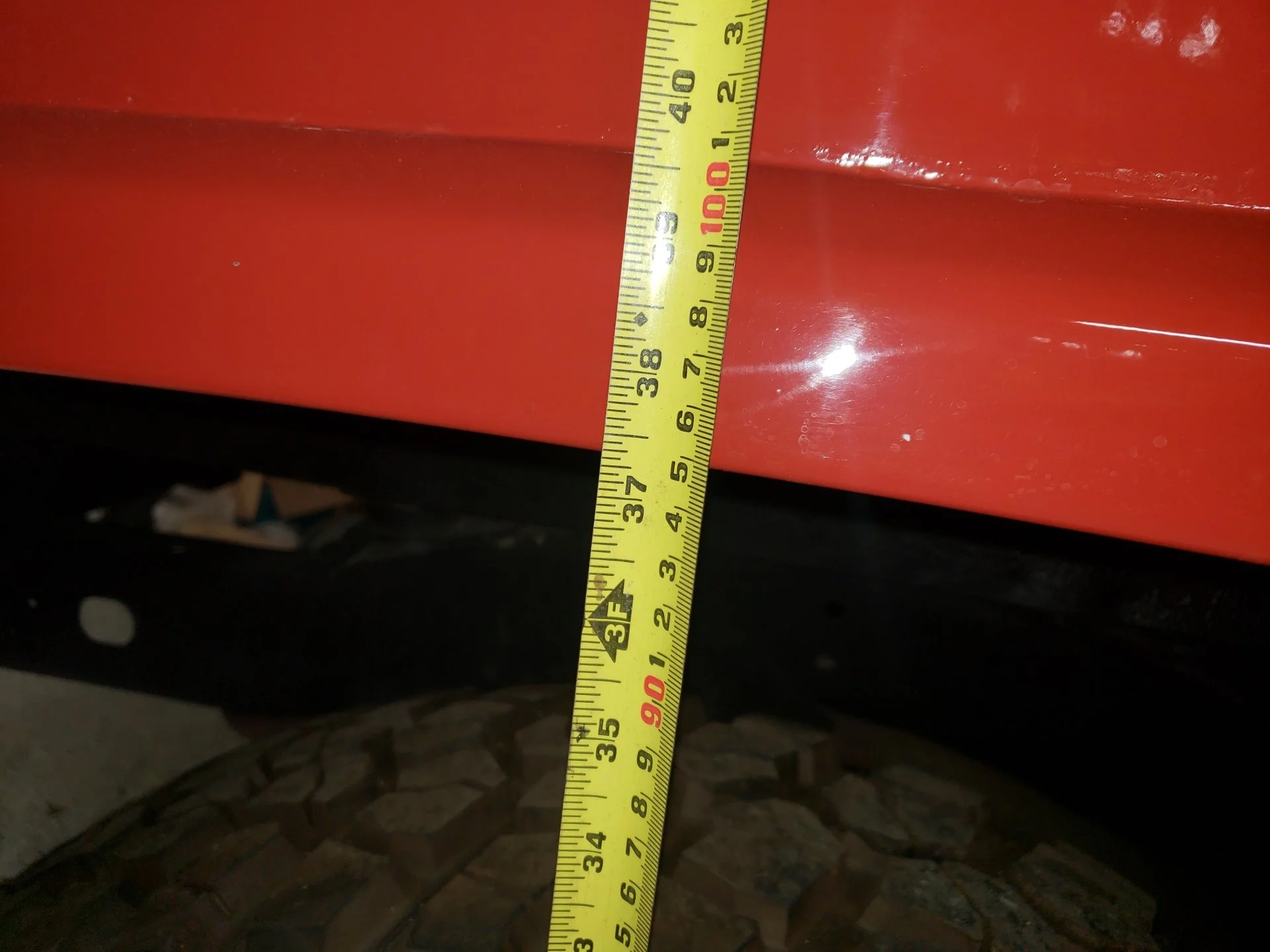

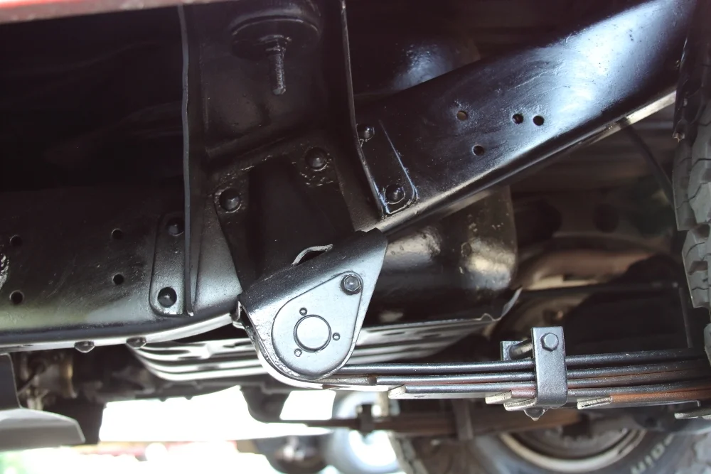

To fit the 33 x 10.5 x 15 on the stock Toyota Rims I am going to need to give the old girl some lift. Luckily Cruiser Outfitters have a clue and can provide a set of OME Leaf Packs to suit the BJ46.
Before fitting this was ride height with what I think are stock leafs.
REAR
FRONT

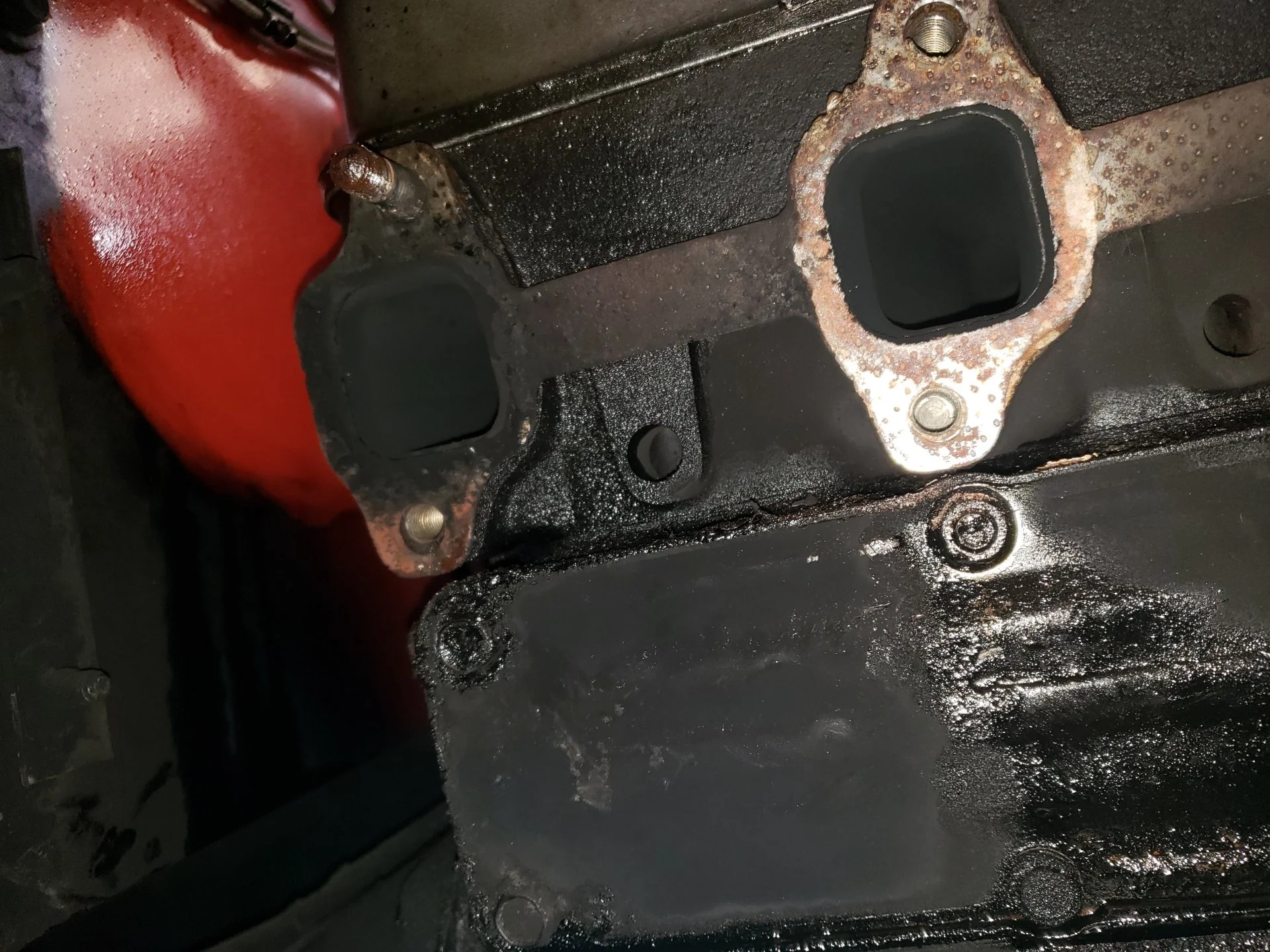

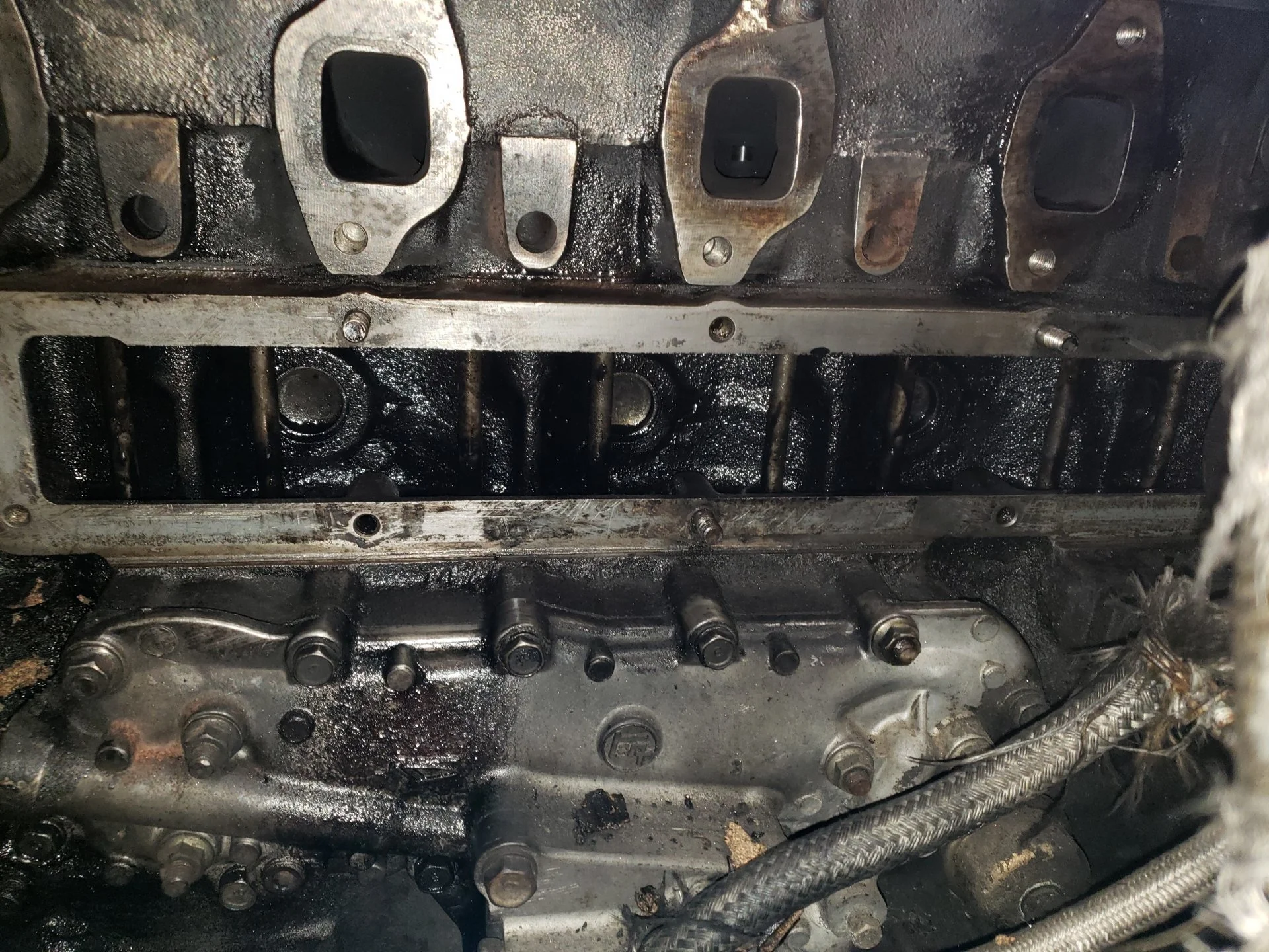

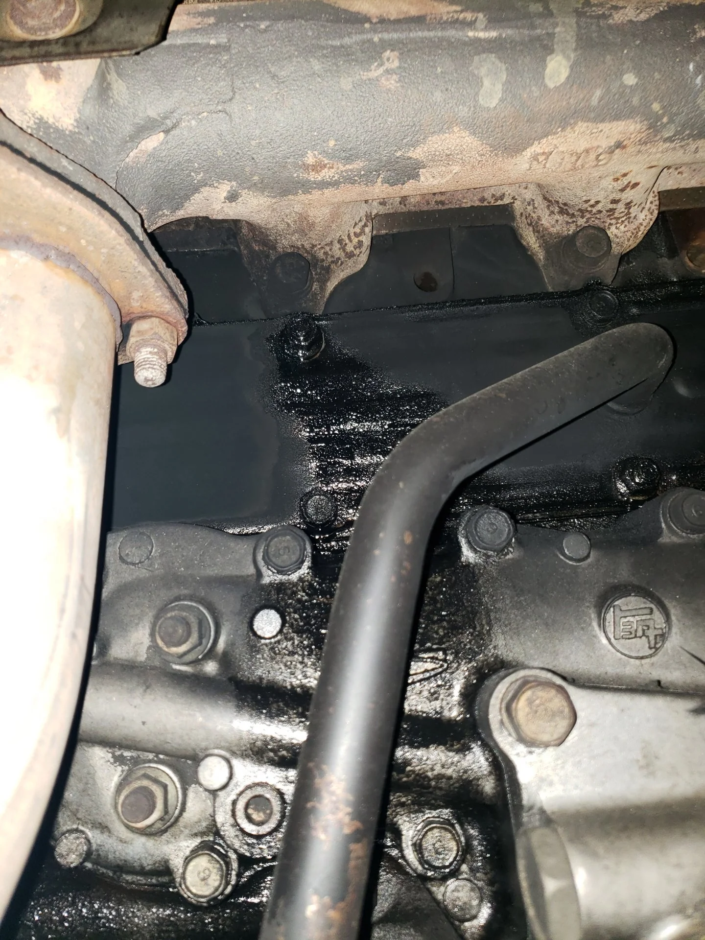

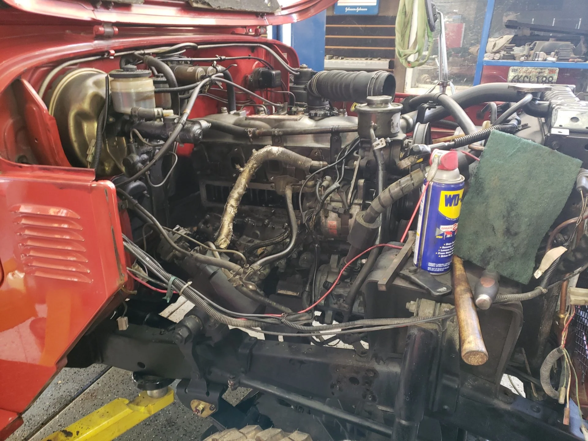

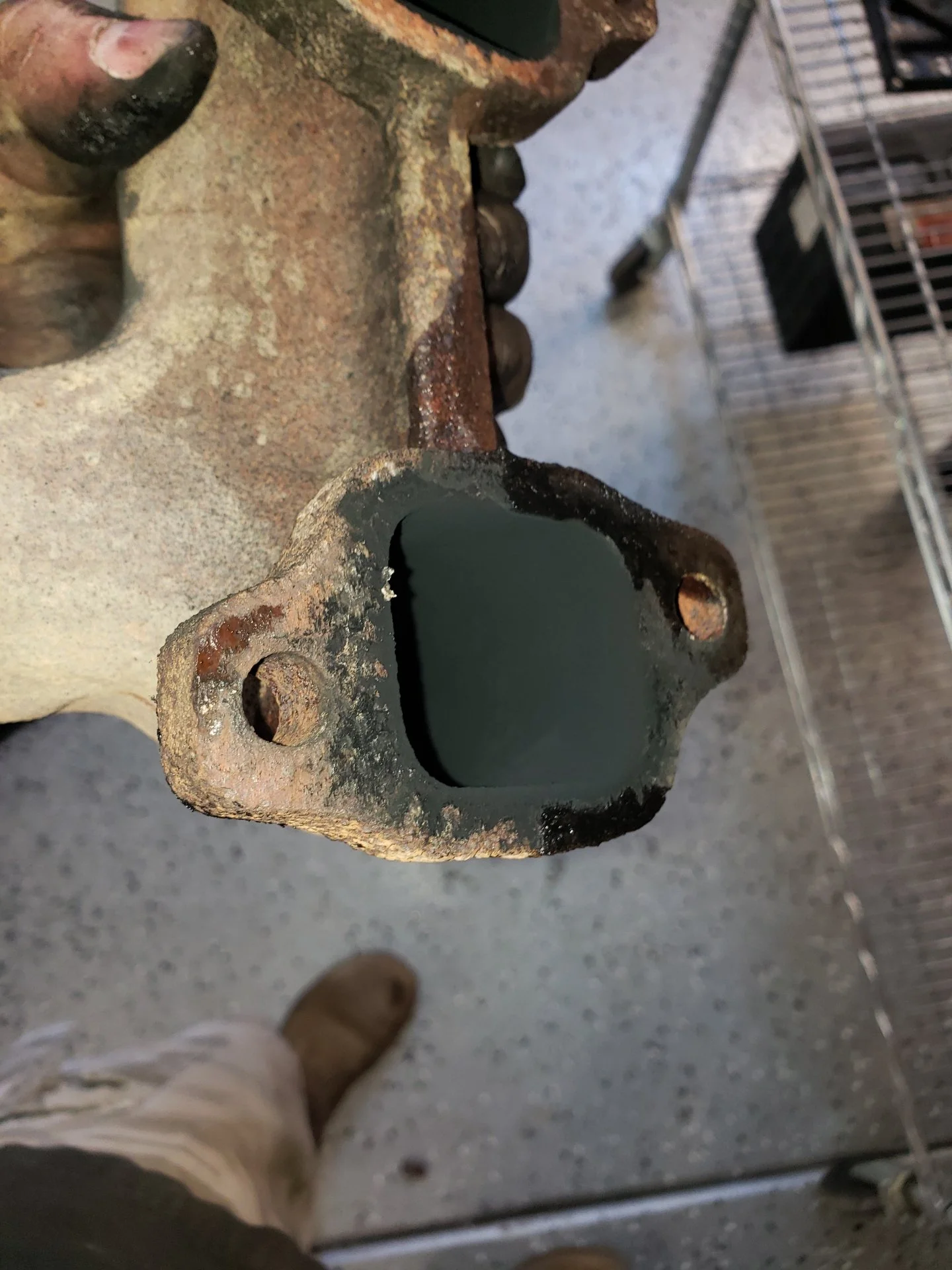

When I got the BJ46 it had an exhaust leak, of course it also had an invoice for new exhaust gasket, I see why people hate mecahnics when you read through the list of "work" they were charged for an compare it to the truck .
Luckily for me I was planning to pull the exhaust manifold anyway in search of more power, more noise and les fue economy :)
No damage found and being a 40 I had the pleasure of removeing the friont fender to make getting the new manifold and exhaust etc in all that much easier .

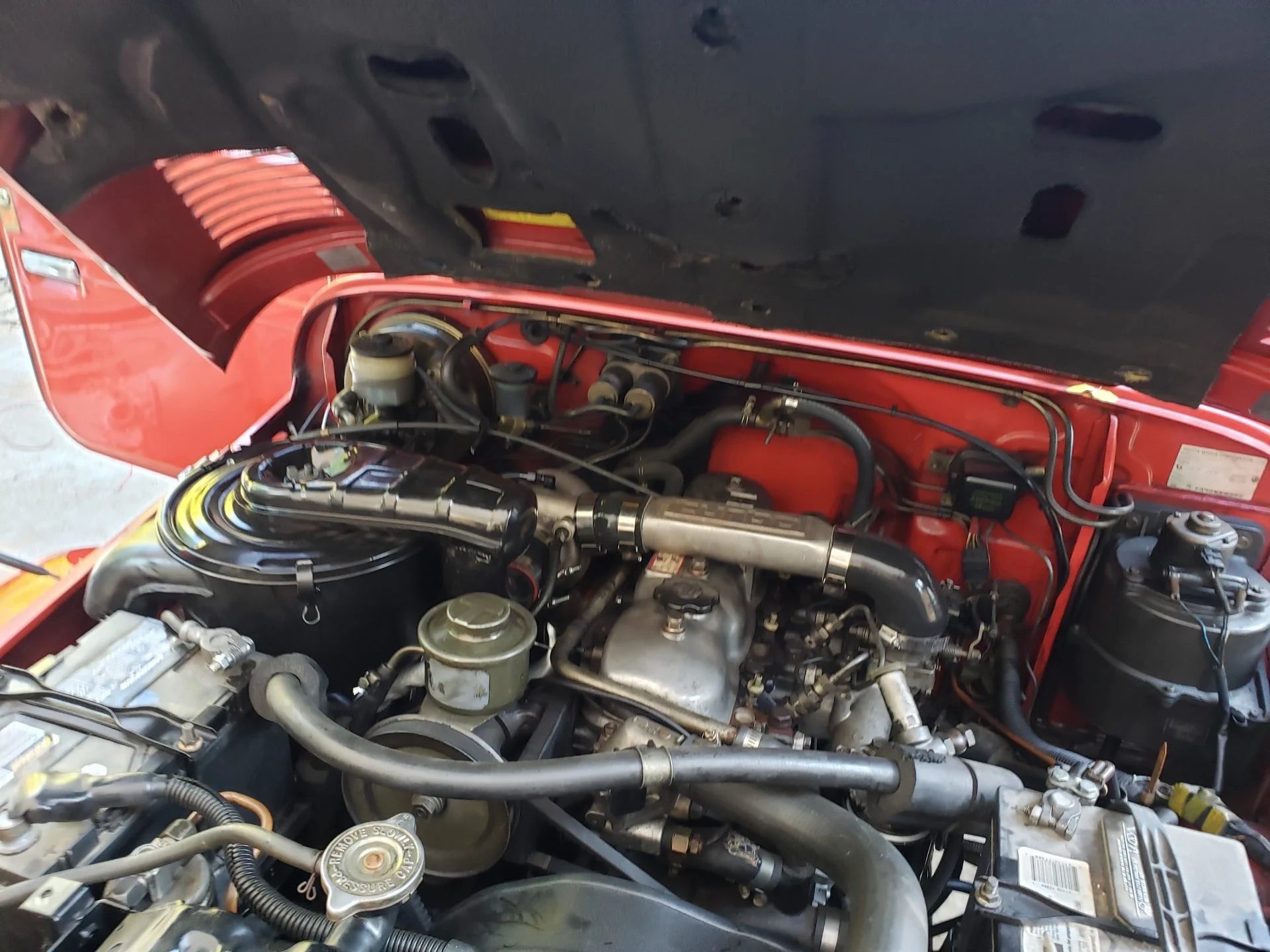

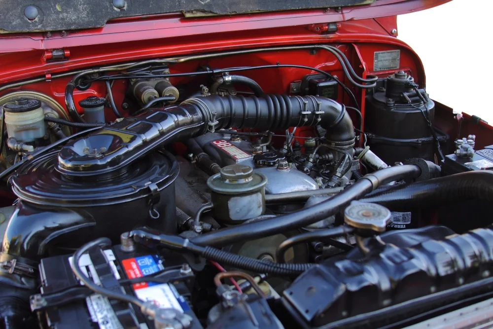

Doesnt seem to be a huge amount of interest so I will skip over the deatils and just cover the main points.
Bam, turbo on, air cleaner modified, every thing plumbed, pump adjusted 15 PSI
