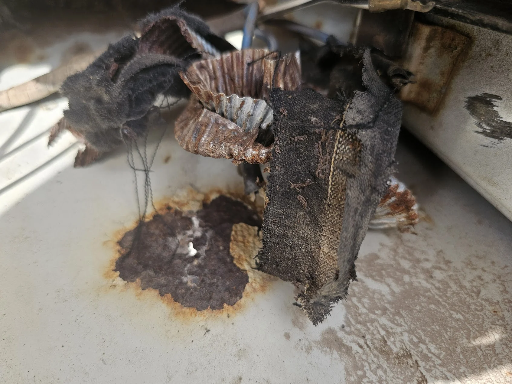

As you can see from the first picture the foam had all but deteriorated. The passenger side had similar foam but also a corrugated metal inner sleeve. This was bent and preventing me from sliding the window down further. The only way was to remove the inner sleeve. Needle nose plyers for the win, Just had to man-handle the metal until it finally was down far enough for me to take the window all the way down.

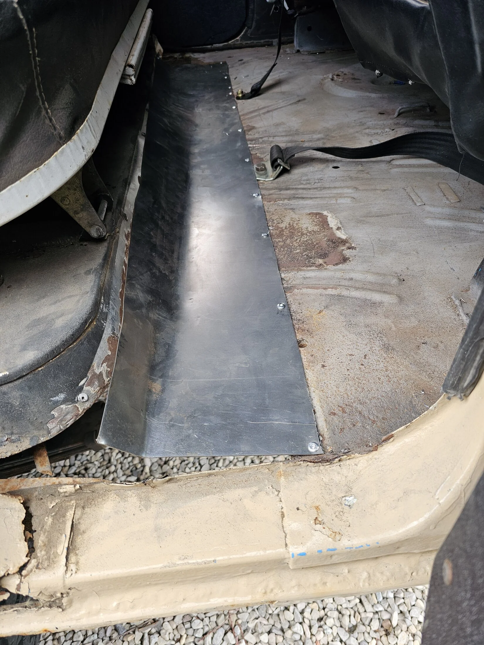

I decided to start getting rid of the built in trash cans and build out the floors in Old Man Tan. I didn't spring for the weld this time and decided to use rivots instead.
Right below the rear seat. Not done yet, drill bit broke and didn't have another one the right size.
