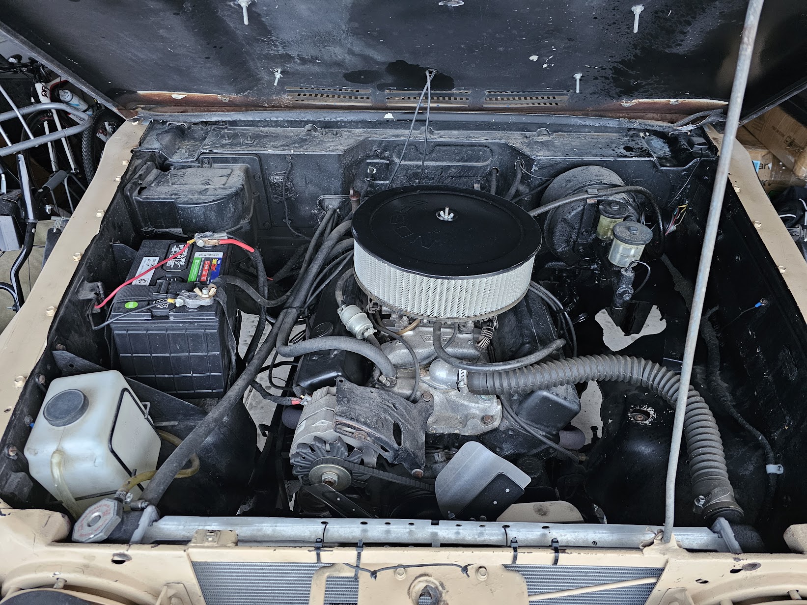

Engine:
350 GM Engine
Transmission: TH 350 3-speed transmission
Suspension: Lift Springs & Bilstein 5100s Shocks, 4 inch lift (at least that is what I was told, haven't actually measured)
Tires: 33 inch x 12.5 R 15
The night I brought it home.
Engine

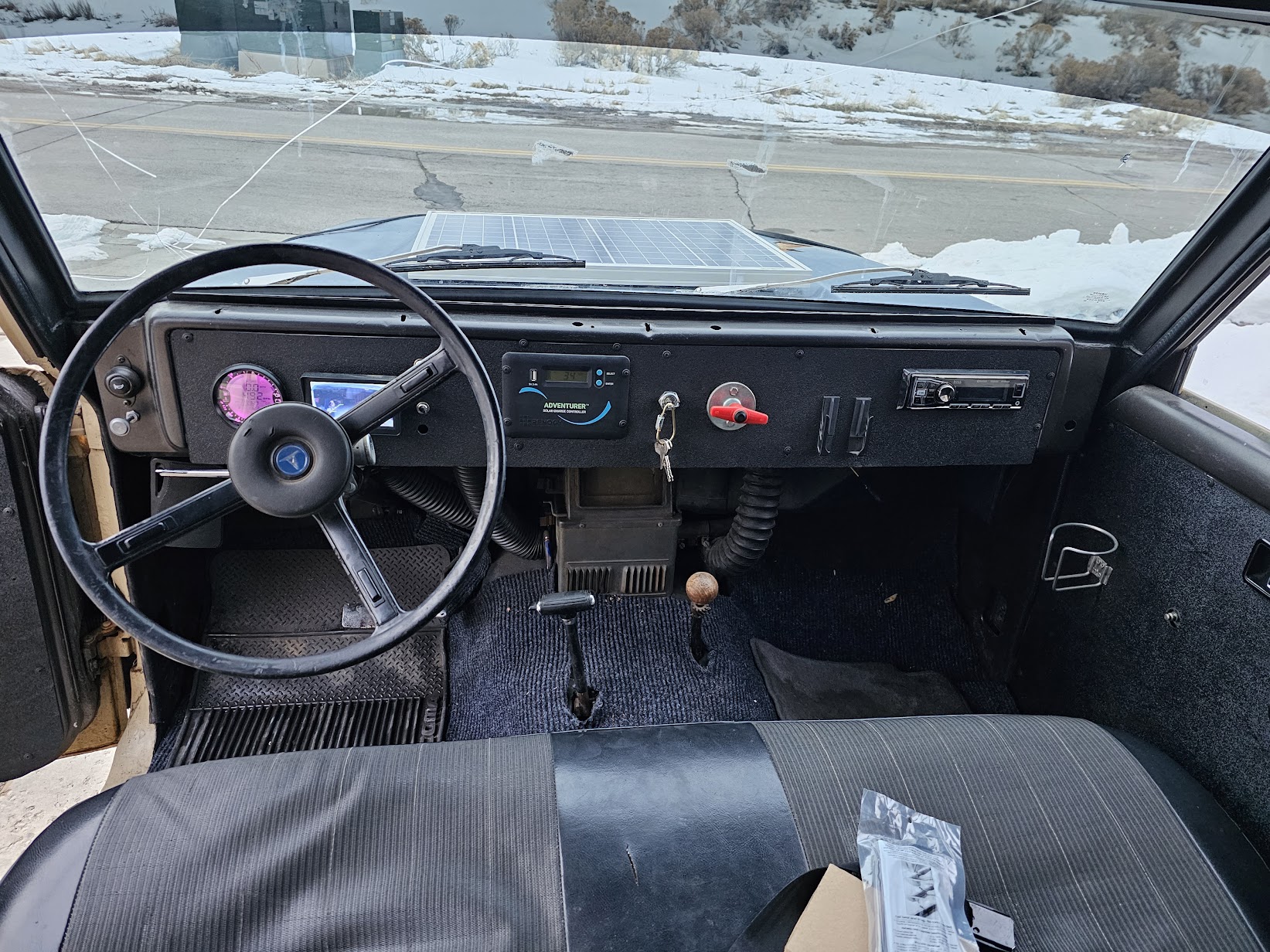

Front Dash

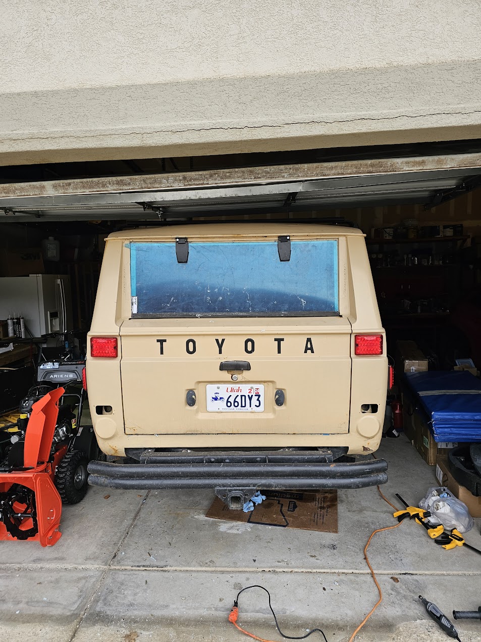

But tonight I finished up cutting out and installing a new acrylic window that will become a liftgate style. Have the gas struts, latch and weather stripping coming tomorrow. Glad to be able to see out the back now. Hoping to provide regular updates as I work on it.

more pics and info of the swing up rear window please!
I plan on finishing it up tomorrow or Sunday. I was out of town for a week for spring break, wouldn't have gotten anything done anyways as it snowed all week, glad I wasn't around for that.
Once I get it done I will post something
