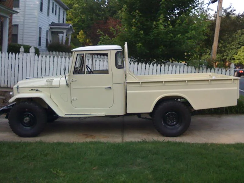

I was looking through Barry's thread on his LPB and found this picture - and noticed that the rear fender has a slight lip on it. Is that something that came on all FJ45 beds? Or was it an early thing? Is it something you tried to reproduce?

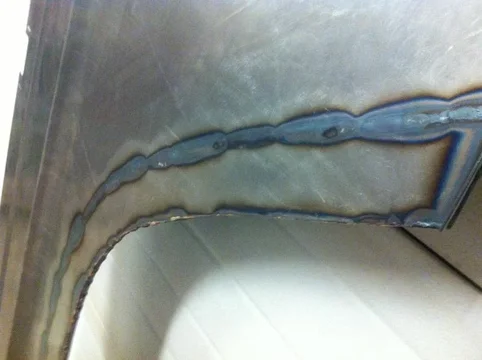

Yup, mine has the lip over the wheel arch if that's what you mean. My bed I show above does not have the lip because it was an earlier rendition. I am on the iphone but there are pictures in my old original thread of how I do it.
Still progressing and will be welding that lip this weekend on six sets. Hopefully late next week I will start assembling four beds.

Yes, silcon-bronze actually. Less heat required so less warping
