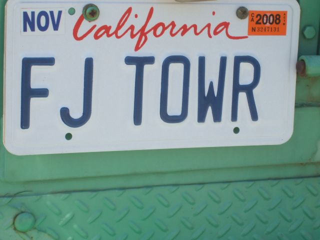

Dan pulled her into the paint shop across the street this morning. It's looking pretty cool, especially that personalized plate.

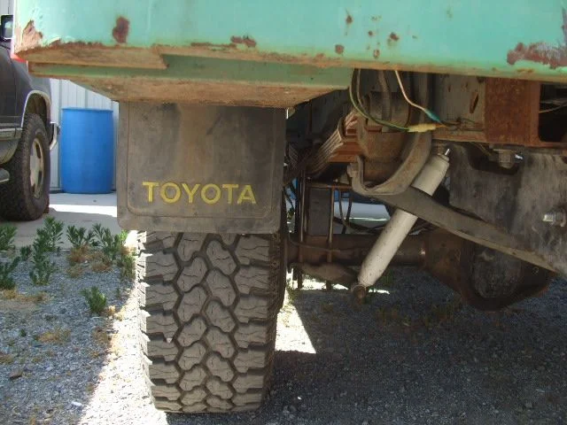

HOLY LIFT BLOCK BATMAN!!!! :hillbilly::hillbilly:
Your not worried about axle wrap with that large of a block? Maybe I missed something...?
Ok, figured there was something I wasnt thinking of.
What about having Alcan make a set of wicked heavy duty springs? Probably I nice chunk of change?
If you use good quality u-bolts, keep them torqued and stay away from gnarly burnouts with the GN attached you should be fine. I have 6" blocks on my Duramax as well as my brother Megacab and regularly pull 10k+ with no problems. VCast iron blocks are only a problem without proper torque on the u-bolts. How many lbs do you intend to pull with the GN?
