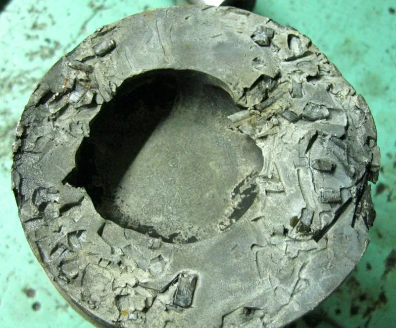

Nulla is getting an engine rebuild
last weekend the mystery of the tapping noise on my engine finally revealed itself, while driving back from a trip the tapping noise suddenly became very loud. the culprit is the #2 cylinder. i am told that this is the weakness of the 12ht engine at around 400km, the upper piston ring comes loose and find itself on top of the piston, which created the loud tapping noise as it hits against the cylinder head.
the good news is my engine will now get rebuild with an after market piston with a steal insert on top of the piston. i am told that this solve the weakness of these engine.
i broke down in Paso Robles, California and found a diesel shop who don't seem to be afraid of overhauling a 12ht. Paso Robles is in central coast of California best known for it wine. so that is the good news.
the bad news is we are still trying to figure out how much this is all gonna cost us? and trying to source out an overhaul kit, ouchs! :cheers:

How is the exhaust turbine ? Did part of the piston ring stay in the cylinder or did it go out the exhaust valve?
I think somepne sold a bunk engine and knew it. That doesn't happen overnight. Oh, well, spilt milk as they say....
I wonder what a rebuild will cost. For the same price, you could probably drop a brand new cummins 3.3 in it. But, the 12HT is a great motor no doubt.
we have not removed the piston yet so i don't know if there is any further damage, i check the compressor side of the turbine that seems to be fine. no excessive play.
i think everything including a rebuild engine will be between 5,000 to 6,000 dollars, that is taking it out of the rig, to the machine shop, overall kit, and the labor cost to put it all back together and get it running.
