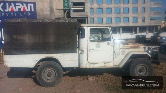

Will be paying a visit to the place sometime today, to see if it's worth the effort.
So...practicality (and being a family man) wins out, after all. Turns out, we WON'T be building a 45 pickup with 8 cylinders. And it won't be having four doors, either. But it will be having six wheels. :)

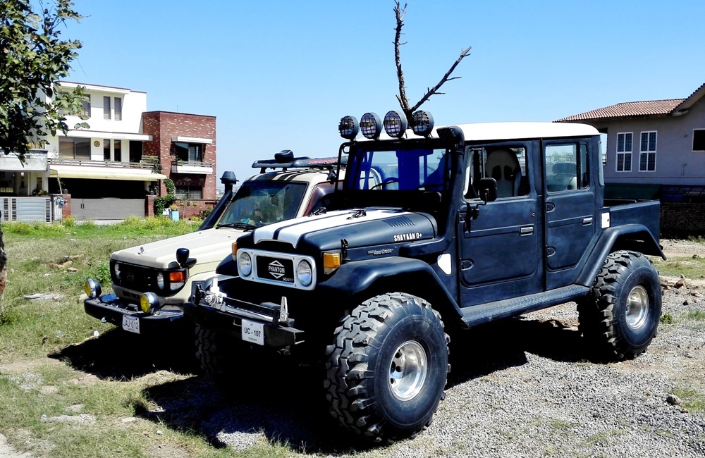

Been absent for a bit. Reason being I was busy with another build, which I was wondering would even be acceptable on 'Mud, or not. :)
Anyways...here goes. Meet Phantom's cousin, everyone.
Pegasus is the name of the handsome creature you see parked in front of Phantom. Some of the thoughts on THIS very page are being added to the truck's build. While the styling is very much 1942 Willys, this king-cabin and pickup combo isn't anything Willys ever built (to the best of my knowledge). Appearances are deceiving, though. The frame is that of a CJ, that's been extended to 80 series length (118 inches, rather than the 74 inches of the Willys). The suspension is Toyota: coil-sprung 4.88 lockable diffs front and rear that ride on 37 inch "tall-skinny" tyres. The planned powerplant is also a Toyota --- a 3UZ-FE VVTi V8 mated to a 6 speed Tiptronic, that will be coupled to a transfer case driving all wheels (2H, 4H, and 4L). And of course, every panel is being beaten out on the truck by hand, as you can see from the tailgate and bonnet. :)
Wolf in sheep's clothing? Maybe. We'll only be able to tell once it's eaten up a couple of Grand Cherokees. Fingers crossed! :)
